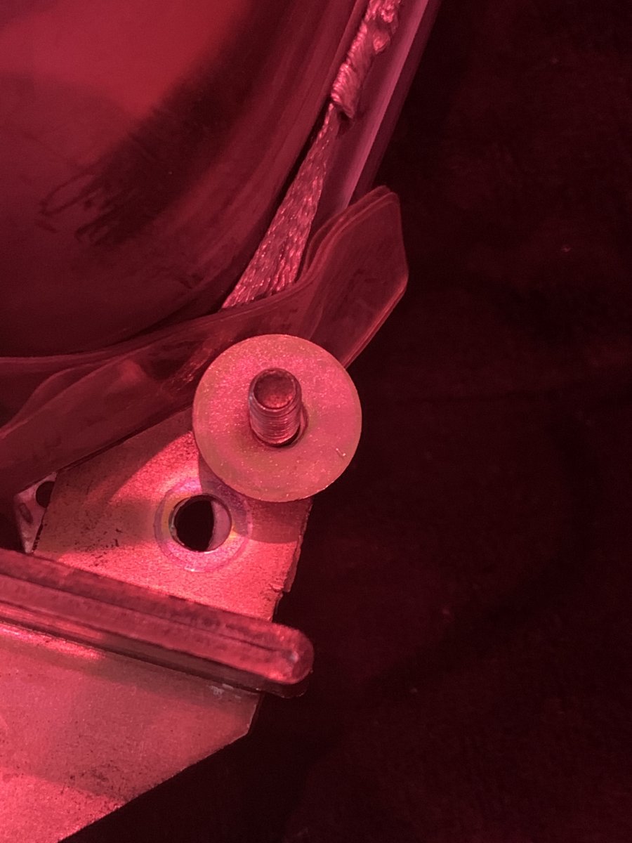

As shown in this picture, the holes on the mounting brackets don’t line up perfectly (the other side is screwed in in this picture).
So I’m thinking about going to Home Depot and picking up bolts that are just *slightly* thinner than these stock ones so that I can scoot the bracket over a little and bolt down all four holes.
Any advice? Is there a danger the new bolts might not be strong enough to secure the monitor?/how small can I go?
I don't see how that is possible. Have you screwed the other side down firm? If you have, loosen it and try realigning the frame around the dog ears.

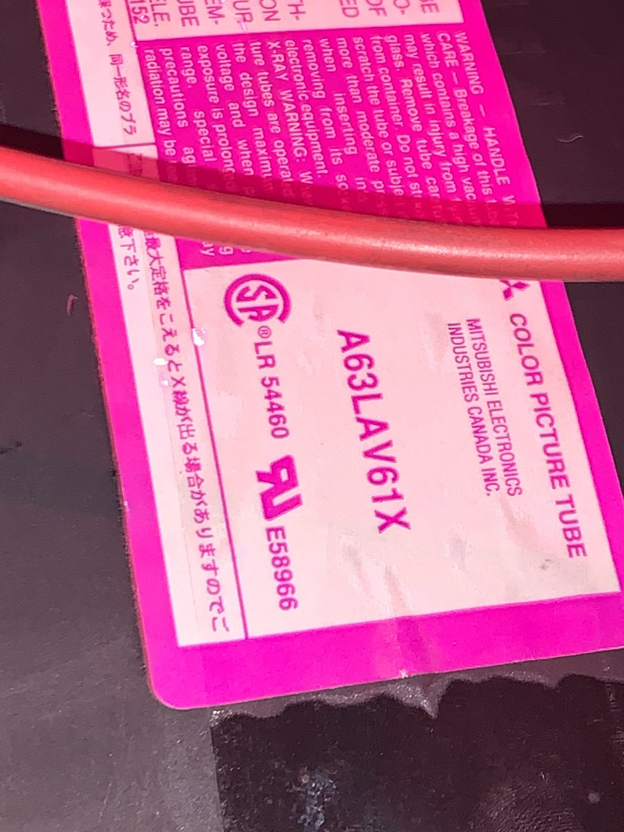

Just to double check, the tube is a Mitsubishi A63, right?
You probably haven’t put the frame on square, you are only a few mm’s out, I would loosen your bolts and have another go. It’s not as if the screen can fall out of a table, the weights all down on the 4 brackets.

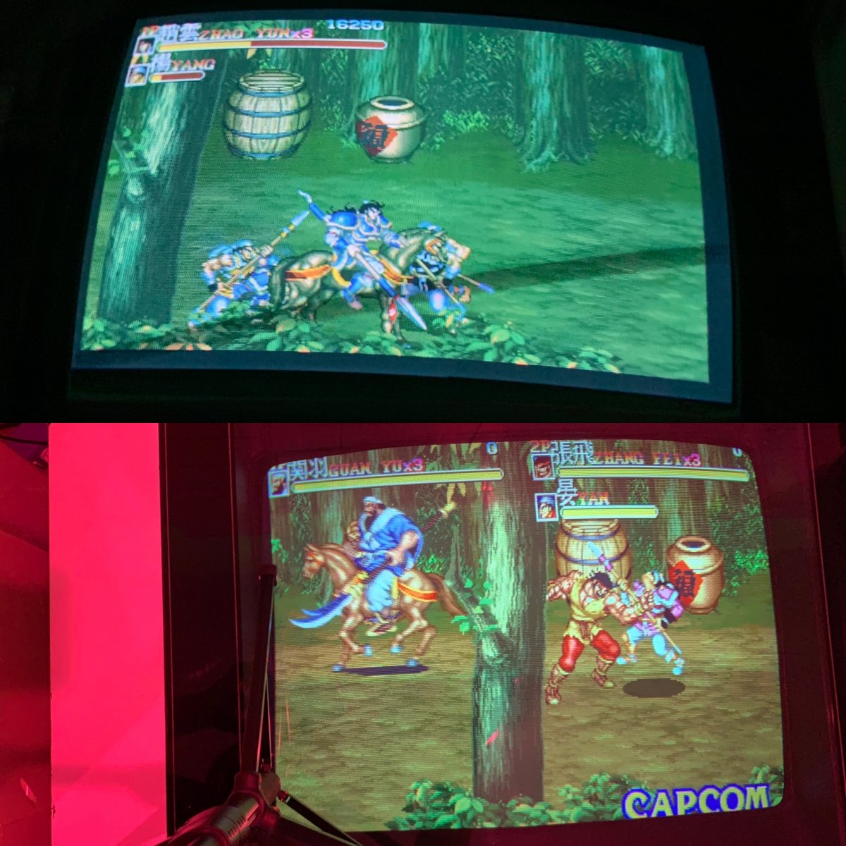

I got it in with three of the bolts and went to Home Depot to get one bolt that was a size smaller. It also just barely fit but did secure the last corner and the monitor has been sitting in my cab snug for the last couple of weeks, looking great.

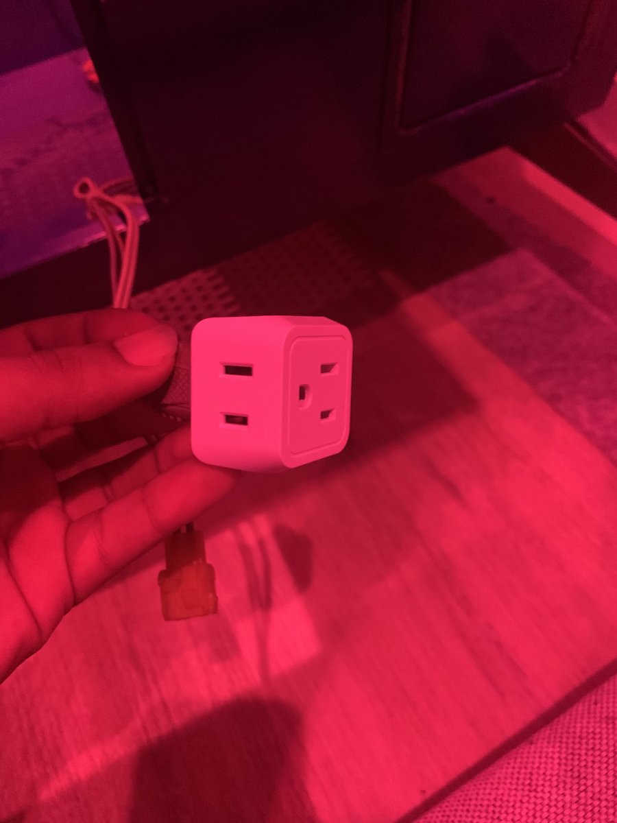

I had one follow up question which is about the light bar on a Sega Aerotable where it says “videogame”. I realized that the monitor plugs into a normal wall shaped outlet inside the cab.
It’s non-polarized and the cable the seller hooked up for me is polarized so I used a cube shaped adapter to get it plugged in. I’m wondering if I can use one of the extra sides of that adapter to plug in a small led light strip or a light bar where the wire would then creep up to a light tucked behind the “video game” sign. That way I could see the Aero table’s marque light up but not have to bother getting custom cables that mirror the original.
Would my monitor still draw enough power from the psu or would it be an issue that would effect the picture, the monitor’s lifespan, or the lifespan of the psu?
