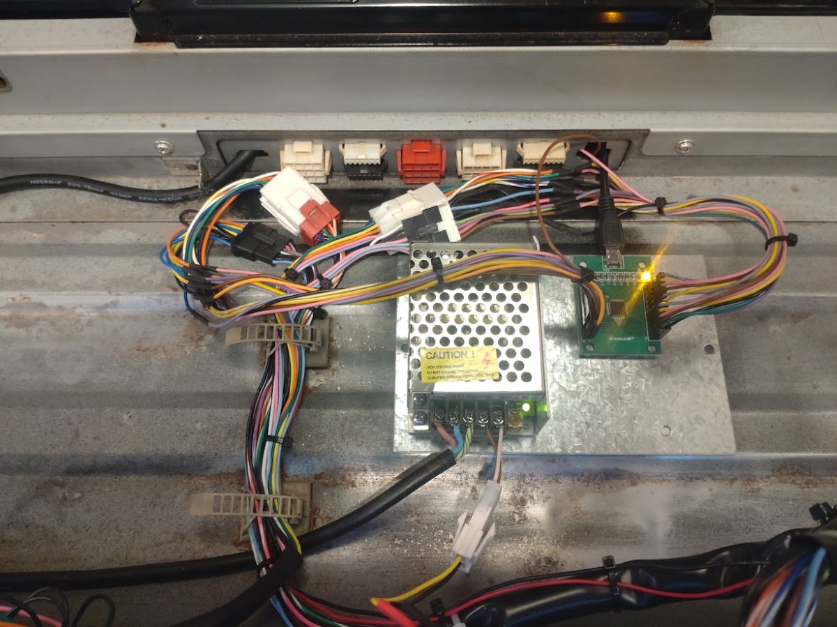

I still have a spare JVS-PAC 2 in a drawer waiting for the day when the new firmware comes for now I'm using:
http://www.xin-mo.com/dual_player.html
In my Noir but have everything on JST connectors for easy swap back to OEM.

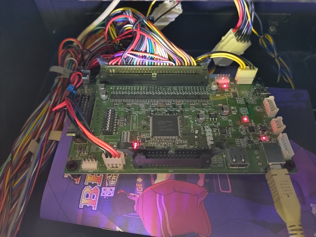

I got a Sega I/O Type 4 today but I can't get it to work maybe its not compatible with the JVS-PAC 2?
https://photos.app.goo.gl/8hcrpuTE7Sa9Gar6A
I've been told the "dips" may need changing.

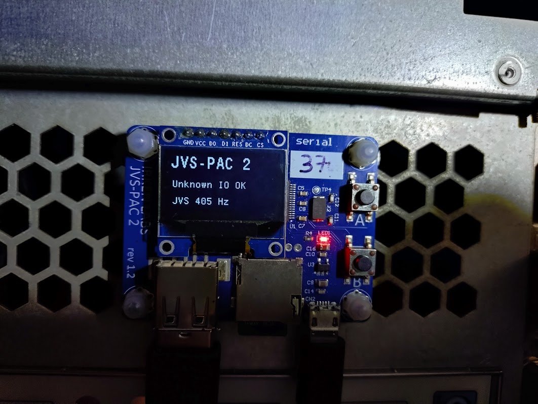

According to the OLED, things should be OK - just that it doesn't have the "signature" of the IO board you're using, that's just cosmetics.
If you start it with the file jvsdebug.txt, it will log all kinds of stuff. The normal error is using a usb cable without the datalines connected (stuff laying around from a powerbank etc), then everything will appear to be working - but not detected by computer.
I just swapped it over from my Type 3 I/O & the wiring was ok on that.
I've not tried again since but will over the long weekend.
