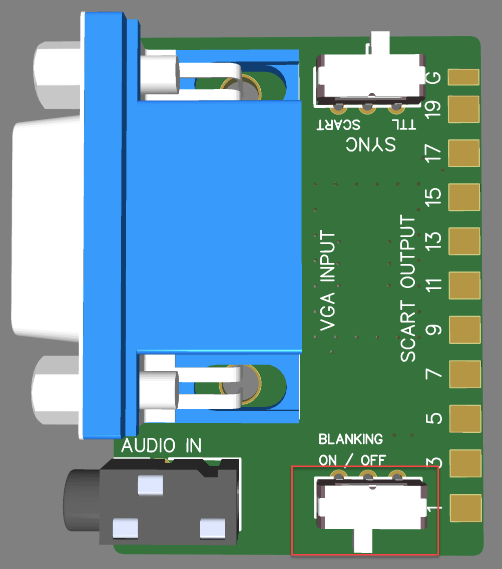

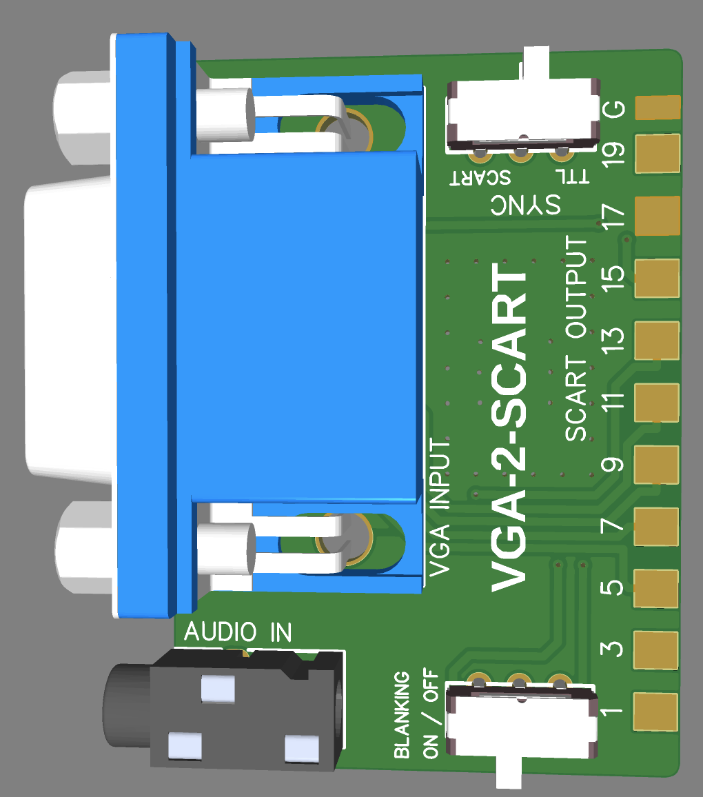

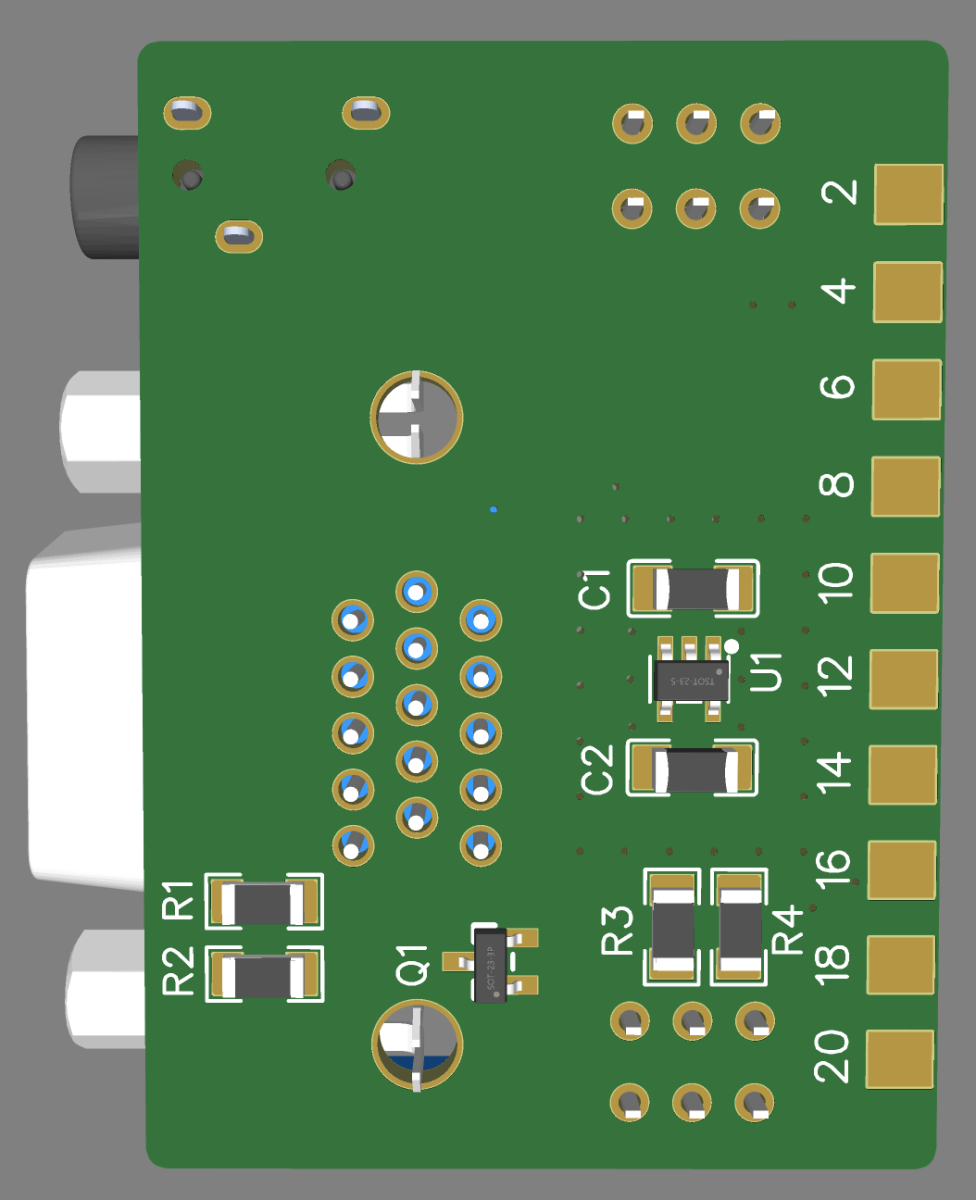

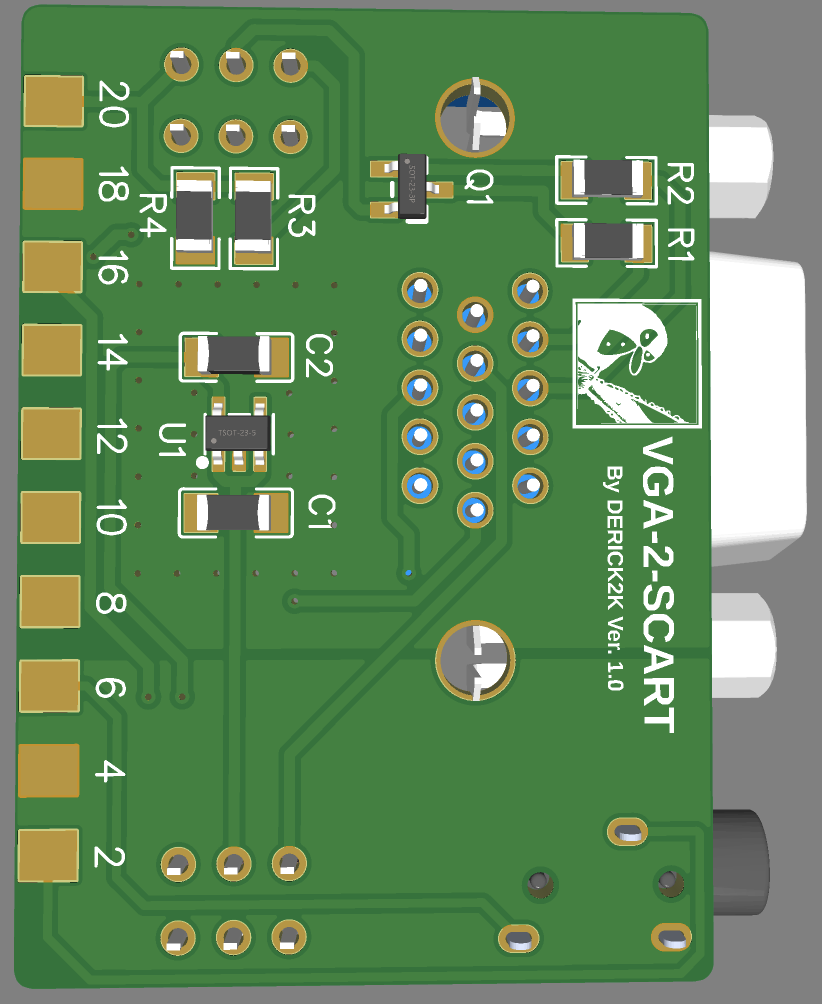

So decided to put together a VGA to Scart adapter.
Sync Combiner - TTL or Scart Safe
Display Impedance - 75 Ohm/High
Blanking Circuit runs off pin 9 on vga via an LDO (optional - not needed)
Audio In via 3.5mm jack
You can probably get these put together for about $4 from JLCPB with all smd components soldered.
If there is any interest I will post up the files for it.
Yessir! I have the connectors ready to and am brewing an order for several other PCB projects.
Cool, Ill double-check the spacing between the VGA dsub and the headphone jack to make sure there is enough clearance and post up the files.
If you dont need the blanking circuit you can omit these components

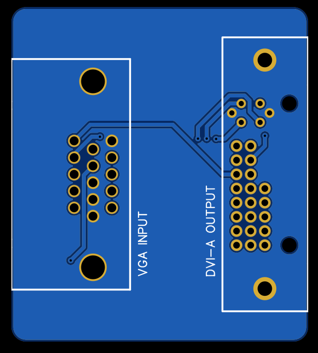

off topic... do you know if there is a VGA to DVI-A adapter?
I have a pinout for it that should work, but I have never tested it so...I would have to look up the specs.
But there should be some cheap adapters that already do this readily available I would think.

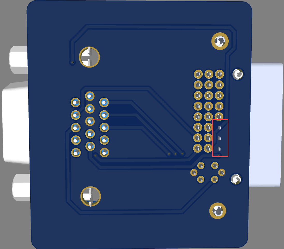

Here is a quick pcb for what you want
I attached the files, if you want to try it at your own risk since I haven't tested it :whistling:
You will have to cut off pins 22,23,24 from the dvi connector though.
Ok, Im happy with these, everything checks out. I will order a few to test it out, if anyone is interested in getting one let me know. They will be assembled, minus the scart connector.
Once its tested I will release the files so anyone can make them.

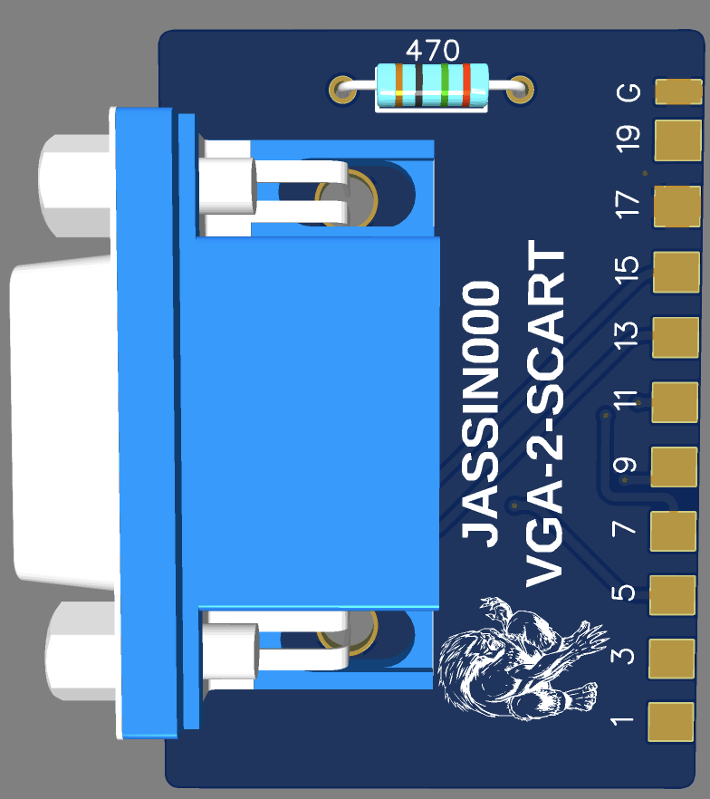

I'd like to give one of these a try with the Jammafier+Tri Sync Helper.
Reason being I want the low pass filtering of the SCART port on the OSSC, but I don't want to switch this (I have two) Jammafier over to a +Jassifier combo...
As this is the one I use for Taito F3, I just want a quick swap option in the form of a VGA cable outfitted with the adapter.
However because of my case use scenario, I'm only looking to adapt the VGA pins into SCART pins.
  • No Audio input needed (comes directly from Jammafier into cab amp or game board into cab amp).
  • No sync combiner needed (sync is already composited on pin 13).
  • No blanking (again everything is fine from the TSH, I only need the proper connector change).
Rather then tinker with your design, I'll just have it printed and solder in jumps to bypass all the component sections.

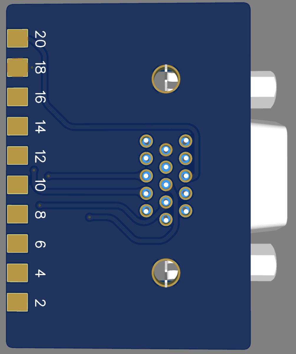

Here you go
Gerber
Schematic
Double-check if that's how you wanted it

I'm not 100% I understand, but be aware that the TSH outputs sync at TTL/5V levels, which the OSSC will not be happy to receive on the scart port.
Oh thanks Zim... I guess using D's OG design would have been better to populate the TTL/75 section.
Thanks for info brother, much appreciated, so for Jassin's case, he would need to add a 470ohm resistor on the sync line?!
