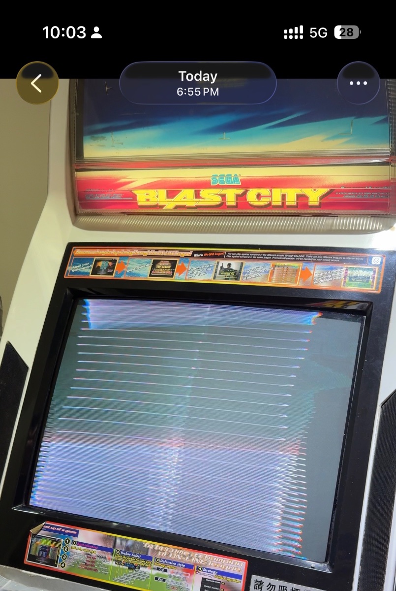

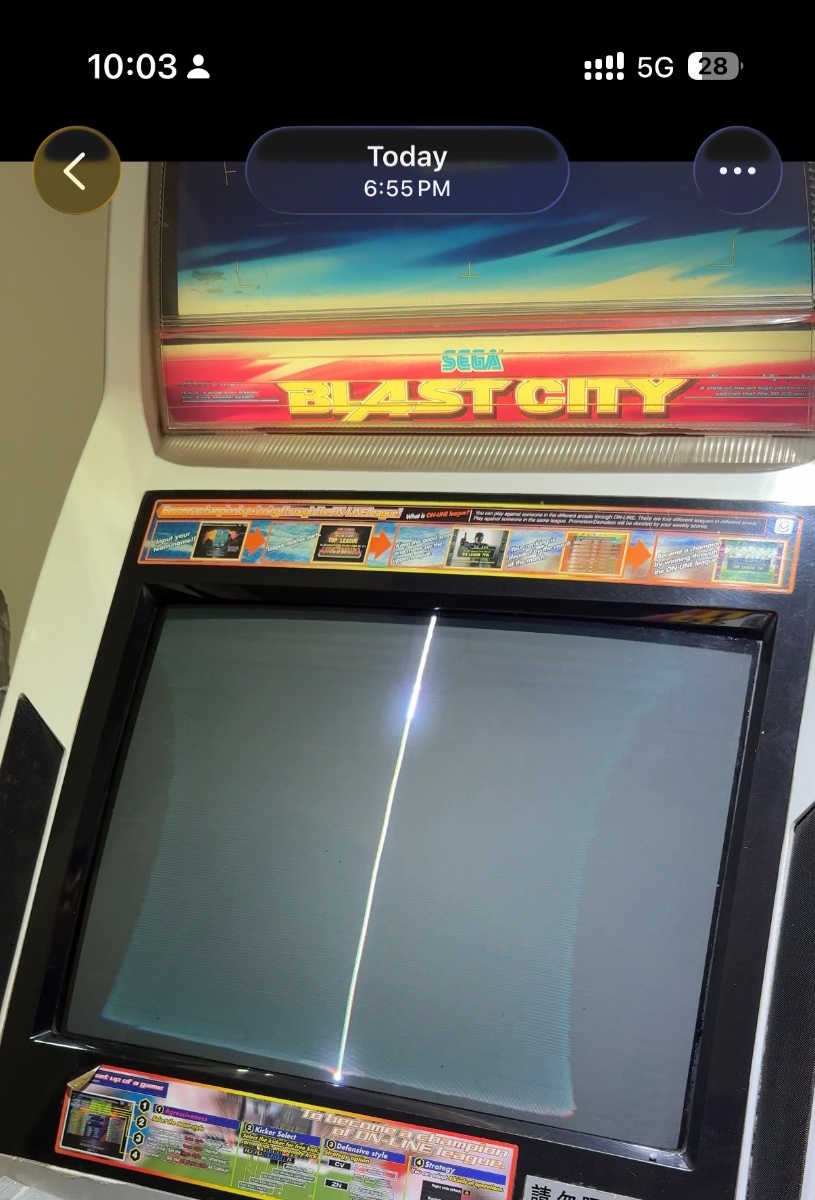

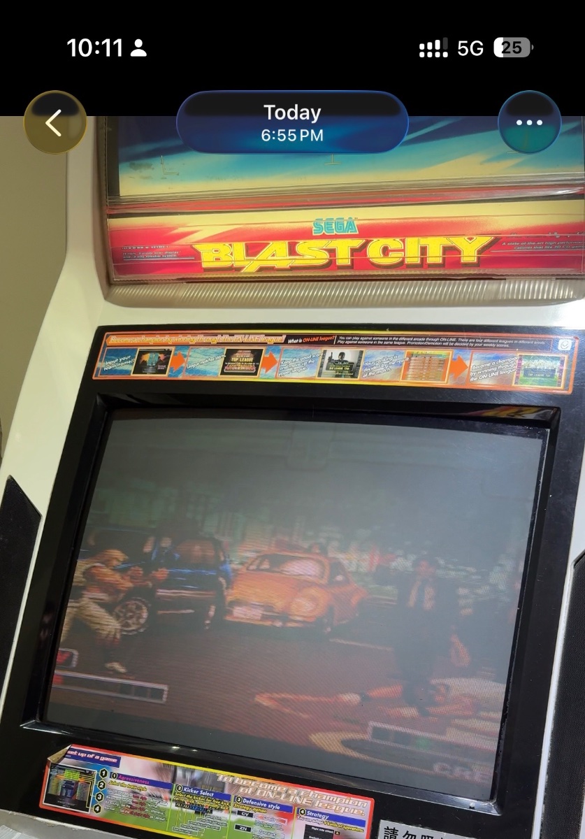

Hello guys, i need some kind help and advice, my Blast City cabinet’s original monitor failed, so I bought a Toshiba 9929 replacement. My friend swapped it in, but now it shows a blinking vertical line—the image briefly appears then collapses and blinks non-stop. its just seems like there is not enough power
Appreciate if anyone could advise, is the 9929 board incompatible with the Blast City cabinet?

Never seen anyone try the 9929 or other PF variant on a Blast tube before. Did someone advise you this worked or this was just an experiment?

@cma019 out of curiosity did you also swap the yoke.
I've heard rumors it might be possible.
But not with a chassis only.
Correct, the Blast stock monitor has a yoke that won't work with a PF.
Blast yoke is 0.200mH
PF is 0.300mH

Keep to the 293X chassis. Nothing wrong with them if they're serviced.
