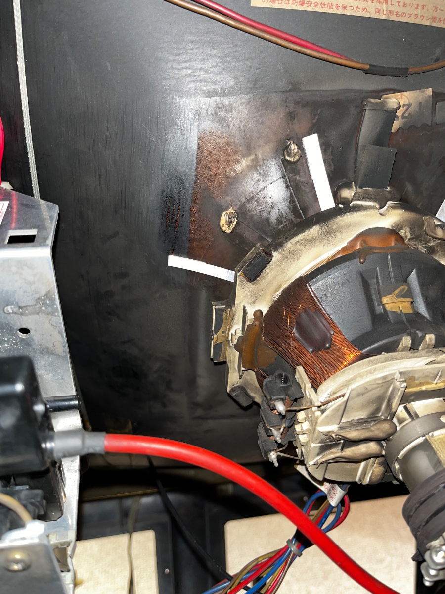

Hey AP community, I was applying some convergence strips to my MS9 and couldn't get one to stick because of what I thought was accumulated grime on the back of the tube. So I stupidly cleaned a small area with a few sprays of iso on paper towel, not realizing I might be rubbing off the aquadag coating.
I'm now wondering whether I've rubbed off some of the aquadag or whether this looks okay?

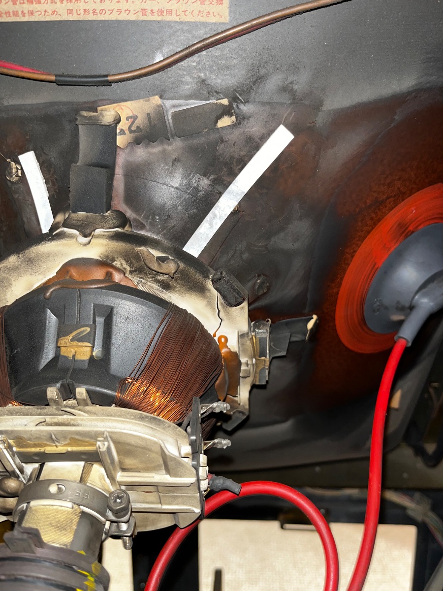

It's the left side of the tube that I cleaned, in the first photo. The right side, near the anode cap, is uncleaned, but I’ve included a photo of it for comparison. It looks like I might’ve scraped off some coating on the left side. Wondering if it’s a problem or okay? Feel like such a dummy!

There is usually a patch of glass near where the neck forms that does not have the conductive coating usually a square about the size of a small notebook. I would also say you are fine.
Thanks both! Appreciate the reassurance. Phew. Another chapter in the saga of me doing dumb shit with my cab without realizing… anything I should keep an eye or ear out for regardless while I’m using the cab in the coming weeks?
