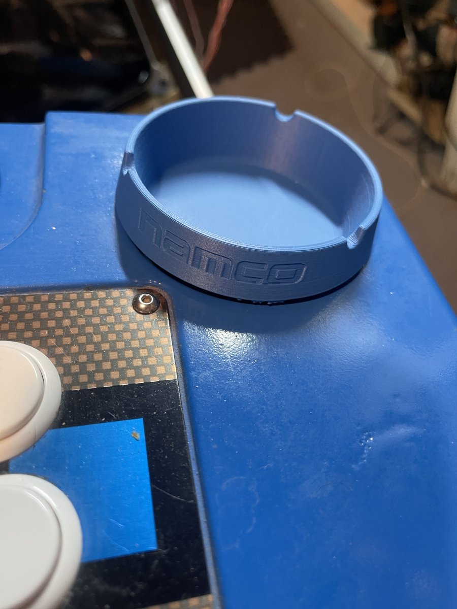

Here’s a plain one and a Namco logo one. These ones won’t stack on top of each other as the base is about 2mm too big in diameter. But they’re fine for general coin use. I don’t know anything about 3-D printing, but I believe you have to do something to create support for the overhanging upper part of the ashtray. Let me know how you all go with your prints.

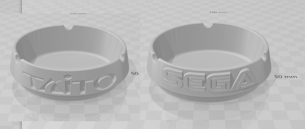

Ok we want SEGA!
They print nice and will do fine for me:
well I learned a few things in tinkercad today and ... voilà:
they are printing now ... will post the results and if ok will post the remixes!
That’s neat. Apparently there’s a trick to “wrapping” over the curvature of the ashtray but you look like you nailed it.

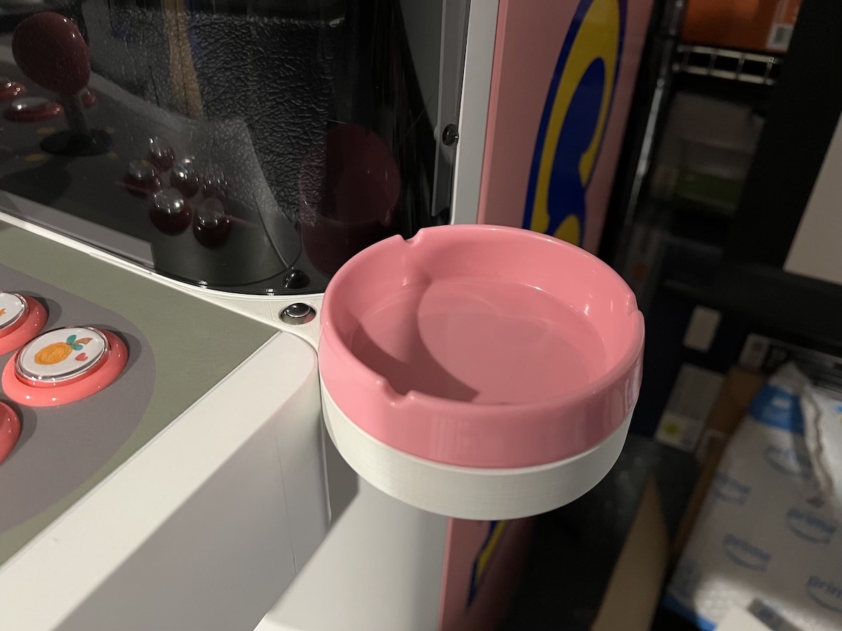

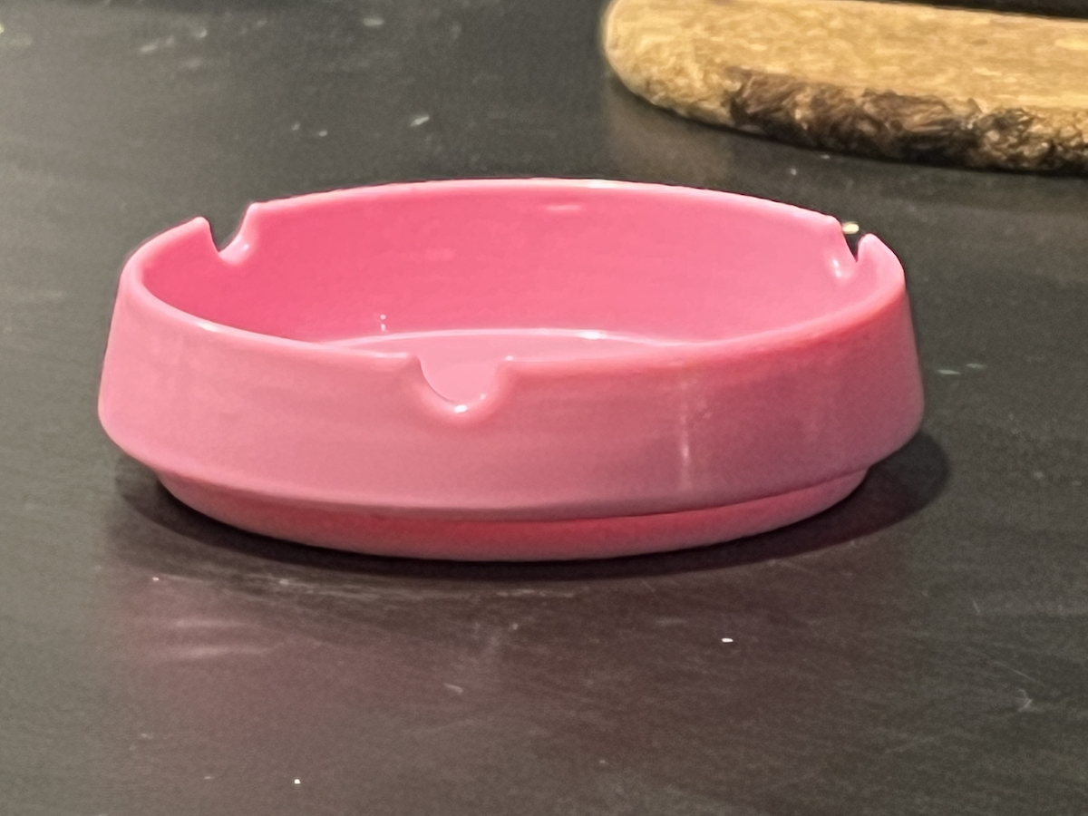

@Mrhide You ever print with ABS and try acetone vapor smoothing? I 3D printed these ashtrays, vapor smoothed them, and it totally eliminated any layer lines or other chararacteristically "3D printed" surface artifacts. With 100% infill they look and feel almost exactly like injection moulded plastic. Highly recommended.

That's why I like vapor smoothing as it's hands off and perfectly uniform. But you need to print with ABS which has its own learning curve.
