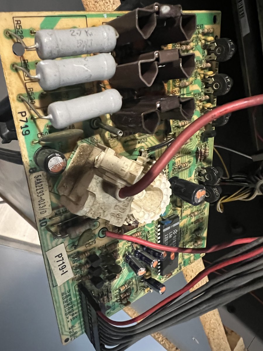

I am assuming the 3 transistors are the guys with the big heat sinks on them.
Edit - yep - P719 neckboard, Q503, Q504, Q505 - Sanyo 2Sc3782
What is the red stuff on the back of the board?

I'd recommend starting simple.
Confirm that the video connector to the chassis/wireing harness is good I've had two monitors in the past exhibit this behavior and it was nothing more than a bad crimp or bad solder joint on the video connector.
Also check the adjustment pots... they can and do go bad and can also exhibit similar behavior.
going over the board looking for bad solder joints and just reflowing anything that looks even remotely suspect is arguably worth doing, maybe a cap kit while you're at it.
Guns can go bad but it's best to go over the chassis completely before looking at the tube.
