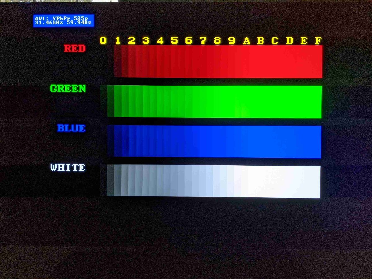

The Neo Geo 240P Test Suite doesn’t have the gamma problem that the SNES does.

I’m not sure what you mean by a MiSTer not being reliable, but neither MVS or CPS2 have the correct Rec 601 IRE test patterns for an accurate white level calibration with a colorimeter.
For generalized “eyeballing” it calibration without a colorimeter though then yes, those test patterns are fine.

Sure, as long as you can run an IRE pattern generator like the 240P Test Suite through emulation, and the emulator isn’t doing anything to post-process the pixels.

You can't do an accurate calibration with a colorimeter with any arcade PCB I know of because you need to be able to adjust the white level saturation being output by the board in 10% increments. But if you want to "eyeball" it and adjust without a colorimeter then the CPS2 system menu has a color saturation gauge.
EDIT: @XtraSmiley reminded me that the 240P Test Suite is available on Neo Geo now, so that would definitely be a good choice for an arcade PCB you can use for colorimeter calibration.

I’d forgotten that the 240P Test Suite is available on Neo Geo now. That’s definitely a good choice for an arcade PCB you can use for a calibration pattern generator. I’ll update my earlier post to @Crunch to mention it.
As far as each PCB looking different from the Neo Geo, well that would happen anyway even if you calibrated with a professional pattern generator - arcade boards weren’t consistent with each other even back when they were brand new. That’s why it’s a given that you’ll have to readjust the CRT H-Size, V-Size, Brightness, etc when you swap boards.

You can achieve the former by using the same 240P Test Suite across all your displays, ie pick one Neo Geo board or MiSTercade and always use that one for calibration. Your results won’t be industry professional spec, but the colors will look good and your cabs will look similar to each other.
For the latter, you need to use a pattern generator that has been specifically tuned and tested to meet the industry specification for accuracy. At the enthusiast level, the pattern generators I know where I know that’s been done are:
- PGenerator for Raspberry Pi
- MiSTer running HCFR
- Sony BDP-S350 Blu-Ray player with FreeCalRec601 discs
