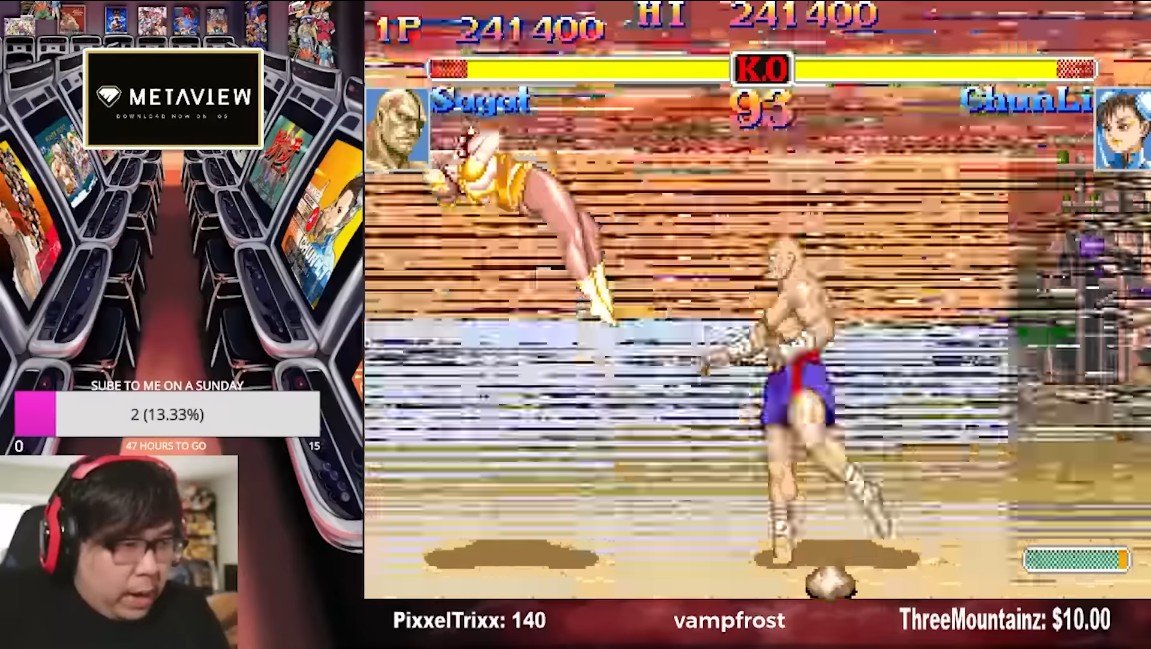

I get them on the Blanka stage. A thin horizontal line that's part of the background graphics occasionally gets brighter for a split second, and sometimes the entire background graphics glitch out for a split second. I saw the same thing happen in a YouTube video, but it was Super Street Fighter II: Turbo and it was on the Chun Li stage. You can see it in this video at 5:13 -

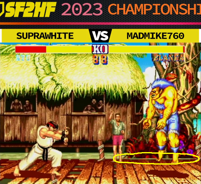

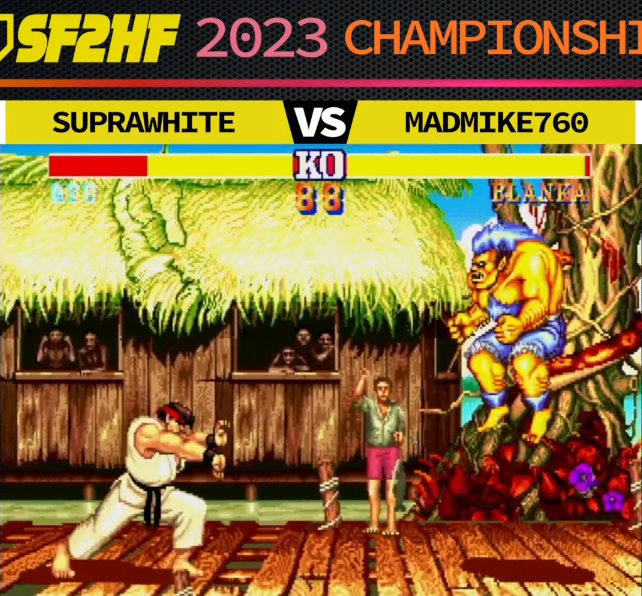

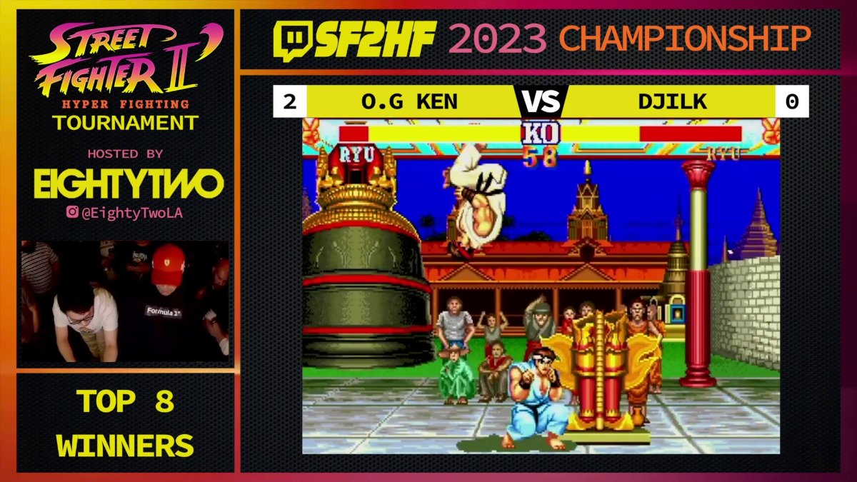

I found a video of Hyper Fighting on real hardware and at 10:18 I saw the same horizontal line glitch that I see on mine, so I'd say it's normal, unless both of our boardsets are broken in exactly the same way, which would be a huge coincidence:
View: https://youtu.be/HCF_gdk5oxI
It appears on this frame:
And disappears (goes back to normal) in the next frame:
I need to watch more of that video to see if the whole background ever glitches for one frame. With mine it doesn't do it every time I'm on the Blanka stage.

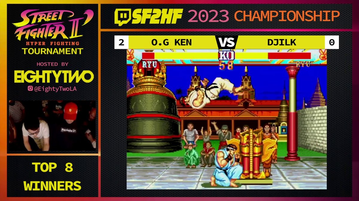

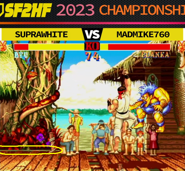

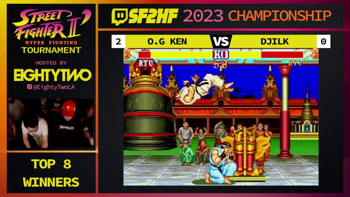

I've been playing this game quite a bit for the past few days, trying to beat it without continuing on the highest difficulty setting on the DIP switches, which I finally did last night (which is drastically harder to do than on TWW or CE), and the entire background still glitches for one frame from time to time, and I've discovered that it isn't limited to just the Blanka stage. I've seen it happen on various stages now. And with that in mind, I decided to watch that whole 2½-hour 2023 tournament video on the SF2HF channel again, which paid off, because I saw the same background glitch happen in that video on the M. Bison stage. Here are screenshots of 3 sequential frames:
The first screenshot is the frame before the glitch, the second is the glitch, and the third is the frame after the glitch. The glitch happens so fast (just 1 frame) that it looks like the whole background is getting corrupted, but what actually happens is: the whole background shifts to a different view for one frame. You can see what it looks like in motion in the video I linked to previously if you watch for a second or two starting at about 1:26:35.
I'd say that video confirms that both the horizontal line glitch on the Blanka stage and the entire background glitch on any stage are normal for Hyper Fighting, so I don't need to try to fix something that isn't broken.
