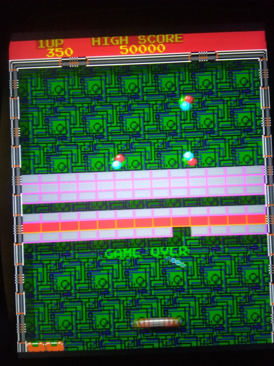

Arkanoid Colors Looking weird.

Caps and voltage likely wouldn't cause those kinds of issues. Most likely a graphics or pallet ROM, or some of the supporting logic.
There are 3 graphics chips (23, 24 and 25) and 3 color proms (IC22, IC23, and IC24) I'd start by dumping those and making sure they're good.
