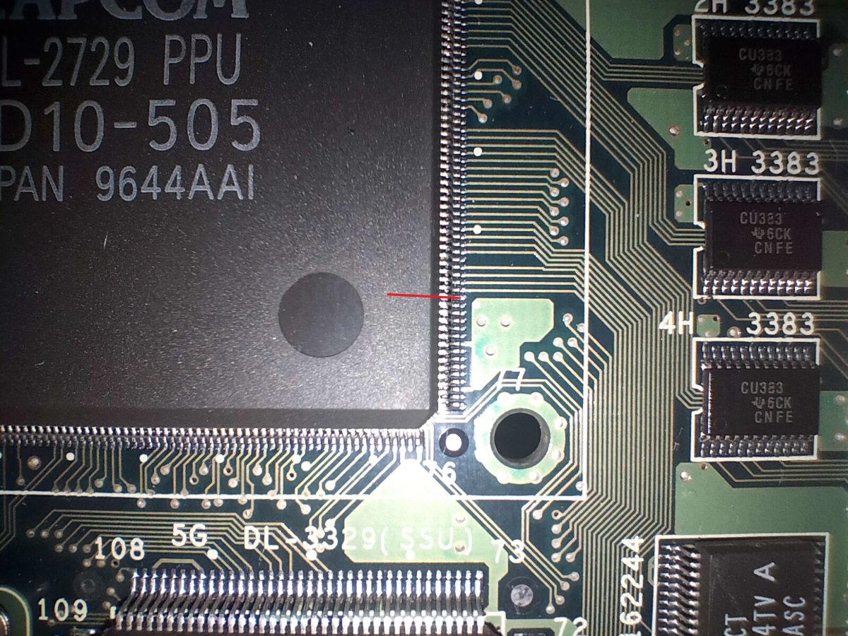

So I couldn't see any obvious logic chips on the board that would be dividing that crystal oscillator frequency (/3) so I surmised that it was being done by one of the custom chips. I soldered a piece of kynar wire to pin 8 of the exchange switch (PI5C3383Q, which as per above I said was the incoming 14Mhz clock) and probed the board until I found the other end of it .
Good news I found the other end.
Bad news it is coming from the PPU, Pin 91.
So knowing that I would check for continuity between those pins with the board off (pin 8 PI5C3383Q and pin 91 PPU), if it's good then that rules out a broken trace (if the trace is indeed broken check for activity direct at the PPU chances are it will be active and then just run a repair wire and retest). Then fire up the board and check for activity with the logic probe at either pin 8 of exchange IC or at PPU 91 whichever you find easiest, obviously a scope would be better but any activity is going to be better than what you have so far.
If there is activity then investigate the exchange IC more (as per the above post, supply, enable signal etc), if there is no activity then the issue is PPU related whether that be a lack of input clock to the PPU or a defective PPU I have no idea at this time i've not looked any further.

Managed to test some things tonight.
On the quiet board
- There is continuity between the 6D exchange switch pin 8 to PPU pin 91
- Pin 1 = Hi
- Pin 8 = just flashes (same as pin 91 on the ppu)
- Pin 9 = Lo
- Pin 10 = nothing
- Pin 11 = Lo
- Pin 12 = Lo
- Pin 13 = Lo
- Pin 24 = Hi
I guess the next real step is to change the exchange switch?
On the quiet board
- Pin 1 = Hi
Pin 1 being Hi is a problem
Pin 1 Low, Pin 13 Low = B1 > D1
Pin 1 Low, Pin 13 High = A1 > D1
I didn't mention it before but from the data sheet there is a third state on the truth table ( I didn't mention it as I didn't think it was the issue, my bad).
Pin 1 High, Pin 13 in any state = OFF, high impedance between input & output pins
So if the exchange switch is in that state a quick and dirty test to get audio working would be short pins 8 & 9 which will effectively put the clock signal to your DAC (since you have now confirmed there is a signal there and it's connected to the PPU).
The real issue now though is to find out why is that switch 'turned off', Pin 1 Bus enable needs to be low and something is holding that pin high.

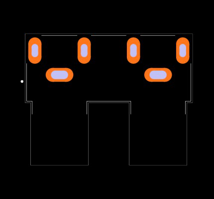

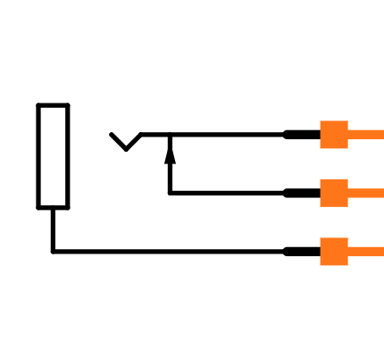

The only thing I can think of is maybe check for continuity on the rca metal parts to the corresponding pin at the bottom
Hi! :)!
Problem solved :thumbup:
I was fooled like a beginner X/
Looking at the motherboard that I have from a friend, I noticed the back of its original RCA connector with a central pin.
I'm telling you this because for a question of aesthetics I put a new connector which is not wired like the original one.
I put this connector there, look at his footprint but what a cockroach I am X/:thumbdown:
I put the original one back and I have the sound on RCA output :thumbup:
PJRAN2X1U01AUX​

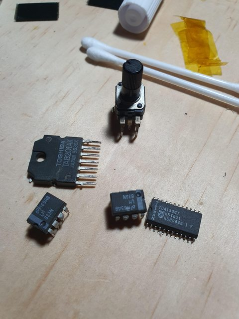

With advice/help from @xodaraP and @cruzlink2, I've managed to do the following:
  • Changed cart (I ordered these ones as they had a metal brackets and not plastic like the original ones - the plastic was the reason the originals broke for me. The plastic mounts can be found on this link)
  • Changed the Sound Amp, Toshiba TA8201AK IC; no change
  • Confirmed the sound amp was receiving voltage; confirmed with 12v with red probe on pin 6 and black probe on pin 4
  • Changed the volume pot; no change
  • Checked to see if it was isolated to jamma edge, changed to external in the settings and sent to external speakers; no change.
  • Checked to see if there's continuity between GND and 12v; no continuity
  • Replaced the LM833N chips; no change
  • Checked the DAC for data, ws, bck and confirmed there's continuity on the resistor array RN3 (pin 6 = dat, pin 5 = ws, pin 4 = bck)
  • Checked the voltages on the DAC based on the following schematic
  1. Pin 1 = 4.95v
  2. Pin 10 = 4.95v
  3. Pin 22 = 2.85v
  4. Pin 23 = 4.95v
  • Removed the DAC and confirmed every pin had continuity to the next point
  • Replaced the DAC; no change
Everything that's been replaced lol
At this point, I am completely out of ideas and I believe I've done pretty much everything I'm capable of doing. My knowledge of PCB repair or the CPS3 is very limited, I don't have a logic probe, oscilloscope to further do any more troubleshooting, so I'm really now at the hope someone else has experienced a very similar issue and was able to fix by changing a part. TIA

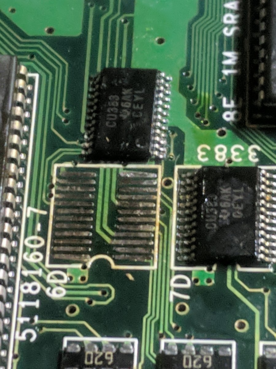

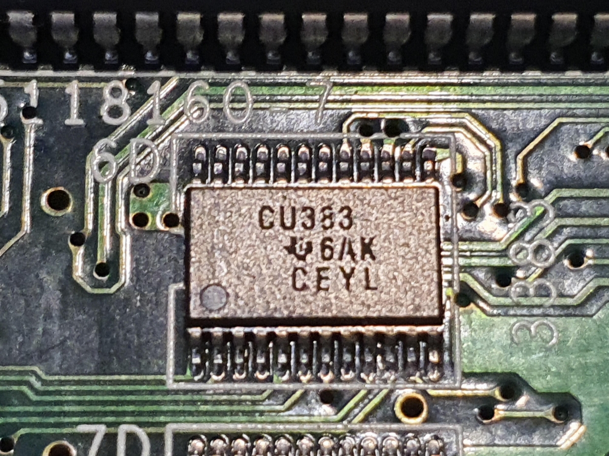

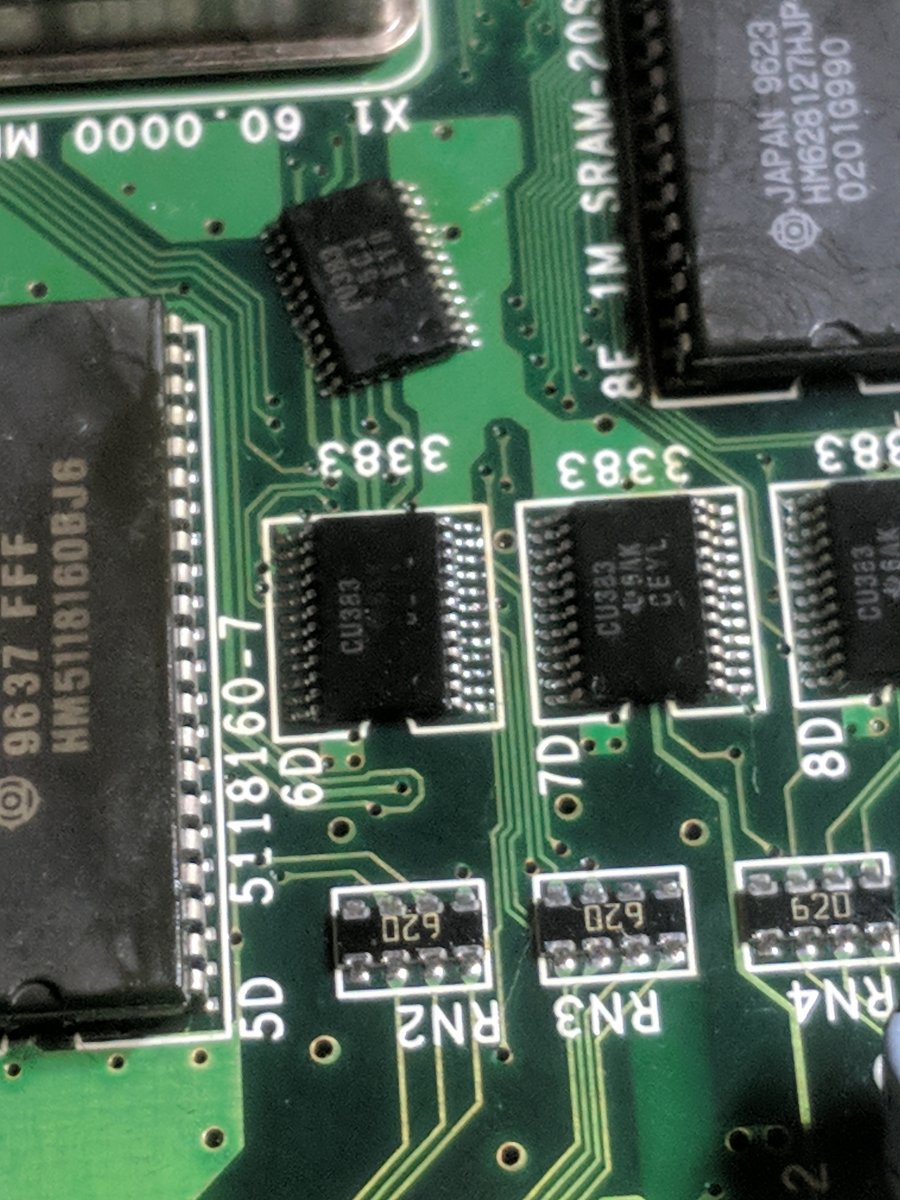

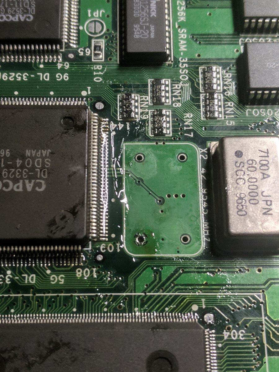

Now I got this board now and I did find continuity from 91 of the ppu to pin 8 of the bus exchange 6d but I got no activity with the probe. I got a feeling the ppu is the issue, I swapped the SSU and also swapped out 6d bus exchange and no difference. Now I do have a parts board which is missing the CCU and the input output custom but the ppu does give me activity on pin 91. I was thinking of going on ahead and swap ppu but before that I got a question. Would it be possible to get an 14.32mhz oscillator and have that drive the DAC and bypass the ppu?
Well I had the idea got this board from @mR_CaESaR along with two other non working parts boards. I ended up checking the one parts board that was missing the CCU and IOU customs and it had the sysclock on pin 91 on the PPU so I used it as a donor. I honestly wanted to try the using a separate 14.32hmz oscillator to feed the pin 8 of the 6D bus exchange and in term the DAC but I felt cute tonight so I decided to go for a PPU transplant. Happy to say it worked.
