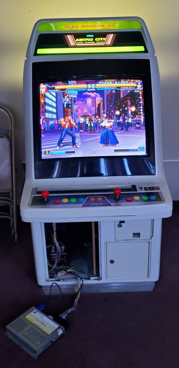

The one thing I did notice about the Toshiba perfect flat in the MS9 tube is that the focus could be better. The PFX is razor sharp though. Here is my Toshiba PF chassis (PB-9929) running on a MS9 tube inside an Astro City. As you can see, it is running 31khz on KOF 2002 UM on the Y2 board.
