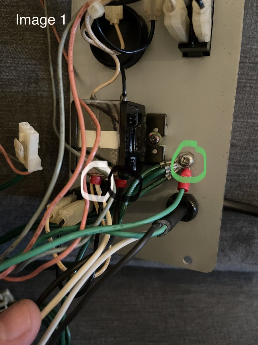

Image 1 - Replaced the original 2 prong plug with a 3 prong grounded one. Green circle indicates where ground wire was wired to, Black circle for Live and White circle for neutral

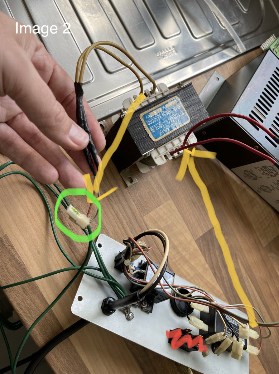

Image 2 - Ignoring the fact that the live and neutral wires aren’t connected to the power switch/noise filter in the image (they are, but weren’t when I took the picture!), I’ve noticed that it’s going through some sort of transformer, before reaching the 3 pin JST connector which ultimately plugs into the AC in socket on the power supply

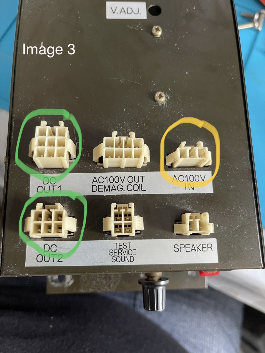

Image 3 - Yellow circle indicates where I’ve plugged the JST into the power supply and green circles indicate where I’ve been testing with my multimeter

  1. Does my new plug wiring look correct?

Recapped the power supply and still dead.
Removed the transformer and…it’s alive!
Still need to make sure I don’t actually need it though - think it’s some form of monitor isolation transformer. I’m swapping out the monitor that’s in it for a MS9-29A, so hoping it’ll be ok without it
I guess you got your Astro from China? The transformer is a 220V to 110V stepdown. If you already use an external one, it needs to be disconnected.
MS9s do not need an isolation transformer.
So yeah, you're good to go.

Not sure - came from someone else in the UK, who had imported it years ago with the intention of restoring, but never got round to it. So yeah, could have been China! - wouldn’t make any sense to have had that in place for Japan….

had this same problem in one of my astros,
bypassed the 220 to 110 converter and it fired right up
