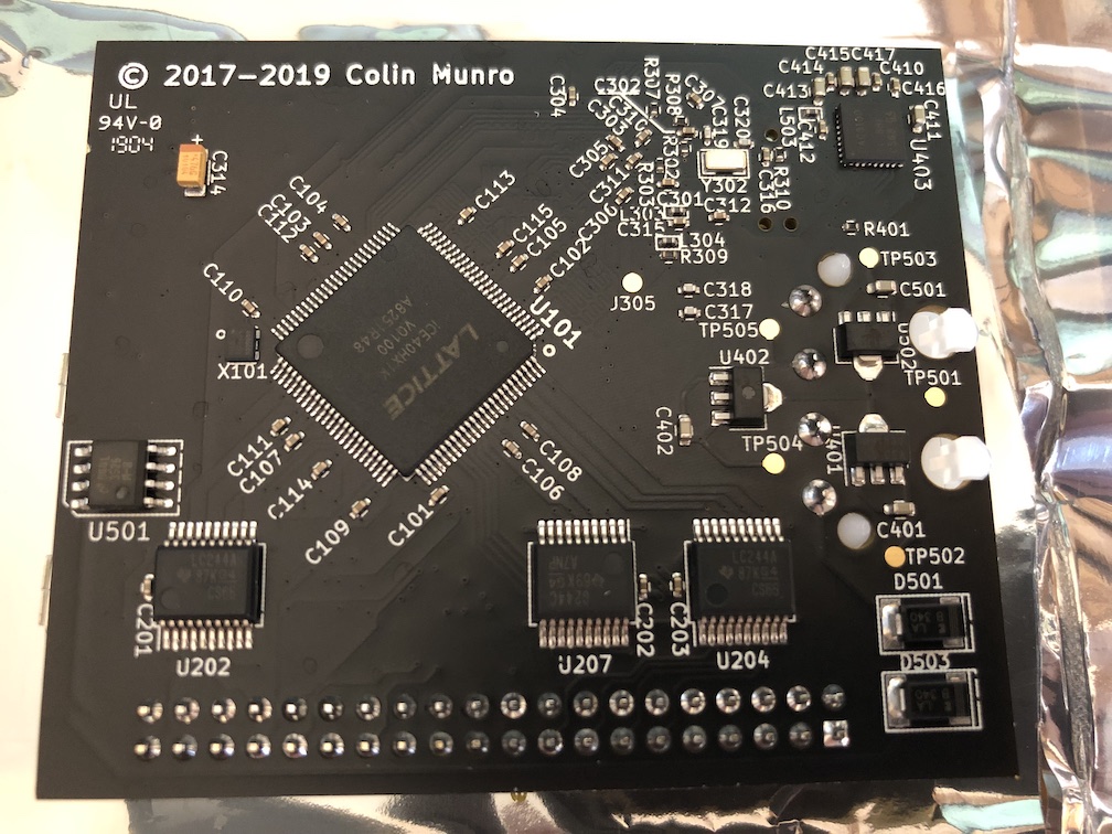

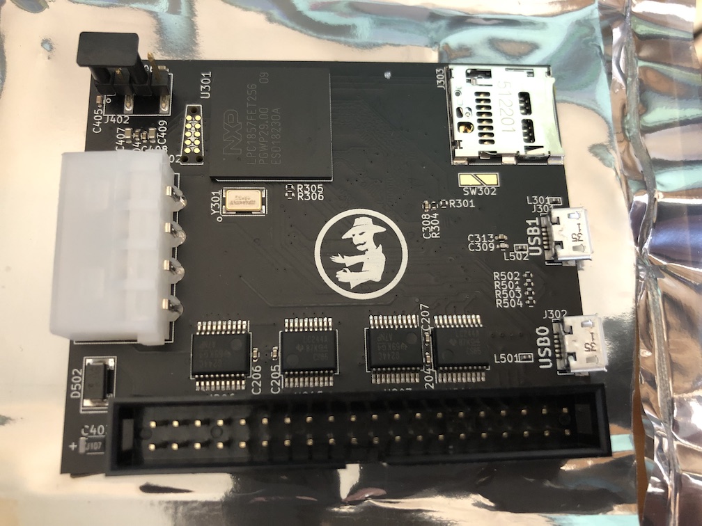

Small production run is complete (with some tweaks from the prototype a few people have):
I'm going to design a small 3D printed case to protect the PCB, but other than that all that's left is to finish investigating an issue with some Namco games (specifically relating to MAME/CHD behaviour).
Nice! I'm sure you'll sell a ton of these outside the arcade community - for use in industrial/medical legacy devices etc.
For your own sanity and/or manufacture cost I would suggest looking into an SMD version of the IDE header.
