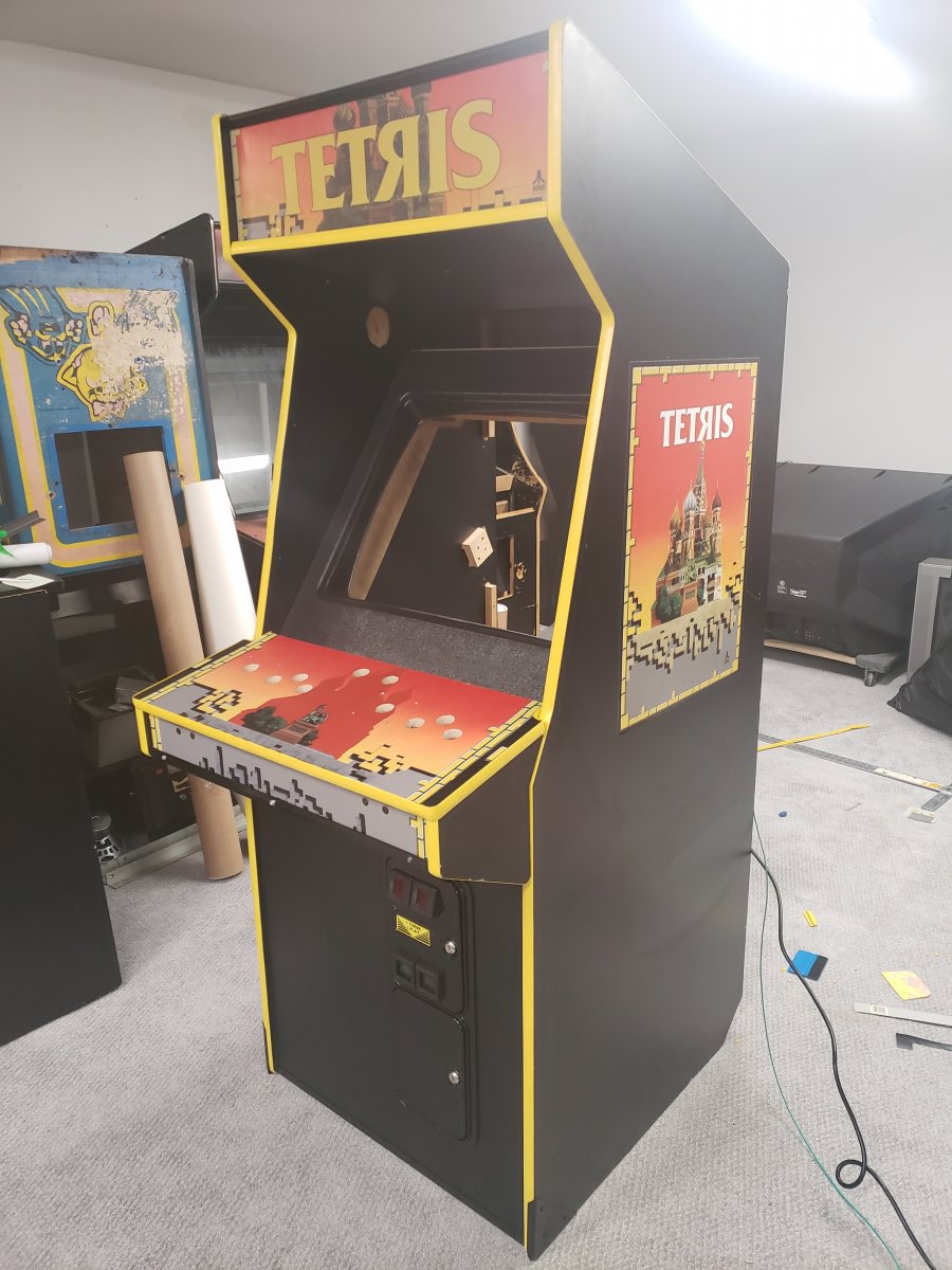

Thanks! again twistedsymphony. I have never tried sanwas maybe I'll give them a go. I picked out the cabinet and bought the artwork and PCB, now I have to finish cleaning the cab, wiring the cab and recondition the control panel.
It used to be one of those Deer hunter cabs. I'm thinking of using Yellow T-molding for it.
Yes I am. It will be more than tetris but Mainly tetris. and the cabinet with be full tetris theme.
I'll post a pic once im a little bit further along
Ok here are is a pic. There is still a lot to do on it but it is already looking much better. the cab used to be a Deer hunter USA which is why i got it so cheap.
twistedsymphony is not not going to be a dedicated tetris 100% as it has 3 buttons instead of one. I will be a tetris but i wanted to make it so i can play more games on it other than tetris.
ill post more pics when It's done
