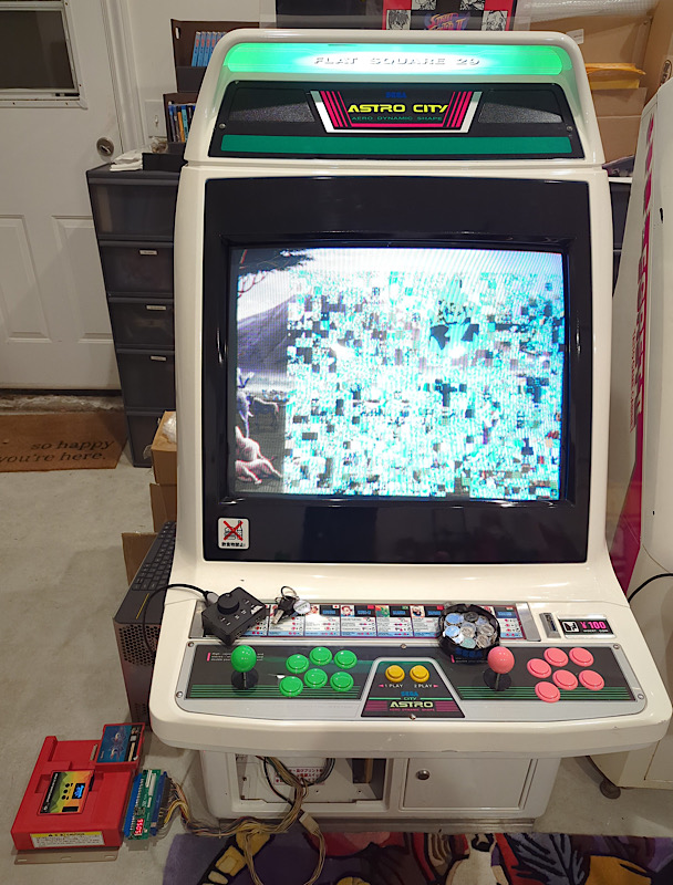

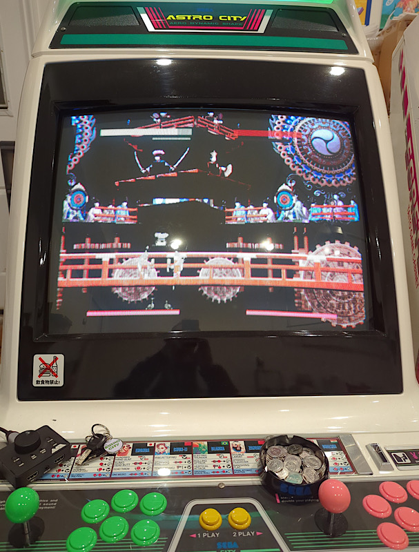

Mine arrived over the holidays, but for various bad reasons, I didn't test it out until tonight. FotNS and Sushi Bar were preloaded, so I tried Sushi Bar, and everything worked fine. Then tried flashing SamSho 6, but a lot of sprite data appears to be corrupted. Guilty Gear X 1.5 gives me an ERROR 01 ROM CARTRIDGE INCLUDES FATAL ERROR after I select a character.
I'm going to experiment with it a bit more before asking for support over on Neo-Arcadia. I saw some people mentioned trouble when using an expansion IO, but GGX behaved the same way with or without it. (Didn't try SS6 again since the slow flashing doesn't lend itself to frequent switching.)
Can you give more details? And maybe pictures? I didn't notice anything on my side but I didn't play much of this game.

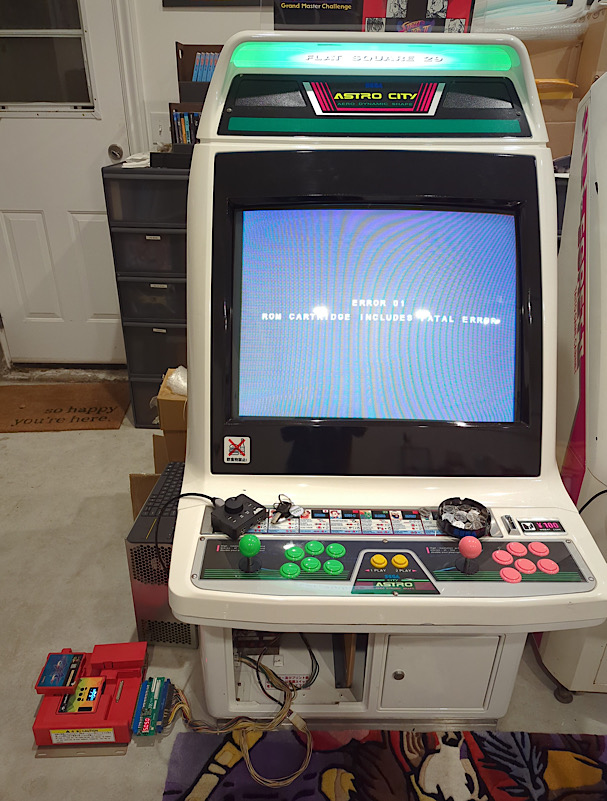

I just retested, no problem at home. Do you have the problem every time?
I also played SS6, no problem.
Yeah, if this were happening widely, I’m sure it would have been evident from the Neo-Arcadia thread. I’m wondering if mine was damaged in shipping. If there’s just something like a broken solder joint, I can repair it myself.
I tried 2-3x per game and found the behavior consistent. I haven’t tried SS6 without the expansion IO card yet. Voltage reading from my JNX Atlas (the JAMMA board between the Atomiswave and cabinet JAMMA harness) was ~5.05V.
SamSho 6, behavior seems good but graphics are garbled:
GGX 1.5, good until I choose a character:
