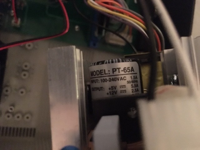

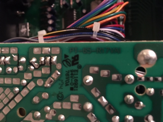

Anyone know the model number of the mean-well psu they used in this supergun?
