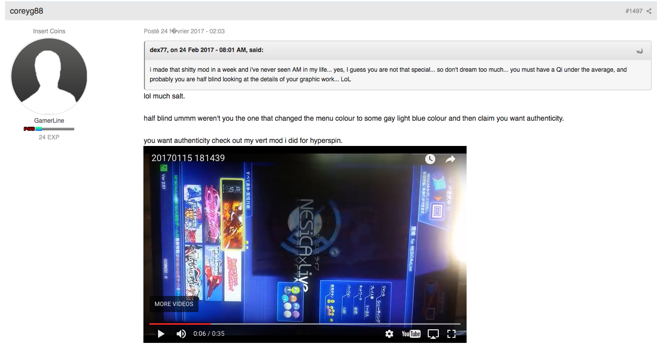

The NXL theme is working great, and thx Corey to bring it to nikomulti.
I saw a user call coreyg88 ( is he corey?) at another forum that make some change for the theme and its look so close to the real thing, is it possible to use it with the AM? The animated nesica card look awesome!!

any modification made to my original are going to be out of date, codebase wise, and the code is already a hot mess i personaly have no intention to make it look more real then it currently dose, beacuse the card symbol to me is meaningless, and id rather have a more functional gui, that iv made.
some of the features and changes are
Game logo on the top left
Manufacture logo on the top right
system of origin under the game logo
Artwork toggle button, select between video snap shots, or flyer on the fly
Original game Japanese title at the bottom of the screen
network logos reacting to if a game has online features showing offline/online
And fully translated to boot.
lollolololololololol
yea thats me i was trolling DEX with that video. its actually of the real nesica menu. he was spouting his was more original but had a hissy because atrfate said his colours were off.

i should mention their is ZERO chance of that being shared for reasons i cant even say with out given away what would happen if i did.

LOL, I see, what artfate made is really good and the colour look good to me too. :thumbsup:
