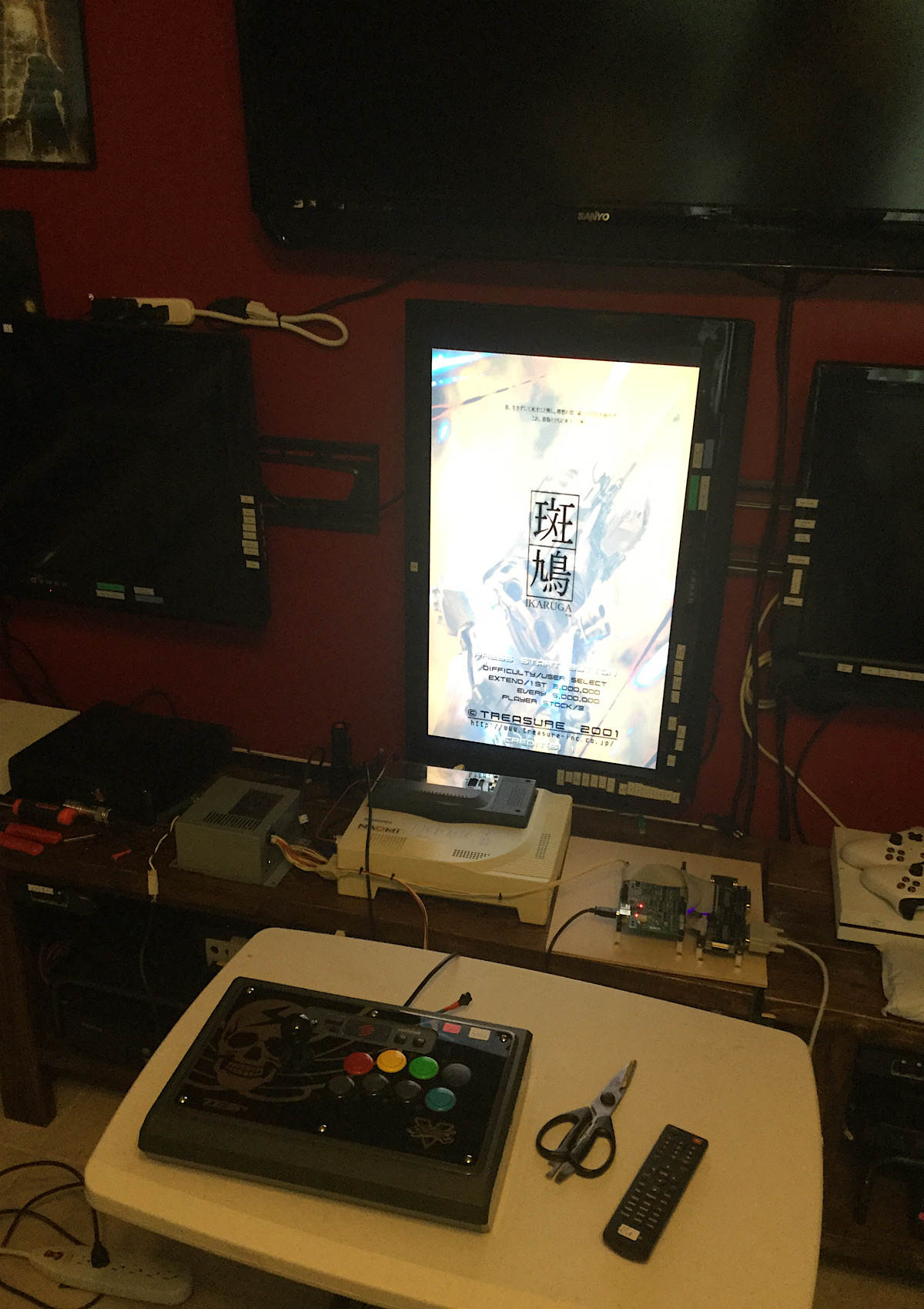

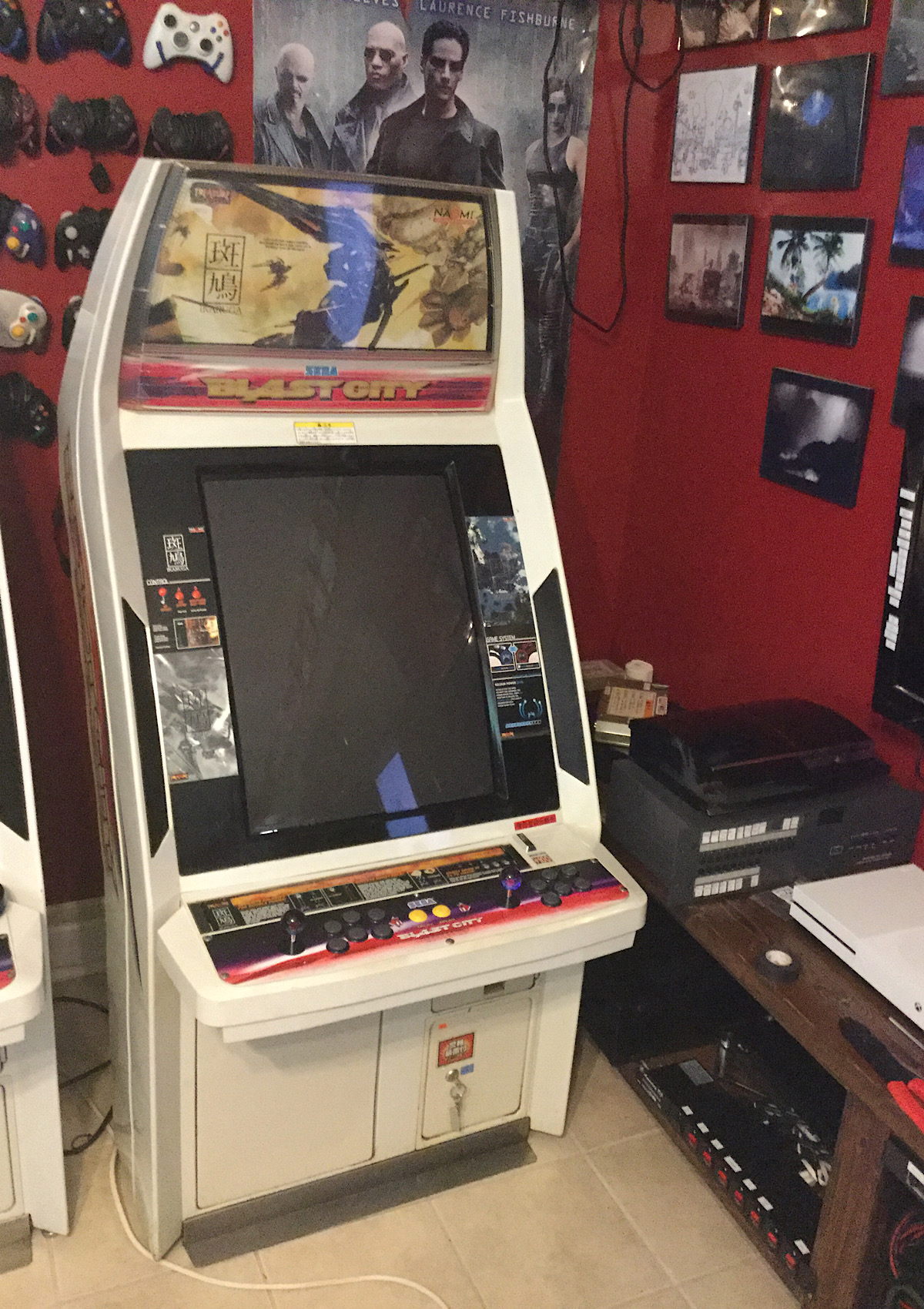

Damn I’m having issues with 2 evga supplies, using mitsu’s older version, sometimes works then I turn off and back on and it won’t power up the Naomi. Somewhere I have a sun psu so I can dig around for that.
Edit: yes! Found the sun and it works great. This was my first time getting mitsus helper board and my jvs 1.5 board running and it works! I didn’t screw up any wiring. Next step pull the monitor on this blast to get 31hz working and it will be dedicated ikaruga for a long time.

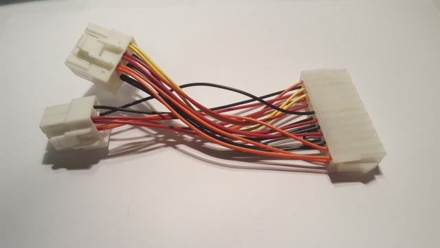

This high-quality, hand-crimped adapter will allow you to power your entire Naomi setup including the main pcb, DIMM or NetDIMM, and GD-rom or CF Kit (with separate cable) using a standard PC ATX power supply. This adapter is wired by default to power on automatically when you power the ATX supply but there is an option available for leads to allow you to mount an external power button. This adapter runs a wire from EVERY SINGLE 5v, 12v. 3.3v and Ground connection on the 24-pin ATX connector for more robust voltage control to prevent starving the Naomi of the necessary power.
Adapter shown is wired for auto-power when ATX power button is flipped on
