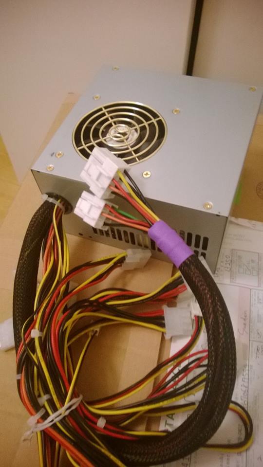

Stompp Student Joined Jul 21, 2015 Messages 87 Reaction score 46 Location Stockholm, Sweden Aug 21, 2015 #2 I could but I don't have any parts at home Do you need to save the PSU for something else? If not, just do this

deibit Champion Joined Aug 14, 2015 Messages 1,739 Reaction score 1,896 Location Germany Aug 24, 2015 #3 Yes i could hack the Power Supply connector but the issue remains.. (the JVS side connectors) And since the Power Supply is a Tier1 PSU (=expensive), I would like to avoid hacking it

Stompp Student Joined Jul 21, 2015 Messages 87 Reaction score 46 Location Stockholm, Sweden Aug 24, 2015 #4 deibit said: Yes i could hack the Power Supply connector but the issue remains.. (the JVS side connectors) And since the Power Supply is a Tier1 PSU (=expensive), I would like to avoid hacking it Click to expand... Aah no, don't do that. Where do you live @deibit?
