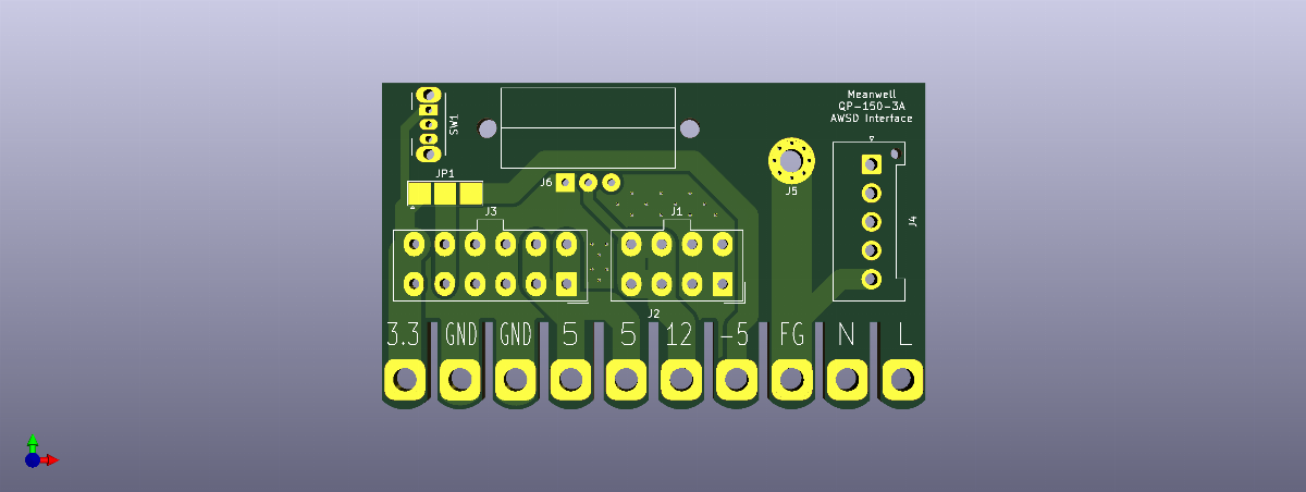

I was well on my way to building a wiring harness to take the screw terminals on the Meanwell and adapting to the JST and Molex connectors needed for the cab wiring, and after my mouser order showed up with the power supply and connectors, I started thinking this would work much better as a single PCB.
This board should screw down to the terminals on the Meanwell power supply and provide the JST VH connector for AC power input as well as the 8/12-pin Molex Mini Fit connectors for DC power output.
I have added the mounting holes and solder pads to add an LCD voltage display, https://www.aliexpress.com/i/32840259666.html?spm=2114.12057483.0.0.206f62fepYHKGu
Also a small switch to change between the 3.3 and 5.0 volt rails being displayed. The QP-150-3A has adjustment POTs for 3.3 and for 5.0, so that should help in adjusting the voltages.
I added a round pad terminal for the FG connection in the cab.
The AWSD arcade cabinet has 2 unused conductors in the 12-pin Molex connector. The stock AWSD power supply provides 3.3 volts on these pins that is never utilized inside the AWSD cabinet. I have included a 3-terminal jumper "JP1" on the interface board. It allows selection of 3.3V or -5V for these 2 pins. The rationale is that if you wanted to add the pins and wires to your AWSD arcade cabinet, you could add -5 Volt to the wiring harness and enjoy the games that require -5V. The hardest part would be sourcing the pins for the JAMMA connector, but you might be able to reuse off old harness.
https://github.com/wifiber/AWSD-PS-Interface
https://oshpark.com/shared_projects/2lTFHjc9
Let me know what you guys think, open source so feedback and improvements welcome.

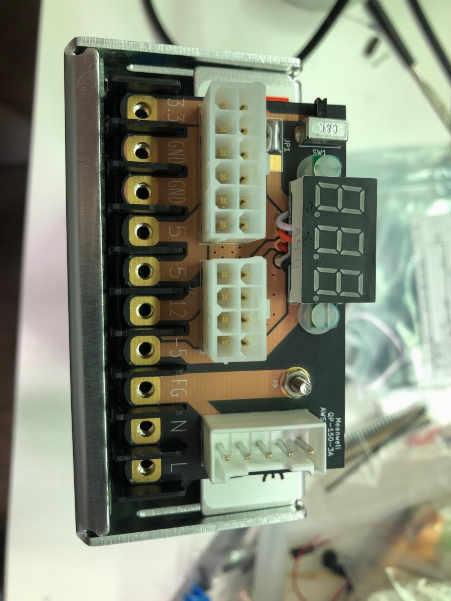

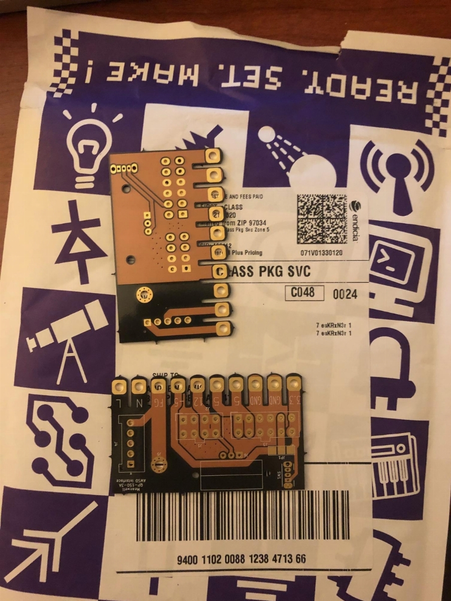

PCBs arrived

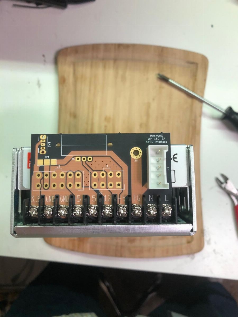

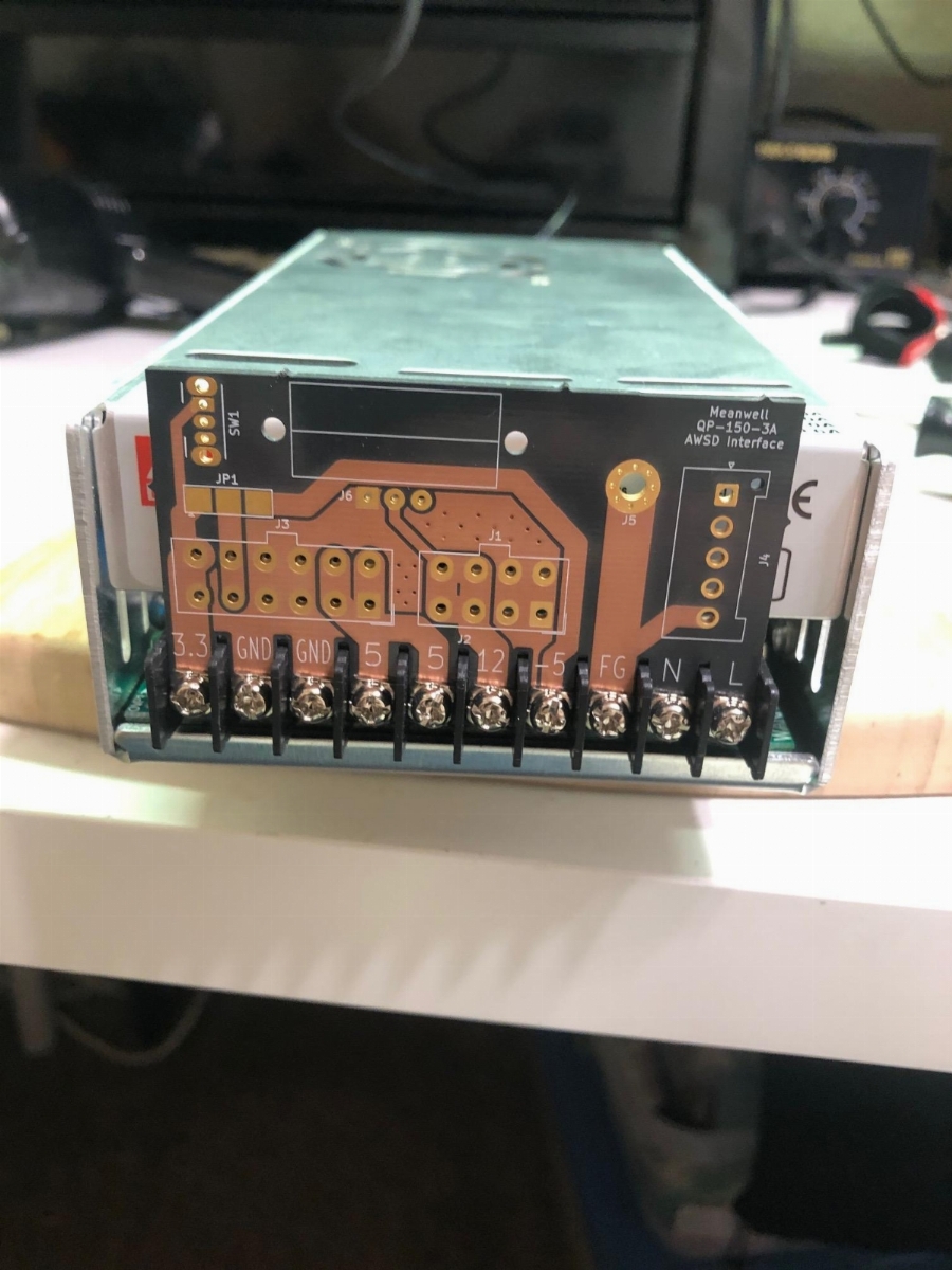

Mounted on the front of the Meanwell PS
Board with the AC input power connector set in place, my other connectors are in route.
I will take more pics when I get it fully populated. Still have to solder the connectors on, solder the small SPDT switch and the voltage LCD. Happy that all my measurements were correct and the board fits on the PS perfect.

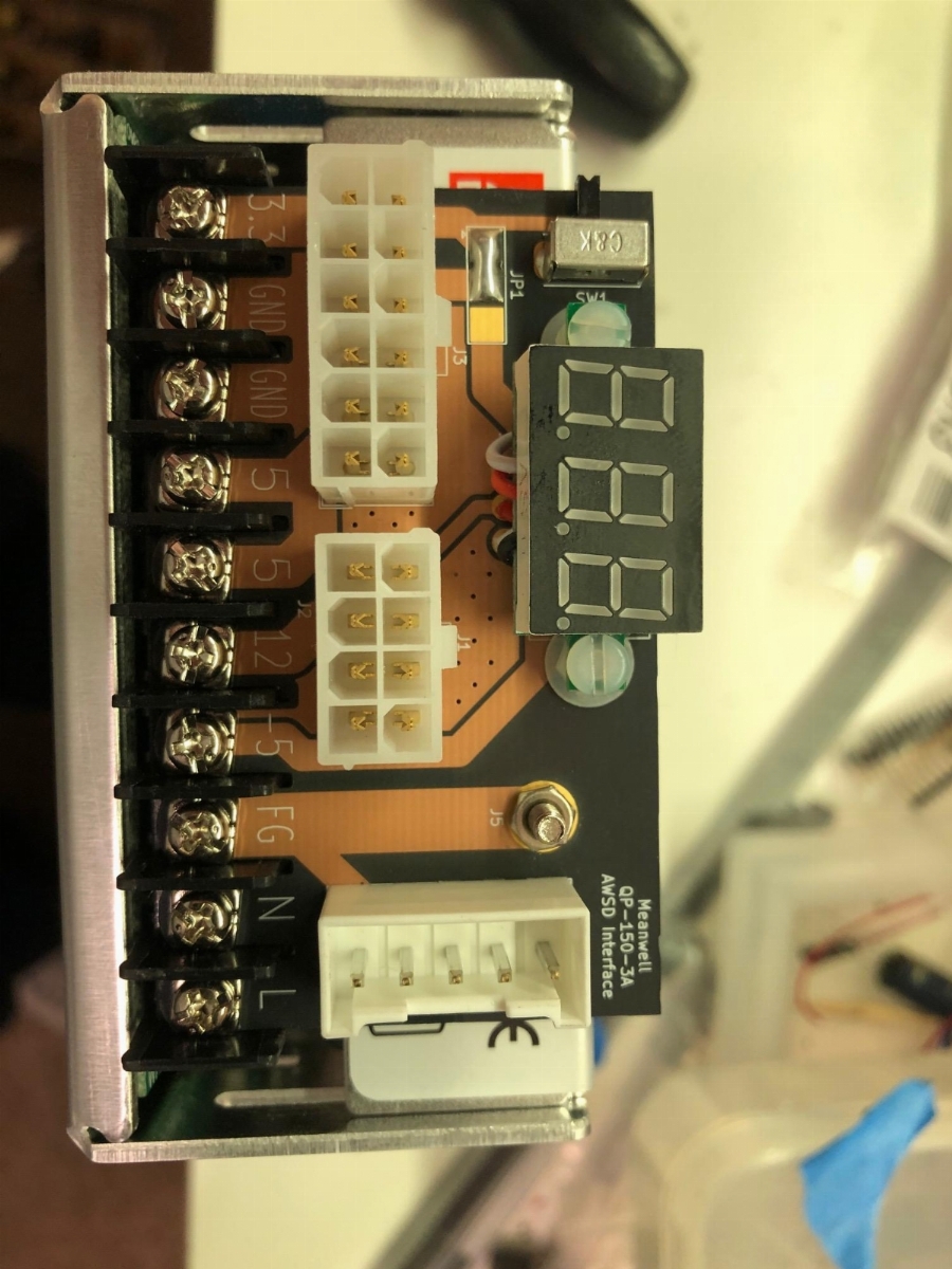

All finished

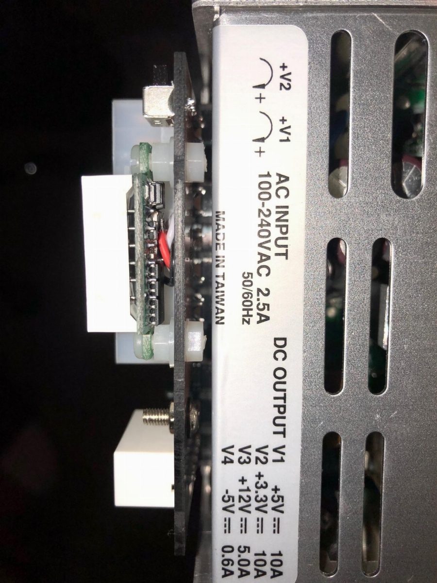

Here it is all populated and installed on the PS
The clearance on the back side looks adequate. Plus as an added bonus, the nylon nuts used to hold on the voltage LCD prevent the PCB and lead protrusions from hitting the metal case of the PS when inserting the connectors

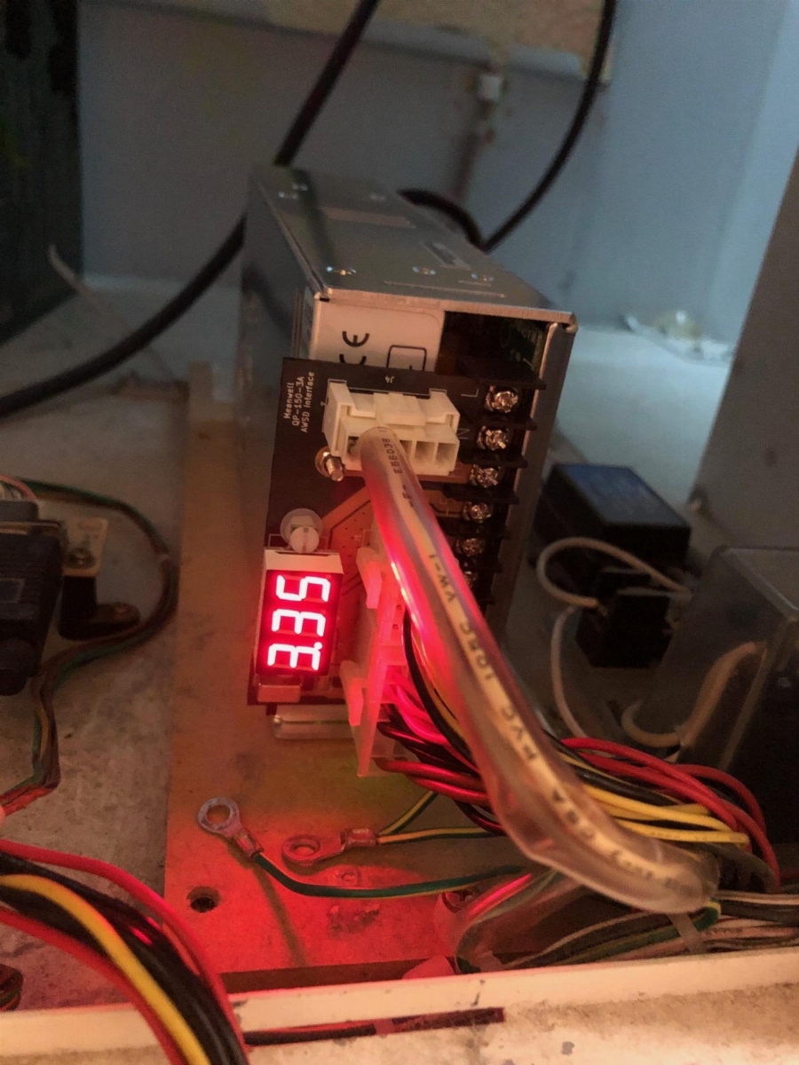

Test fit looks good. I didn't connect the ground lug yet, but those ring lugs should swing over and attach to the screw post on the interface board with no problem.
Here the voltage LCD is displaying the 5 volt rail. I haven't adjusted the power supply or calibration pot on the voltage LCD, but we are pretty close out of the box.
And switched to check the 3.3 volt rail
Parting shots
