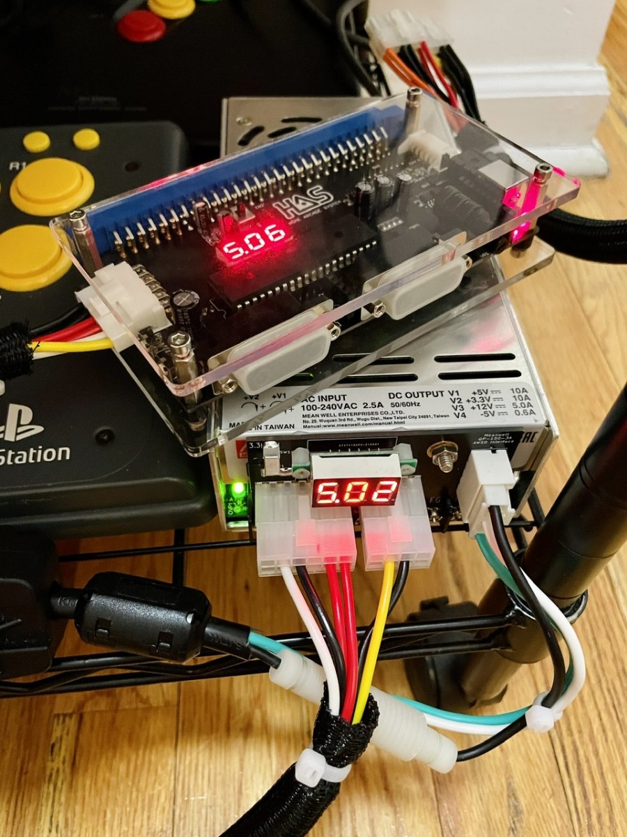

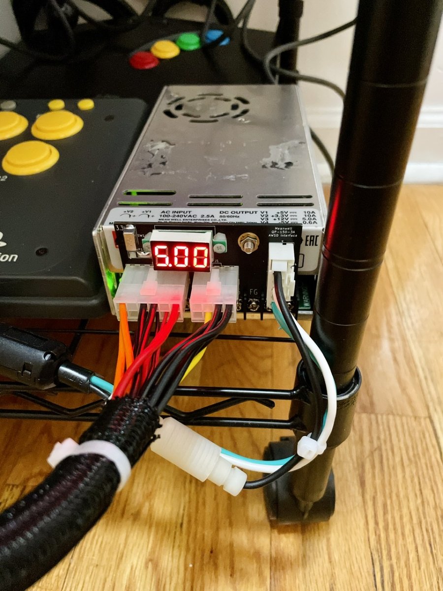

Wanted to post about my use case which may interest others. I picked up this PCB so that I can use it in my supergun setup and it works surprisingly well and adds a ton of flexibility.
Given that the PCB attaches to a PSU that puts out all of the JVS voltages, I built a JVS harness and hooked up my NAOMI first. The voltmeter is pretty accurate once calibrated and I appreciate the switch allowing you to check both 3.3V and +5V lines which are both adjustable on this PSU.
The really great thing about this PCB is that you attach the DC harness via Molex connectors meaning you can easily swap harnesses. I figured I would build a harness and use for my HAS as well. As delivered, the PCB doesn’t have the -5V some JAMMA boards need for audio but that’s solved by setting a jumper switching two of the four 3.3V output pins to -5V.
To summarize, while the PCB was designed to allow the Mean Well QP-150-3A to be used in an Atomiswave cabinet, it makes the PSU super flexible and a perfect supergun PSU for both JVS and JAMMA boards.

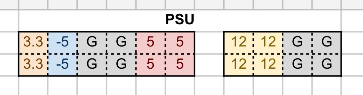

There’s no fast way to switch jumper as designed.
Do you need more than two 3.3V lines? Moving the solder jumper leaves you with two 3.3V and two -5V lines.

sorry im horrible at wiring bare with me I understand now on the cute. I have a taito e3 i would like to use this in. If im gathering i would have to add a wire to jamma edge to get -5?
My understanding is that the Egret 3 is not wired for JAMMA but for JVS. You can replace the PSU in that cabinet with a QP-150-3A and this AWSD interface PCB but JVS boards don’t require -5V.
