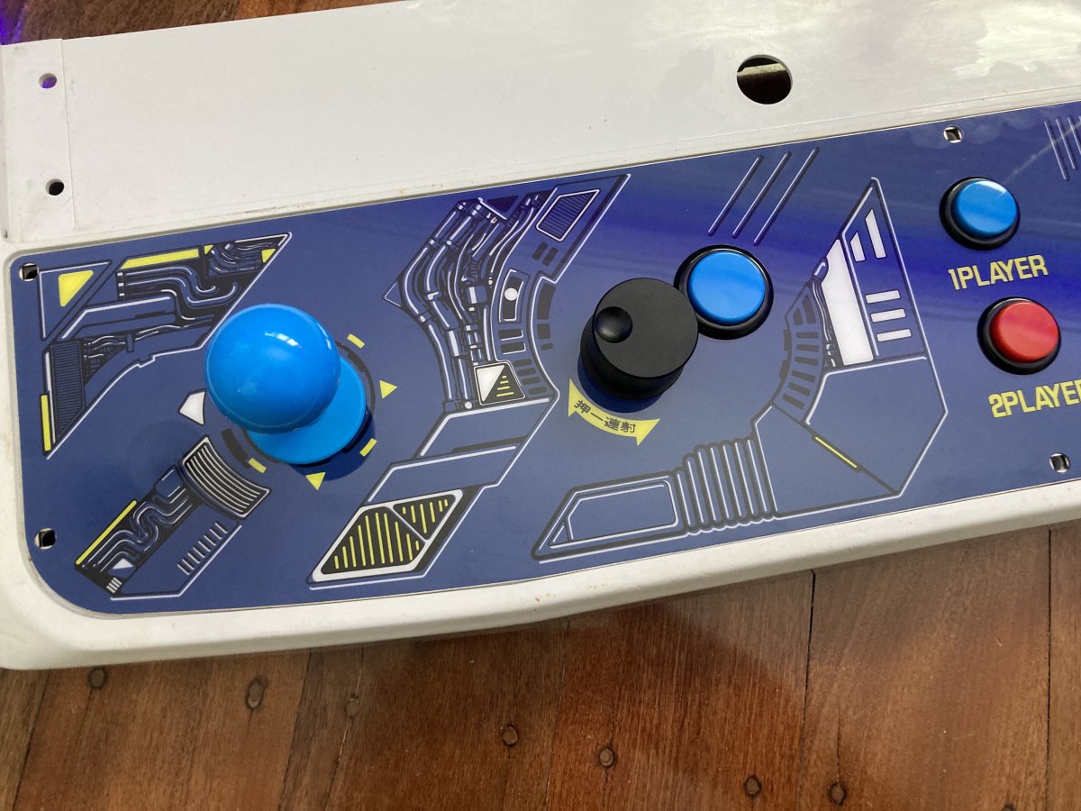

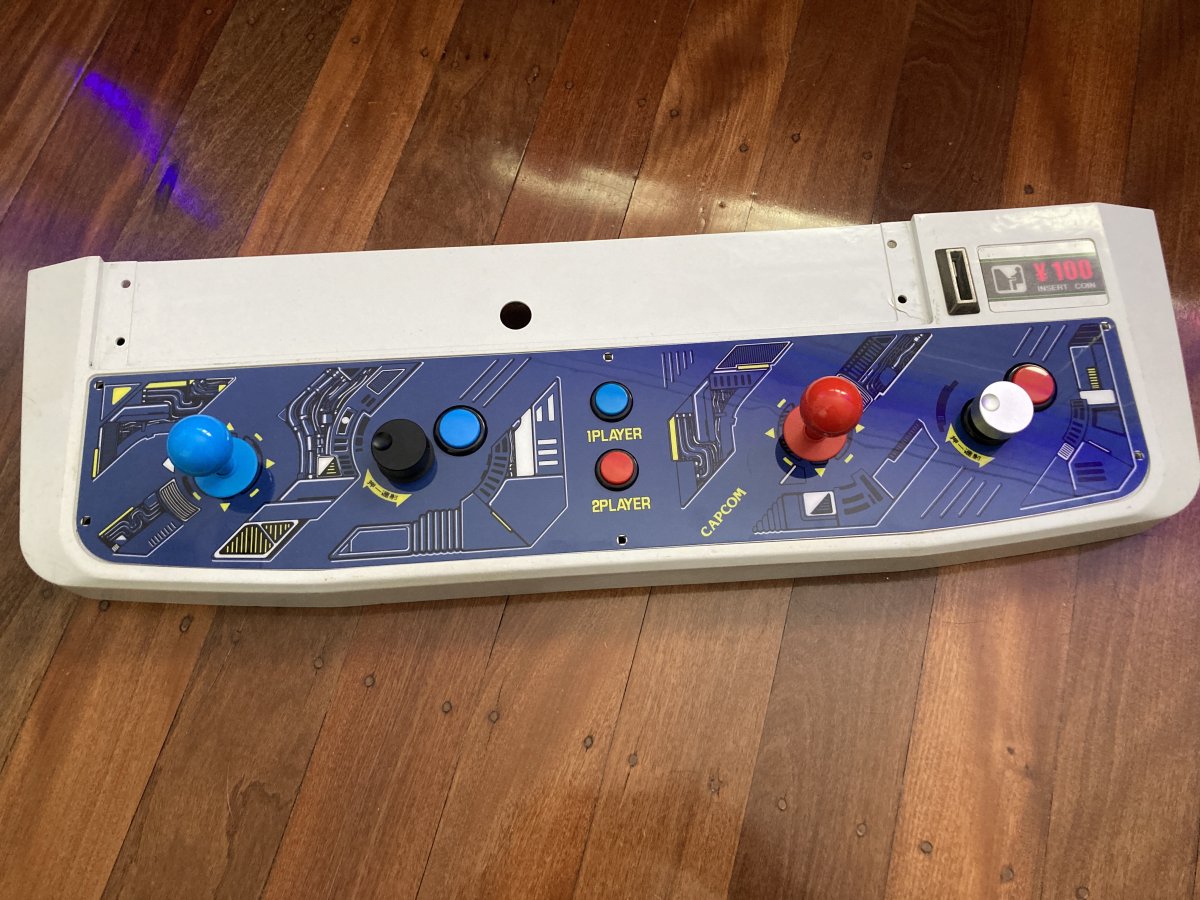

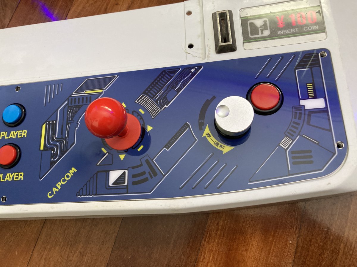

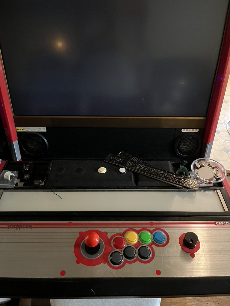

Got my spinners and installed them in my new astro. But unfortunately they don't work or i'm too stupid. did you have to activate something somewhere else?
I used mine with the @aje_fr CPS-1 Multi which has an option to select spinner for the controls.
I’m guessing there’s a Dip Switch on the CPS-1 A-Board to activate. Try google it, or maybe someone will let you know.
Are you using the spinner roms and not the joystic roms and are they in the proper connector.
VJPs issue was resolved. There was a bad solder connection on the CPS1 adapter. Works fine on FW now.
