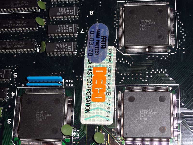

Hi every one , I a repairing a bad dudes pcb, can I replace the custom chip
? and if I can where can I find one.
here's a a pic of the chip... the pic came from klov.....
:D
I need to replace the bottom right one , due to the fact that my chip is missing three pins.

I dont think you can, has to be the same chip from another of the same type of board since its a custom graphics chip.
These are the compatible game boards that would have that chip:
Heavy Barrel, Robocop, Birdie Try, Hippodrome, and of course Bad Dudes.
You can try to get one of these boards cheap if sold untested or not working and try transplanting the chip.
You could send it out to get repaired, they will take off enough of the mounting package material to expose the leads for the broken pins and make the connections again. But it will probably cost you as much as buying a board, so there is that.

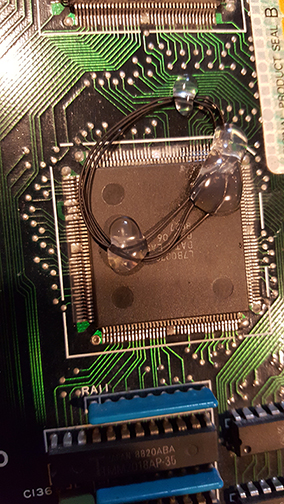

Update
since I can't justify paying 80 bucks for bad dudes .... the ebay prices on arcade pcb's is ridicules.
so I fixed it my self. :)
then I used a box cutter to separate the contacts so it would be easy to solder20160621_120301.jpg
it was a bit of a pain to do but when you separate the contacts it is much easier .
and that's it.
