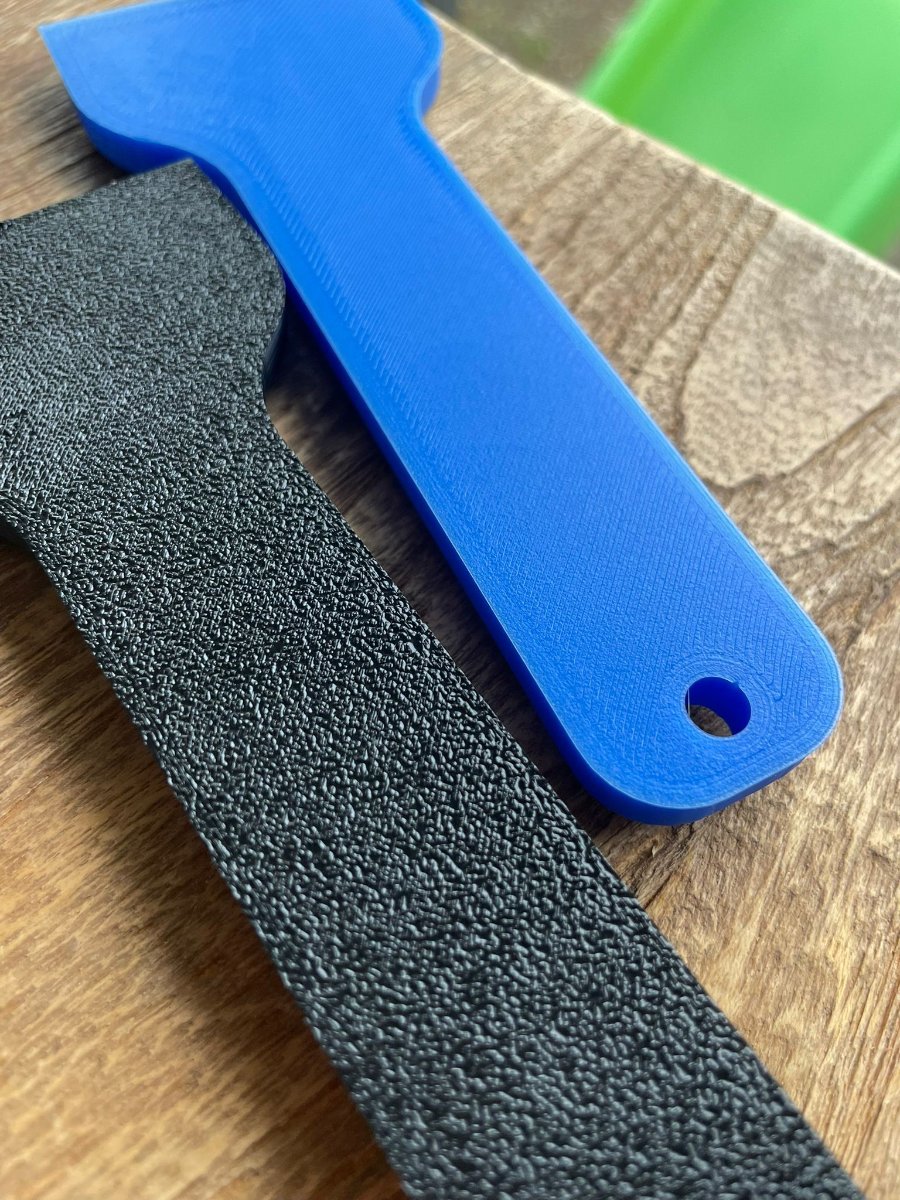

Yesterday I swapped out the standard Bambu textured PEI plate with a Biqu Panda Glacier plate and must say the result is quite good!
Black part is the PEI plate, blue part is the Biqu plate

I'm currently using the Bambu ultra tack plate, and it gives similar results. A very smooth (but not untextured) plate that sticks to dang near everything at ~20C lower temps.

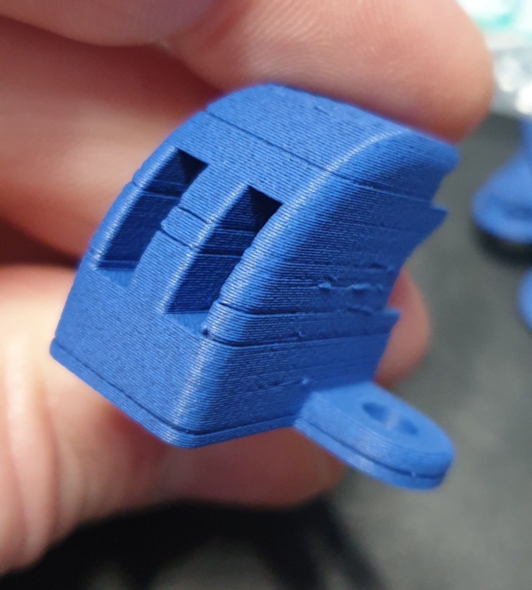

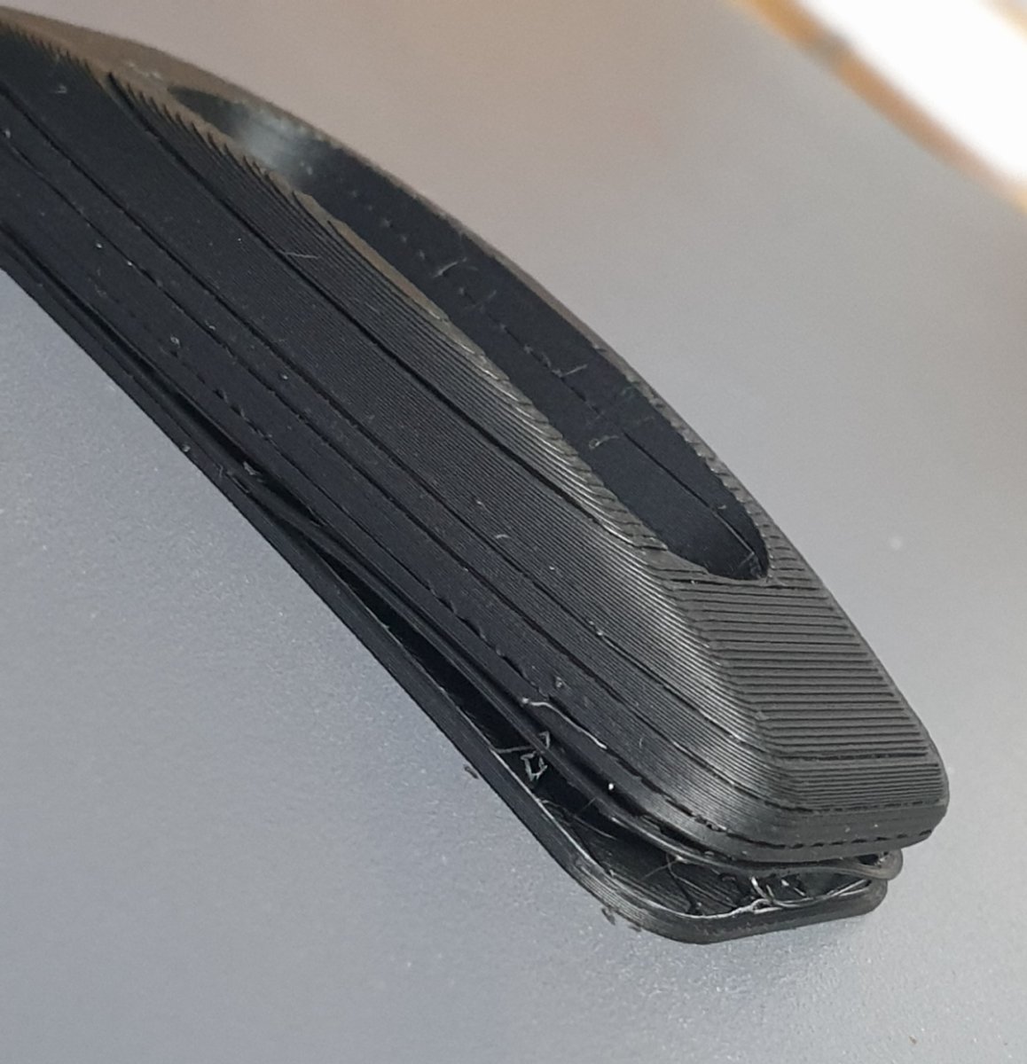

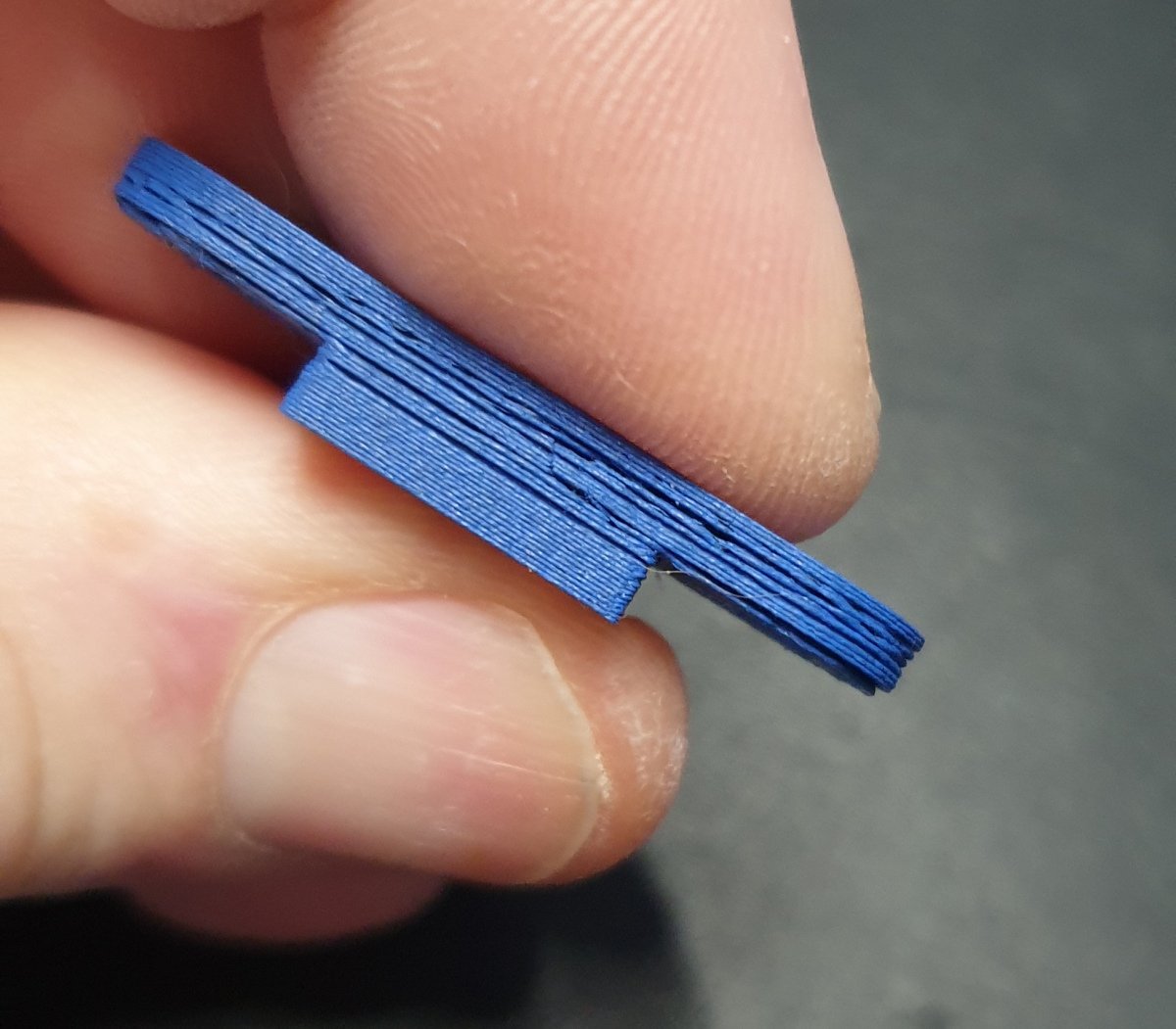

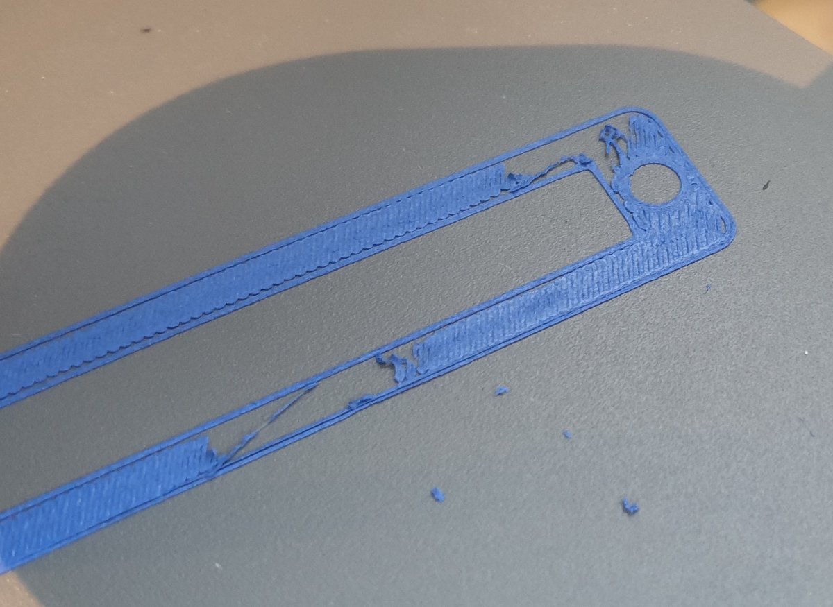

My prints on my A1 started going bad. Long horizontal gaps in a lot of things I printed. Happened only with a new colour of PLA-CF, and so I blamed the filament.
Then it started happening with other filaments: the black PLA-CF which I'd used for ages was starting to do it. Then the PLA matte and regular ol' PLA started randomly... doing nothing at all. They'd just fail to print every second or third run. Massive gaps in surface layers, missing layers in external walls. Several times just flexing the plate to remove an object caused it to completely separate in multiple layers, rather than come off the plate.
Turns out the extruder gear was worn. I got about 450-500 hours out of it (printer's at 505 hours currently). I figure the AMS-lite had enough push to keep it feeding, masking the problem, but finally it couldn't prevent it from happening almost all the time.
So yeah. A new extruder is cheap and I'll be watching for the 950 hour mark, and swapping it out early.

Yup, the consensus is I got really (un)lucky with this, somehow. The difference before and after replacing the gear is astonishing, it was absolutely the whole problem.
