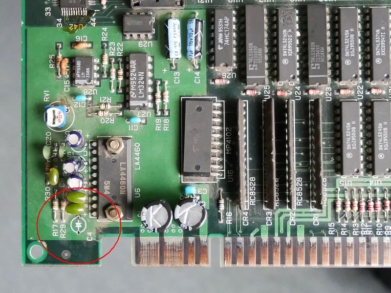

nem Immortal Joined May 29, 2016 Messages 8,124 Reaction score 8,904 Location Finland Today at 12:10 PM #1 My board has this cap knocked out. Can someone check their board for the value? Thanks!
nem Immortal Joined May 29, 2016 Messages 8,124 Reaction score 8,904 Location Finland Today at 12:27 PM #2 Rest of the caps: Code: Capacitor Diameter Qty Location 1000uF 16V 10mm 3 C1, C2, C4 10uF 16V 5mm 1 C8 10uF 16V (axial) 2 C13, C14 47uF 16V 5mm 2 C18, C19 EDIT: updated Last edited: Today at 3:37 PM
IPD Professional Joined Jun 21, 2018 Messages 167 Reaction score 514 Location Sweden Today at 3:33 PM #3 On my board it's a 1000uf 16V. Identical to C1 and C2.
nem Immortal Joined May 29, 2016 Messages 8,124 Reaction score 8,904 Location Finland Today at 3:37 PM #4 Perfect, thanks!
