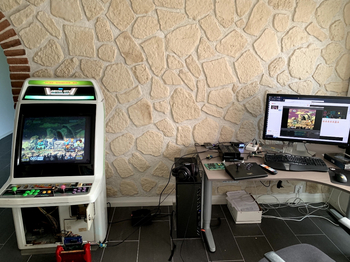

Betsu Betsu is an Open Source Audio+Video splitter, which can be hooked up to cabinets jamma harness to produce output suitable for Streaming/Capture through OSSC + a capture card.
The schematic, board and gerbers are open source (Github here), so you are free to build it yourself, but I’m also planning to make some of these and sell them for about $70 + shipping if there's interest.
The current prototype board looks like this. The final board will be pretty much the same, but with different trim-pots (cross slot) and a few minor adjustments. Soldering will also looks a bit nicer, since I'll probably do heat gun reflow instead of just hand soldering.

Action shot of prototype board being used to capture Demon Front above.
