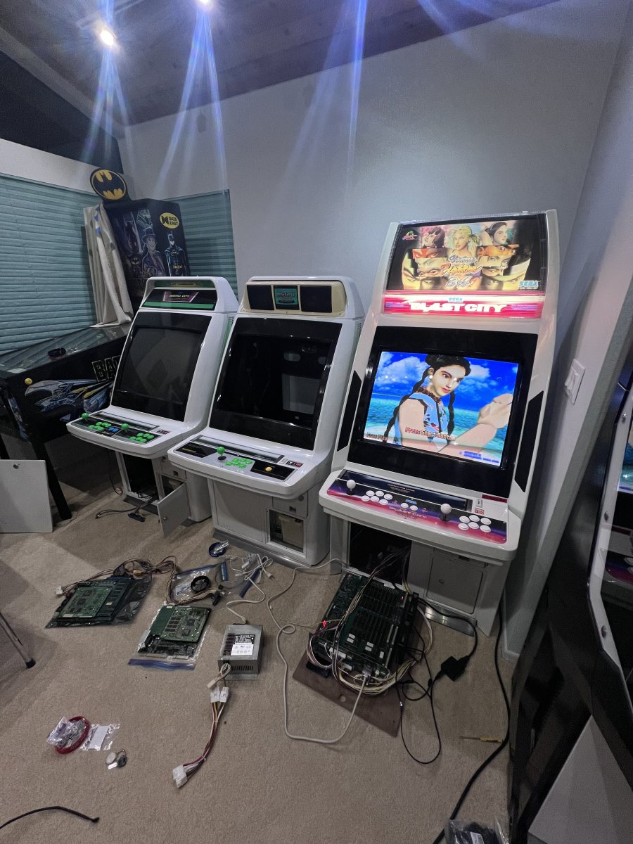

@Lemony Vengeance I am down. I got the VF3 adapter you sent, however it must be an issue with the board as I am still not seeing characters on screen.
I played with the POTs but it still had the same behavior.

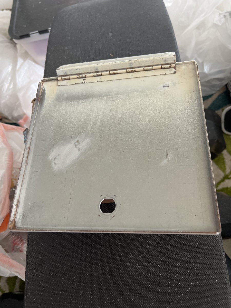

What’s the proper color of the inside of a Astro door? This coin box door and almost all of mine are half white half metal color.

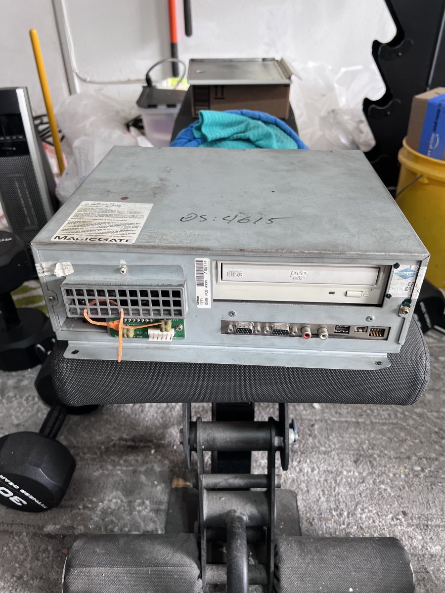

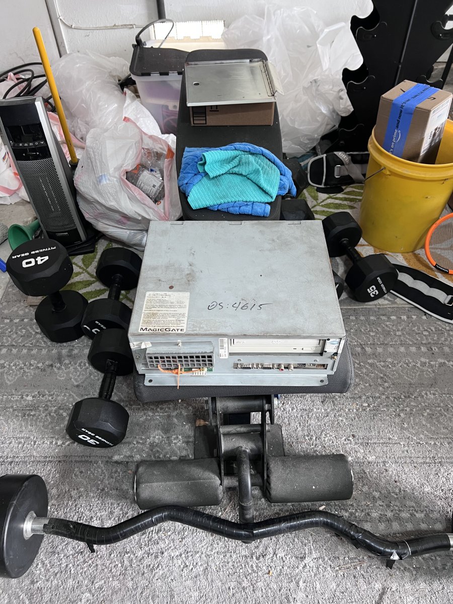

Idk if anyone has dealt with "youngerarcade" on eBay or Ali Express but I just picked up a System 256 tested with DVD drive and Tekken 5 Disc and Dongle from AliExpress for $199.99 with free shipping. It says 2 months shipping so i'm assuming on a boat but not sure if it will come sooner than that.

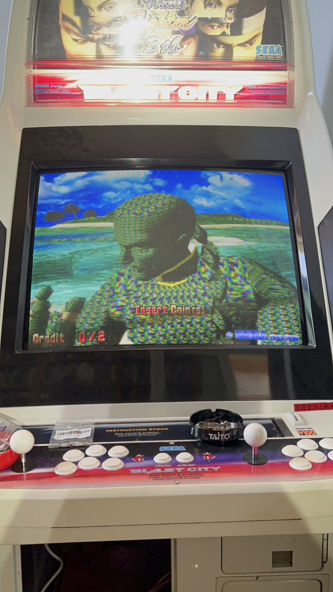

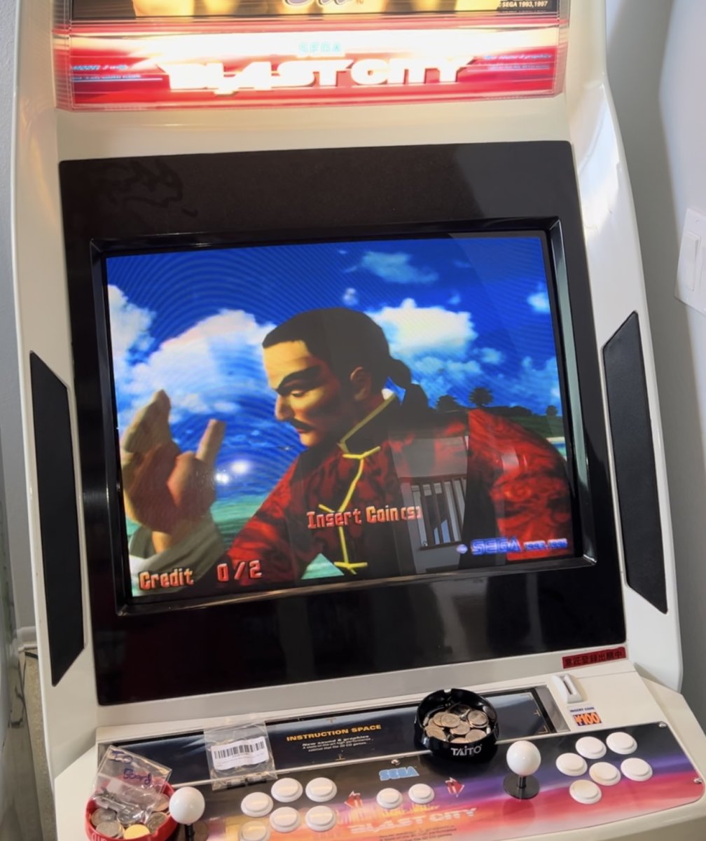

So I reseated the pcbs on VF3. First attempt I noticed one was really not plugged in well at all on the side, turned it on and got characters but that were mostly gray.
Reseated gently the ones in the back of the stack and boom! Finally seeing characters. All graphics appear to be working now.
However, my coins are not being detected when using Lemonys power adapter and the test button on my Blast City cabinet does not work.
I switched over to test with the VF3 Blast City Harness and test and service buttons worked and I was able to register coins that I inserted.
Other things I'm perplexed about are dark levels are really really dark, there is a loud buzzing sound from speakers on Blast City or Sun PSU power, and the sounds are kinda faint and washed out.
Certain punches and kicks are bearly audible while other sounds like the sound-effect right before a level starts are clear as day. The announcer is also really hard to hear.
I had a Mistercade in my Blast Previously and Naomi 2 Net Dimm and had no crazy loud buzzing or major sound issues.

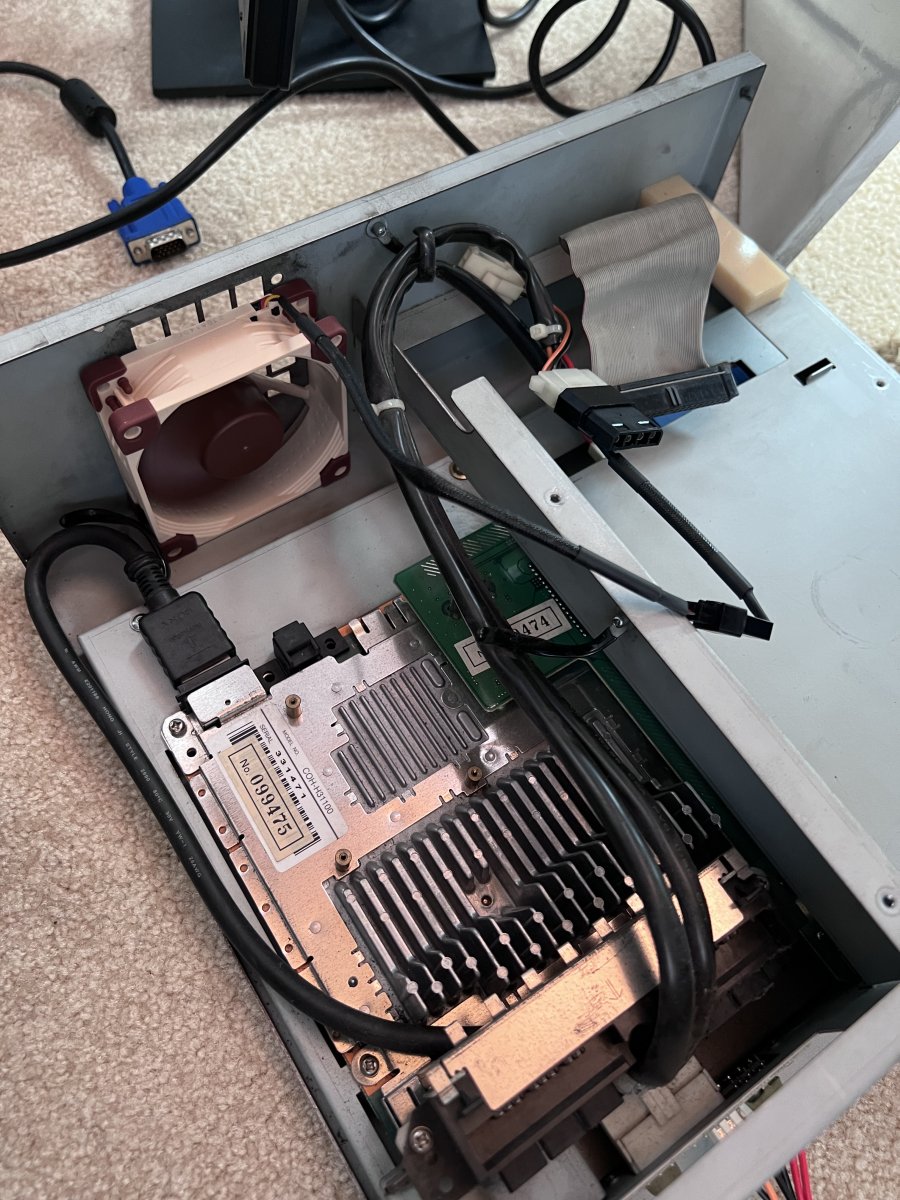

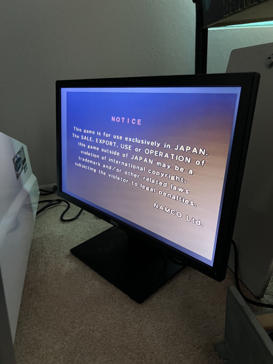

Got my system 246 io board. Tried all dip switches off with video going thru jamma and 1 off and the rest on with VGA attached. Trying it on my Blast City MS-2931 but no luck so far. Getting green bars or a green screen. Assuming it has to do with sync but idk what I’m doing wrong.
I'm hearing the dings on startup - and can briefly see some text sometimes. Wondering if I just need to try this on another cab \ PC monitor.
Could be the disc or disc drive too not sure a this point
This is far as I get. 6 beeps so I guess my dvd drive doesn’t work or my discs? I burned one from internet and one that came with the unit.

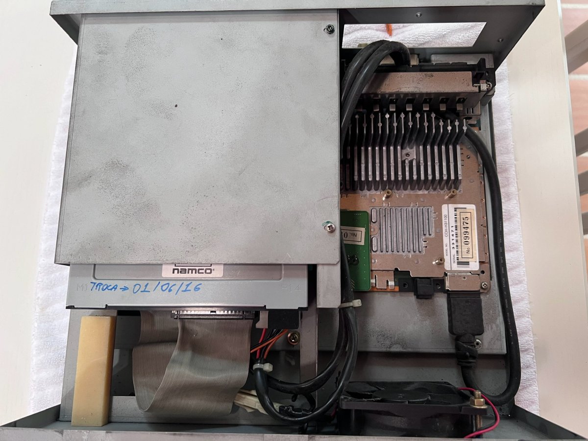

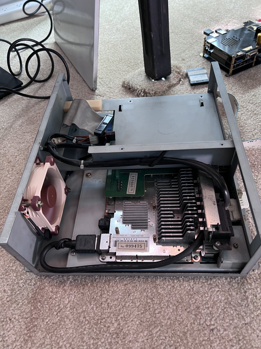

(assuming the stock fan is 60mm - the one that came with mine was 80 mm replacement with a soldered connector)
Also have the Noctual 60mm equivalent if I change my mind.

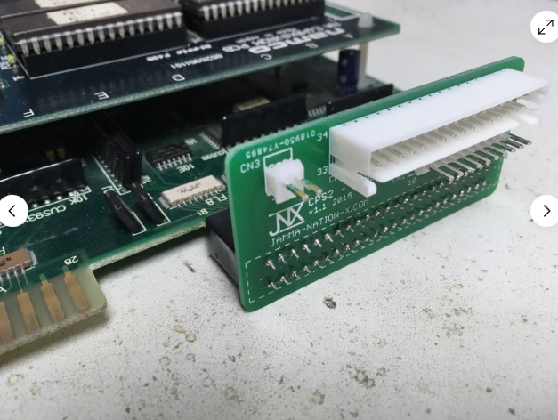

I bought one of these for Tekken 1, 2, etc.
It says CN3 is for Right Channel Stereo ->
CN3 is for stereo right channel, it requires a JST NH Series 2 pin connector.
1. Speaker R +
2. Speaker R -
My question is if Left Channel Stereo is coming off of JAMMA edge and Right Channel Stereo is coming off of this JNX adapter.....how the heck do I get that wired up to my speakers in like an Astro City or Astro City 2 cab? I definitely want stereo and not Mono sound for Tekken boards.
I wanted to use an amplifier that has RCA inputs but am confused on the whole line level, speaker level, and how to make that work.

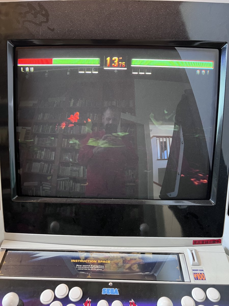

Got the JNX adapter working with Tekken Tag. Need to test the other games. Hell yeah! I can kick ppl now!
