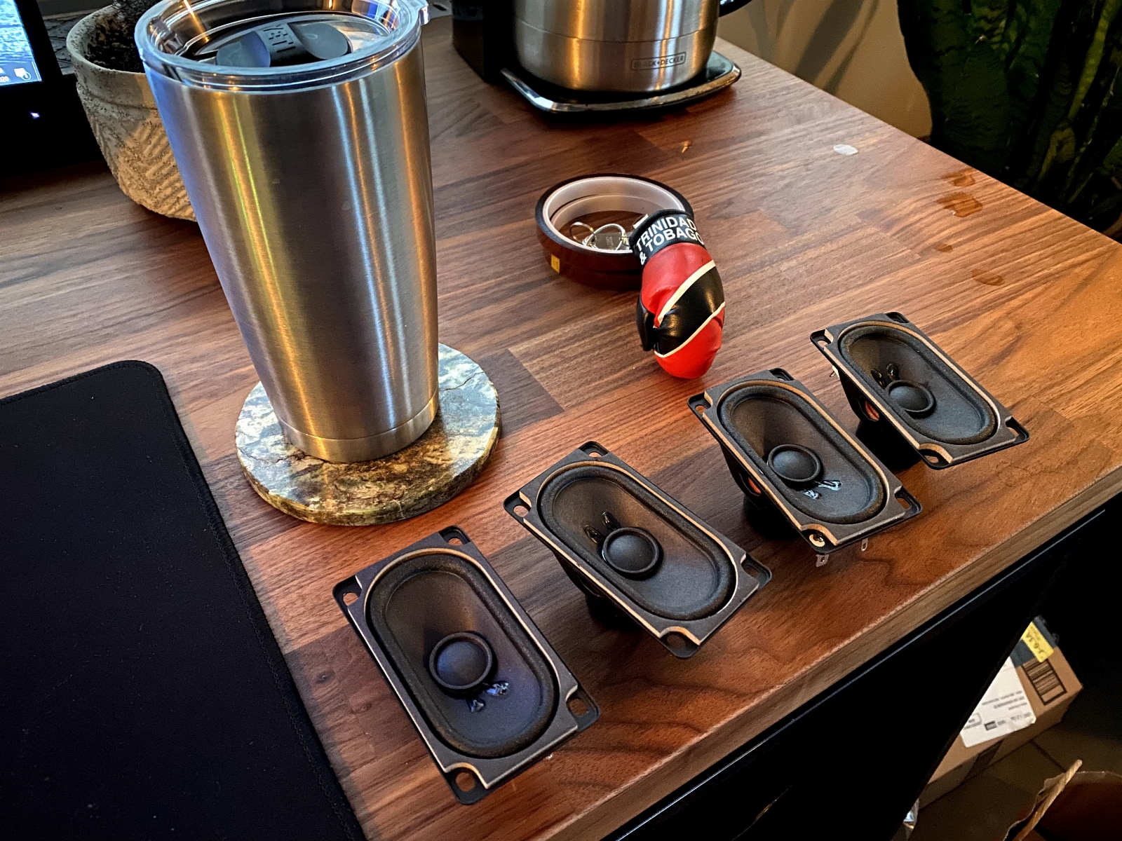

Today, my speakers came in. And I ordered some new wheels for the Blast. Initially, I had planned on using something purple, but I found these red wheels that looked really nice and I couldn't pass them up.
@Anselmo, I don't think so. I just copied @mR_CaESaR and got some of the oversized speakers from this post:
https://www.parts-express.com/aurasound-ns2x3-184-4a-2-x-3-extended-range-driver-4-ohm--296-256
I'll see how they work out. I've seen people put entire sets of PC speakers including the housing in blasts that use their own amp, but they look pretty bad from the inside. Although I'm guessing the sound is muuuch better then these little guys.
i put these in as well - they barely fit in the original housing (once finished it looks pretty painful) but they work - getting the speakers removed from the cab and reinstalling them is a major pita if you try to do it without taking the complete cab apart.@Anselmo, I don't think so. I just copied @mR_CaESaR and got some of the oversized speakers from this post:

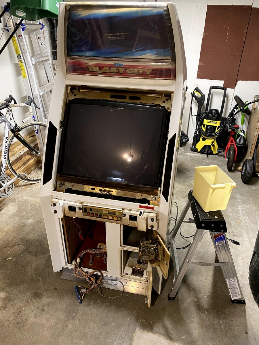

The PSU and Amp recap isn't a bad one to DYI, but if you are looking for someone I know @rewrite has posted in the past about doing them. I would check with him. Not sure if he would take the chassis project, but I know sharpimagerepair.com will do the recap on the chassis.Just curious, does anyone have any recommendations on who does PSU recaps and monitor recaps for Blast City's? I've been reading about the monitor and it looks like some people stay away from servicing this particular model, but there are a few places I saw from back in '19 that still do. And I'm also not certain if my 750 A1 component has started pooping all over my monitor PCB yet, but I assume that's part of the reason why people avoid servicing this monitor.

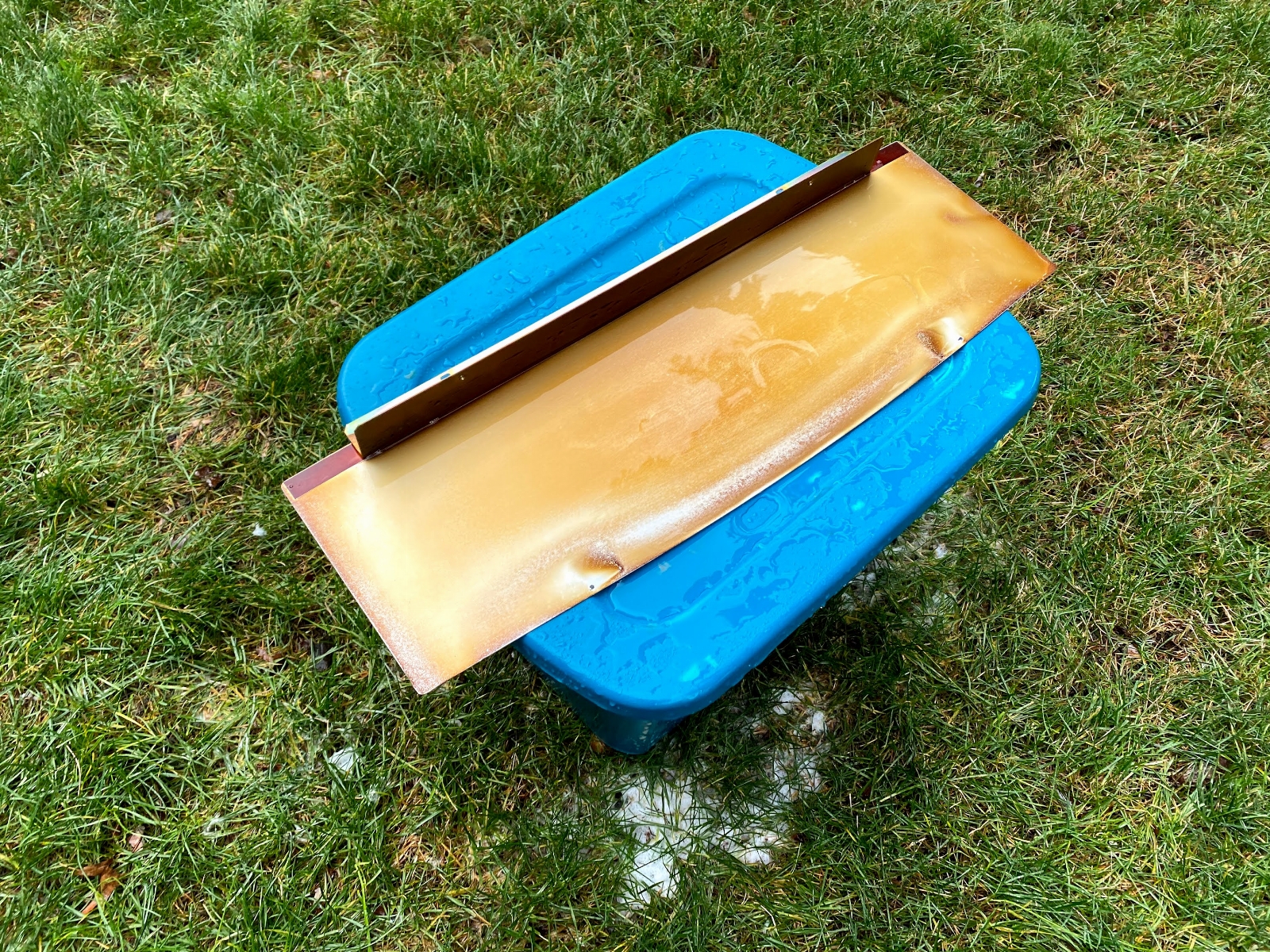

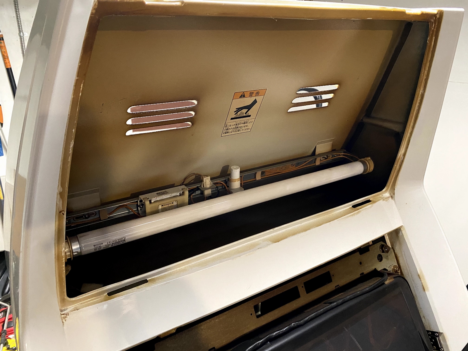

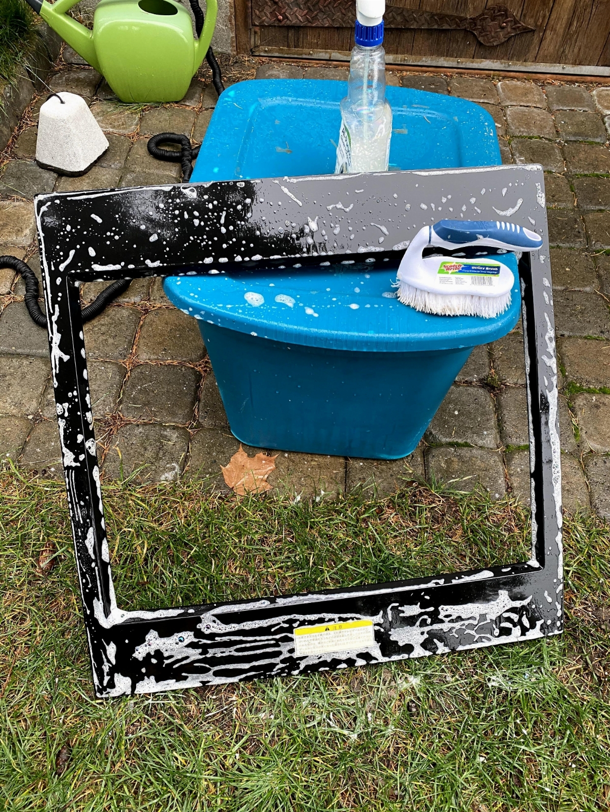

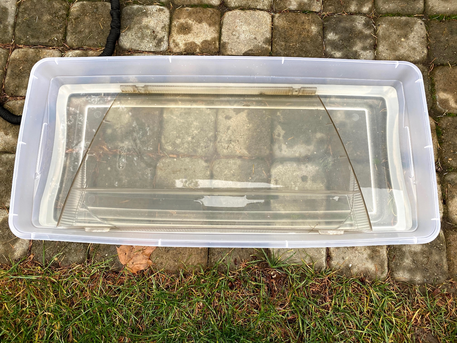

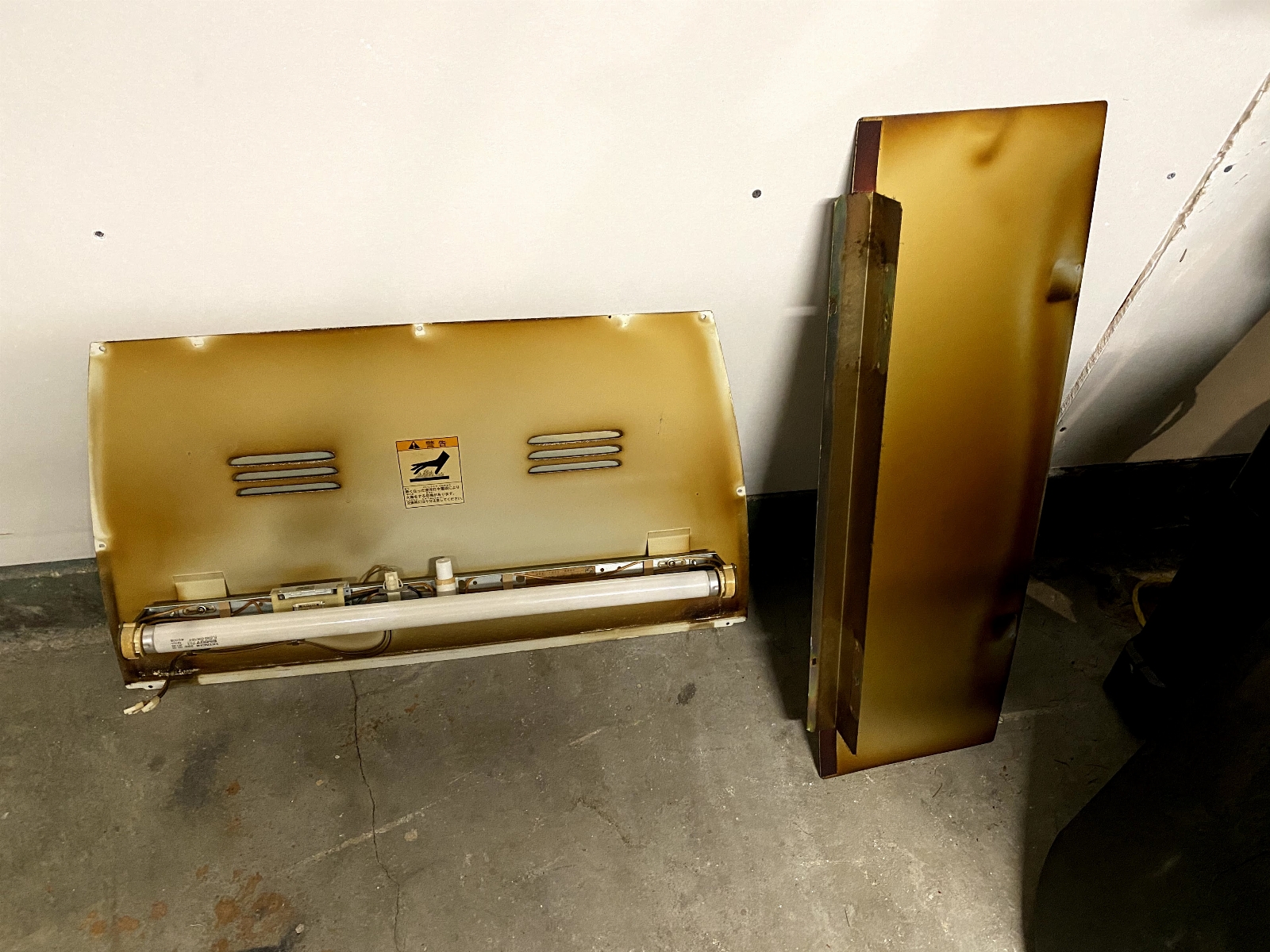

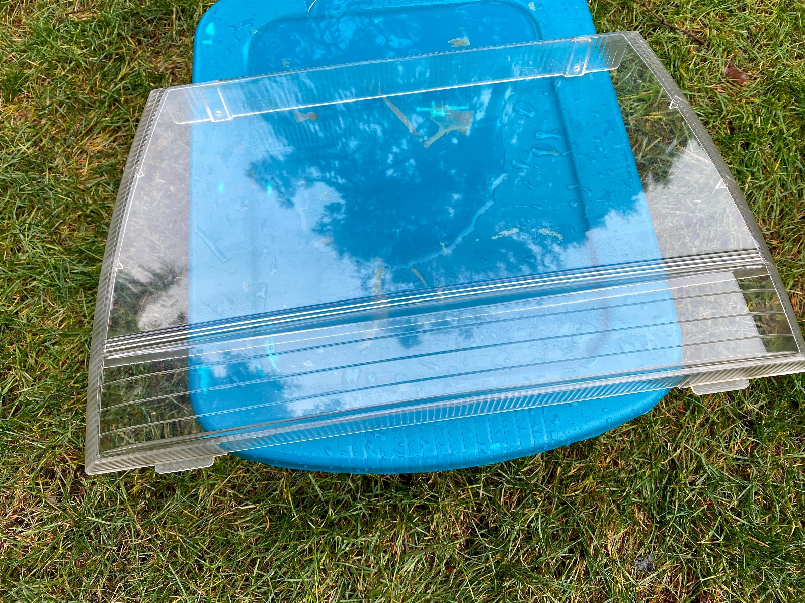

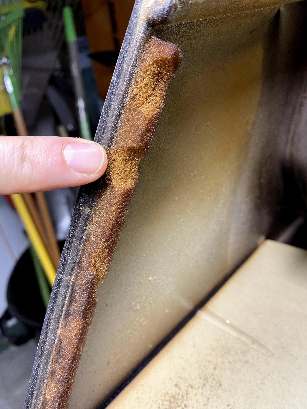

Oooo, interesting. I’ll buy a bottle and give it a shot. Thanks for the advice.Nicotine stains (the brown stuff) come off well with Krud Kutter. Then Simple Green gets the krud kutter residue off![]()
I think it depends on what the stain is from. People used to think plastics would yellow because of smoke when in fact it is now believed to be a chemical reaction to UV rays on plastic. The issue I was having was actually smoke/nicotine/tobacco/tar stains which @ekorz was correct about easily being cleaned up with a degreaser which I'll show in my update today.can the "retro bright" method be applied on the panel's to remove the brown stains? or it's not recommended on these type of plastic/ material?
