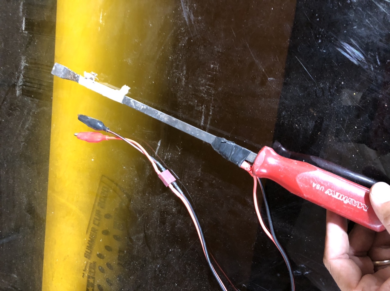

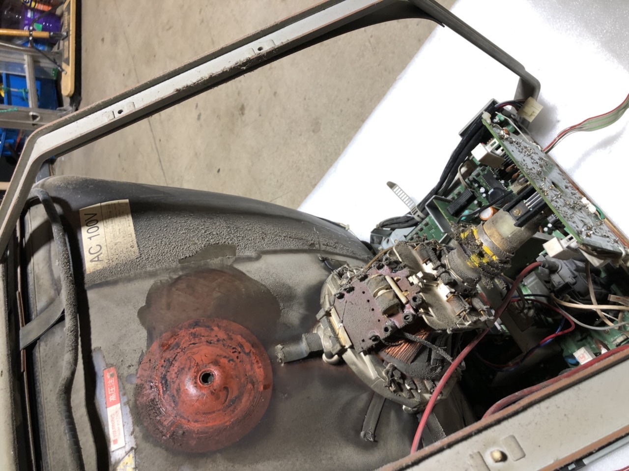

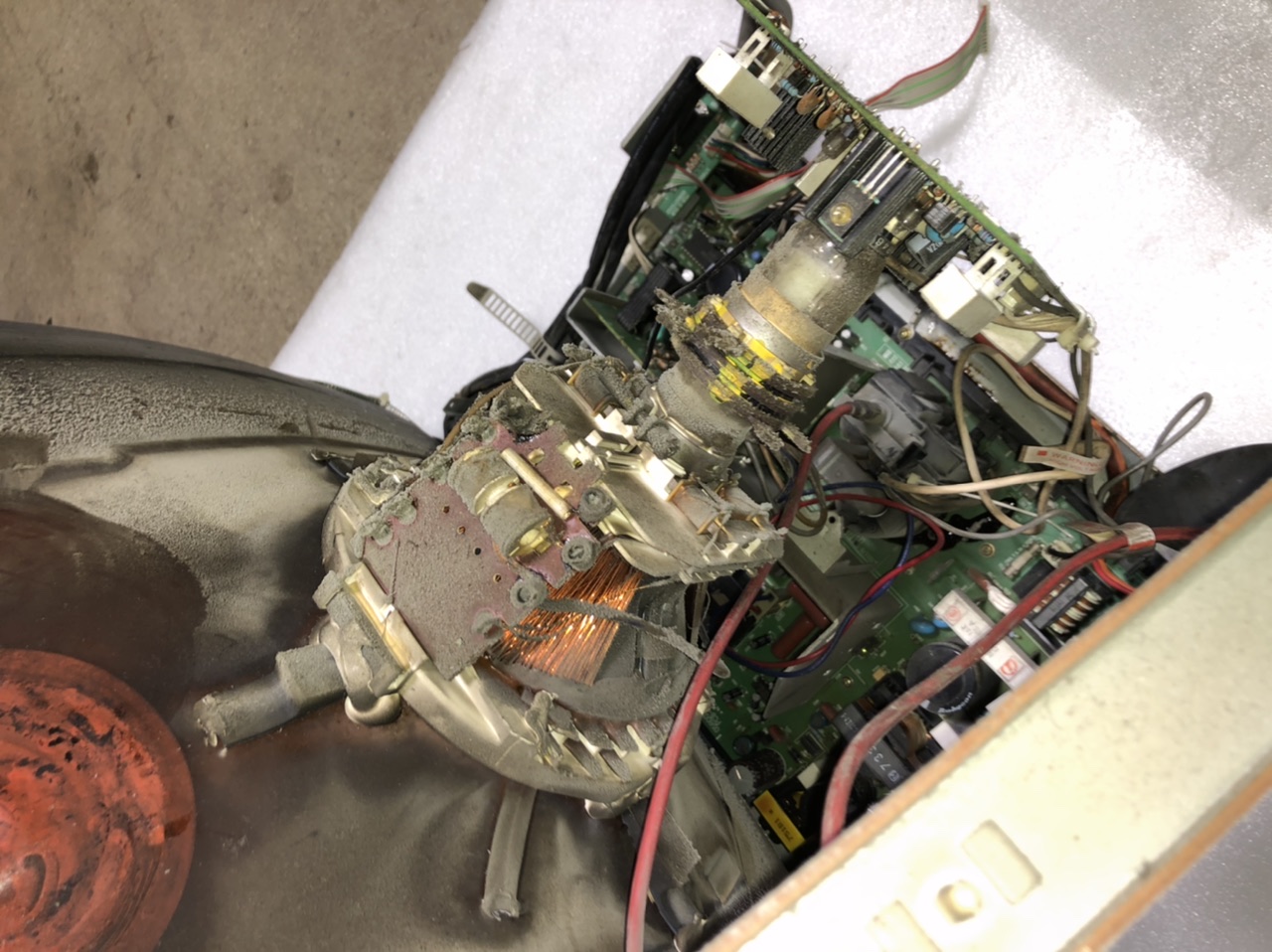

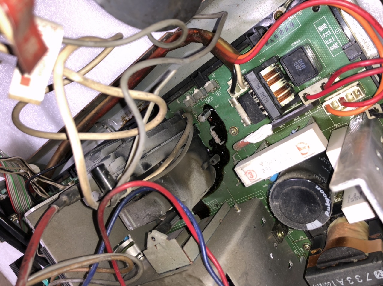

Discharged the tube with my fancy tool and got the monitor out, found the ‘black goop’ I kept reading about.
Going to bring it to PNL tomorrow to get a second opinion on it.

The black goop doesn't do any damage to the chassis. It comes from that coil near the HOT and it typically happens on all the 2930/31 models. It's just showing it's age. If you're going to cap the entire chassis though, you might as well clean it up. You'll have to remove the flyback to really get in there with a toothbrush and isopropyl alcohol
PNL won't clean it unless you tell them to, and I am sure they'll charge you extra for it. They just fix whatever issue you're having with the chassis and send it back.
