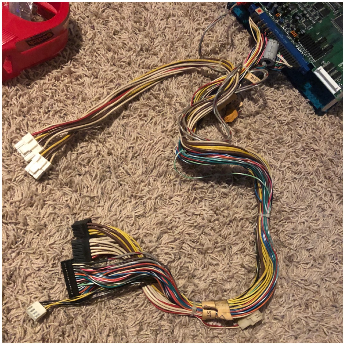

Here is a pic of the CN10 connection. From what I could gather, all of the cut wires were originally connected to the kick harness.
The wiring guide says “to cabinet output harness”
I’m going to spend some
time reconnecting these wires to their original source. After that, I’ll post an update. If that doesn’t solve anything, my bets are on a problem deeper into the chassis.

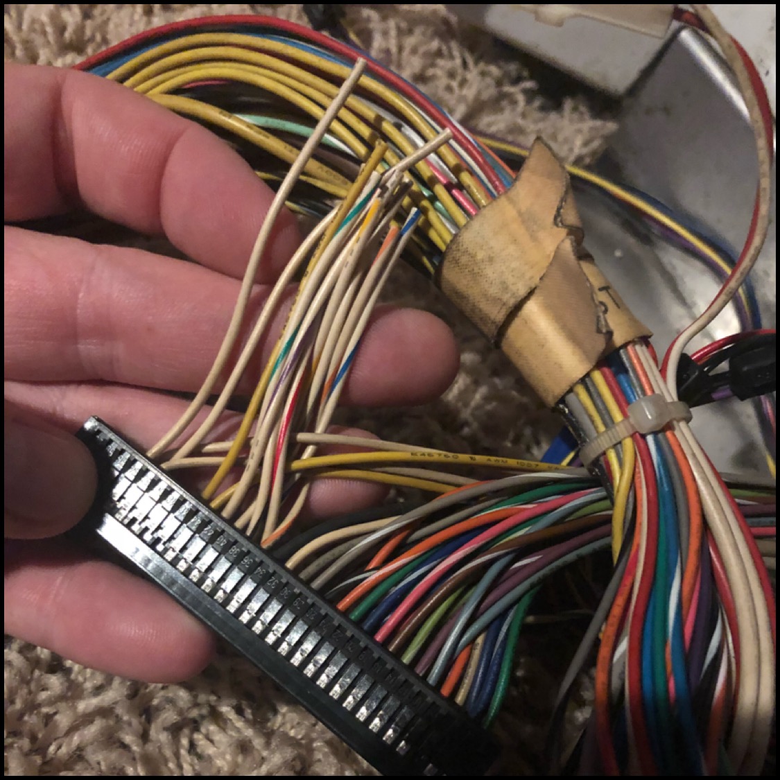

I have a feeling that my jamma harness may be the wrong one for the job I am trying to do. On the blast city wiki, it mentions a model 3 loom for jamma and a 001 loom for JVS. I have the 001 hooked up. Am I possibly going to need the Model 3 Loom to run rgb off jamma?

Remember that some jamma harnesses have the(rgbs+video ground signal) wires directly to a db15 connector. This allows someone to plug in an old jamma board in while still utilizing the db15 connection that inputs to the chassis. Just an extra thought.
That could work. However, I would also need the connections to the blast io as well for inputs. Does anyone make such a harness, or would I need to frankenstein my own?
In the link I added there's a schematic for the rodotron chassis. It is clear from that, that the only RGB connection is via the DB15 VGA connector. If you want to use this with standard Jamma boards you will need an adapter that can plug into this.

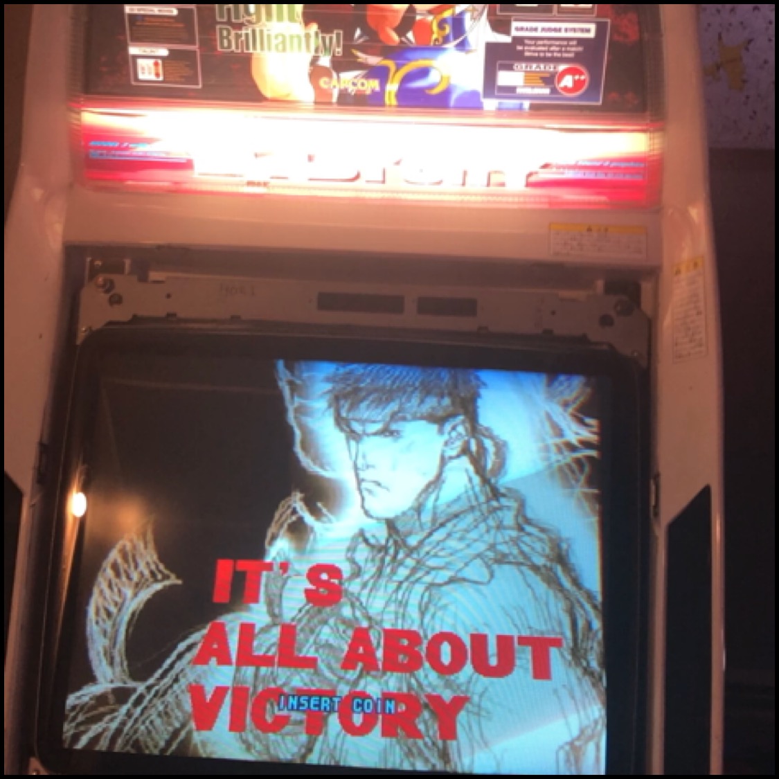

So, progress report:
I bypassed pretty much all of the I/O in the Blast. Used my own power supply to a new jamma loom, and wired up the video connection. Third Strike fired up right away with perfect video. Thanks again everyone! You’re awesome!
