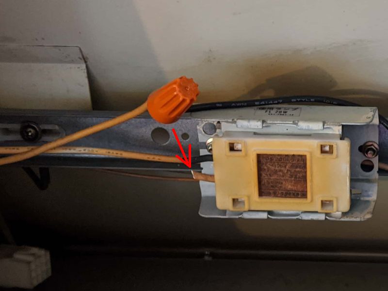

I ended up getting a TOGGLED LED T8 bulb. Can't get it to work, but not sure if I've done the wiring correctly and thats my issue. The toggled says it requires a non-shunted lampholder which appears to be what we have in the blast but not positive.
Here's a pic of my wiring.
Did you cut the orange capped wire from the ballast?
If you did, that's your problem. The ballast is basically a resistor wired in series. To bypass it you need to connect the two wires going to the ballast together.
The wire nut is joining the black and white wires that were connected to the ballast.
I think I found out part of the problem. The bulb I got is a T8, but it's designed to only receive power from one side of the bulb. The Hyperkion that was linked and known to work is powered by both ends.

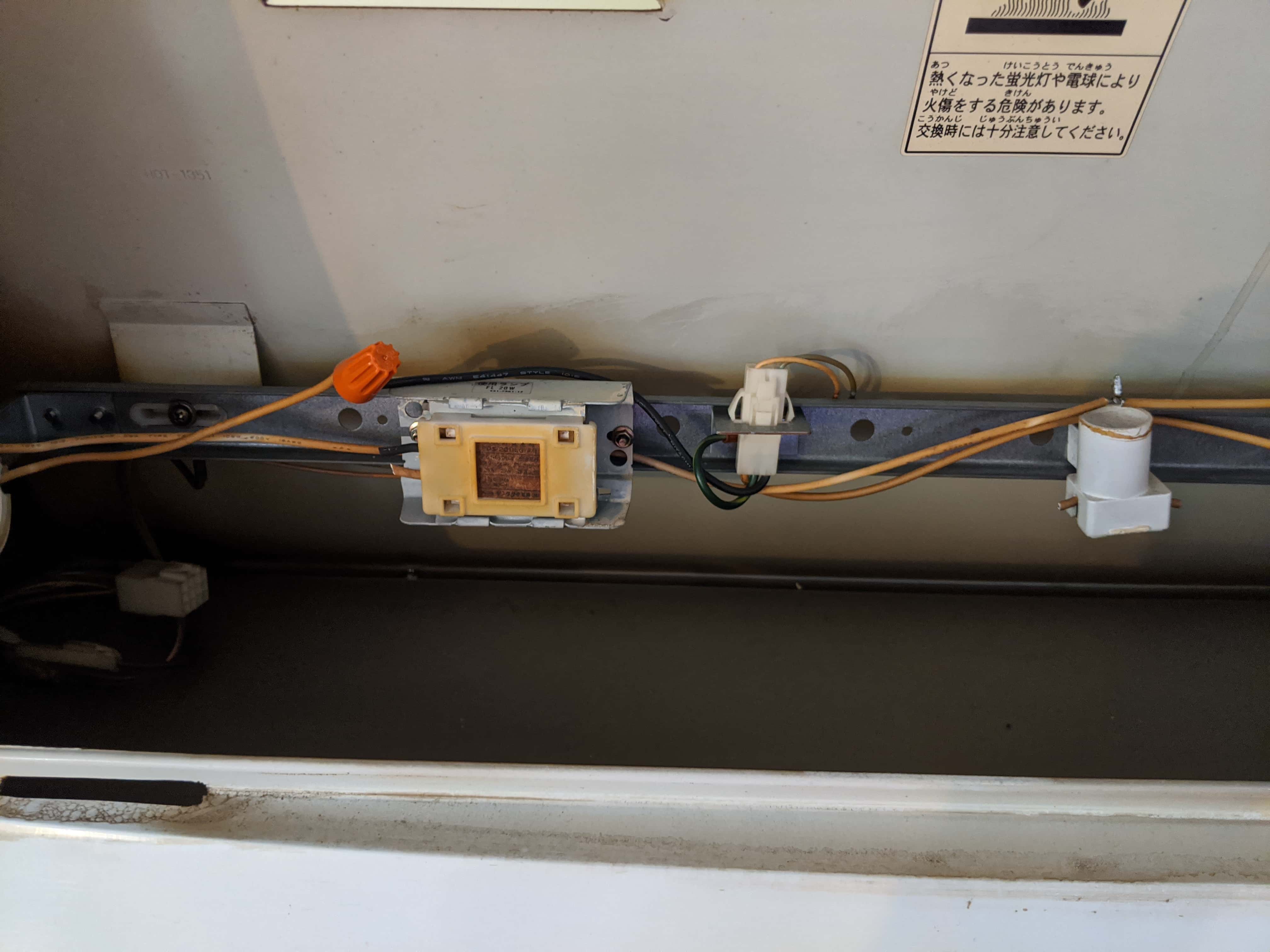

So I ended up just getting a 24" T8 LED replacement from Home Depot's website with free shipping that turned out great. https://www.homedepot.com/p/toggled...near-Tube-LED-Light-Bulb-E208-50310/205622687
It's a little bit of a tight fit, but nothing difficult and I didn't feel like I was straining the fixture inserting it.
It only expects AC power from one side, so the other side basically just has dummy prongs that meant to hold it in place in the fixture. I decided to have the left side of the fixture have power so I cut the two wires going into the ballast, soldered them together, and put heat shrink tubing on them. For the other wire I cut the wire going into the starter fixture and the wire going behind it that connects the 2 ends together, then connected them. Basically AC power is using 2 wires coming into the fixture, so you just want to follow the power input wires then cut and split them in a way that they're only connected to 1 end of the light fixture. I'm kinda under the impression that this is how the majority of LED replacements for florescents are handled. I tried to leave just enough wire left from the ballast and starter that it could be converted back to florescent if I die and some crazy LED hating person wants to 'restore' the cab :P

1.) The wires coming out of the ballast aren't connected to anything and are just tucked under the ballast to get them out of the way.
2.) Both pictures of the marquee off and on were taken with the same room lighting, but the camera just kept auto-adjusting and making the room appear to be dimly lit.
3.) I think it looks great and that the picture doesn't fully convey it. I've never seen an original Blast City florescent marquee in use to compare against, but this is nicely illuminated. It doesn't look dim but it also doesn't look overly bright like if too powerful of a replacement was used. The specs say the brightness is 1120 lumens and the light appearance is 5000K (daylight), so maybe that's a good combination when the tube is frosted.
