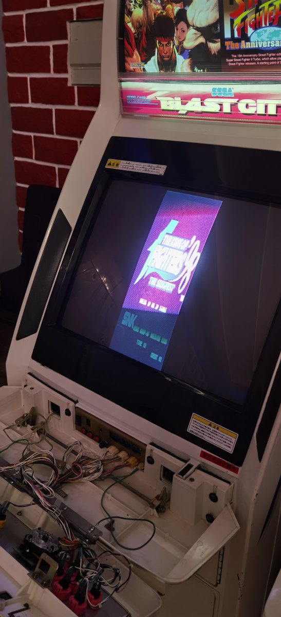

I secured an old Sony Trinitron 29" from my parents house which has two SCART ports. Later on, I immediately made an order of Jamma to SCART PCB from ebay. After putting the parts together I turned it on, and man I got welcomed with vibrant colors picture as seen below in the attachments.
Regarding the original monitor, I left it at electrician's shop who claimed he can swap the chassis with one of his tubes (29" and 27"). I expect to hear from him in few days at which time l'll update this thread.

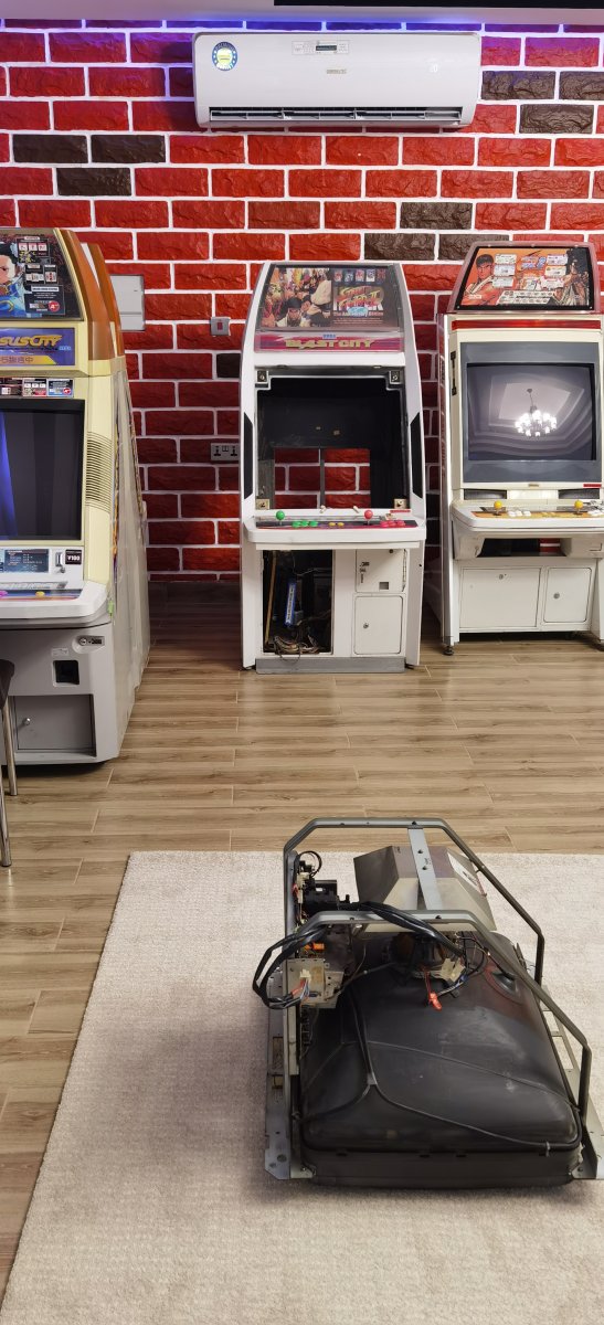

I received the monitor back yesterday. The tube swap was a success and it fit right into the cabinet like the old one. Now I have to adjust the horizontal and vertical sync and as well as the flyback knob for brightness.
