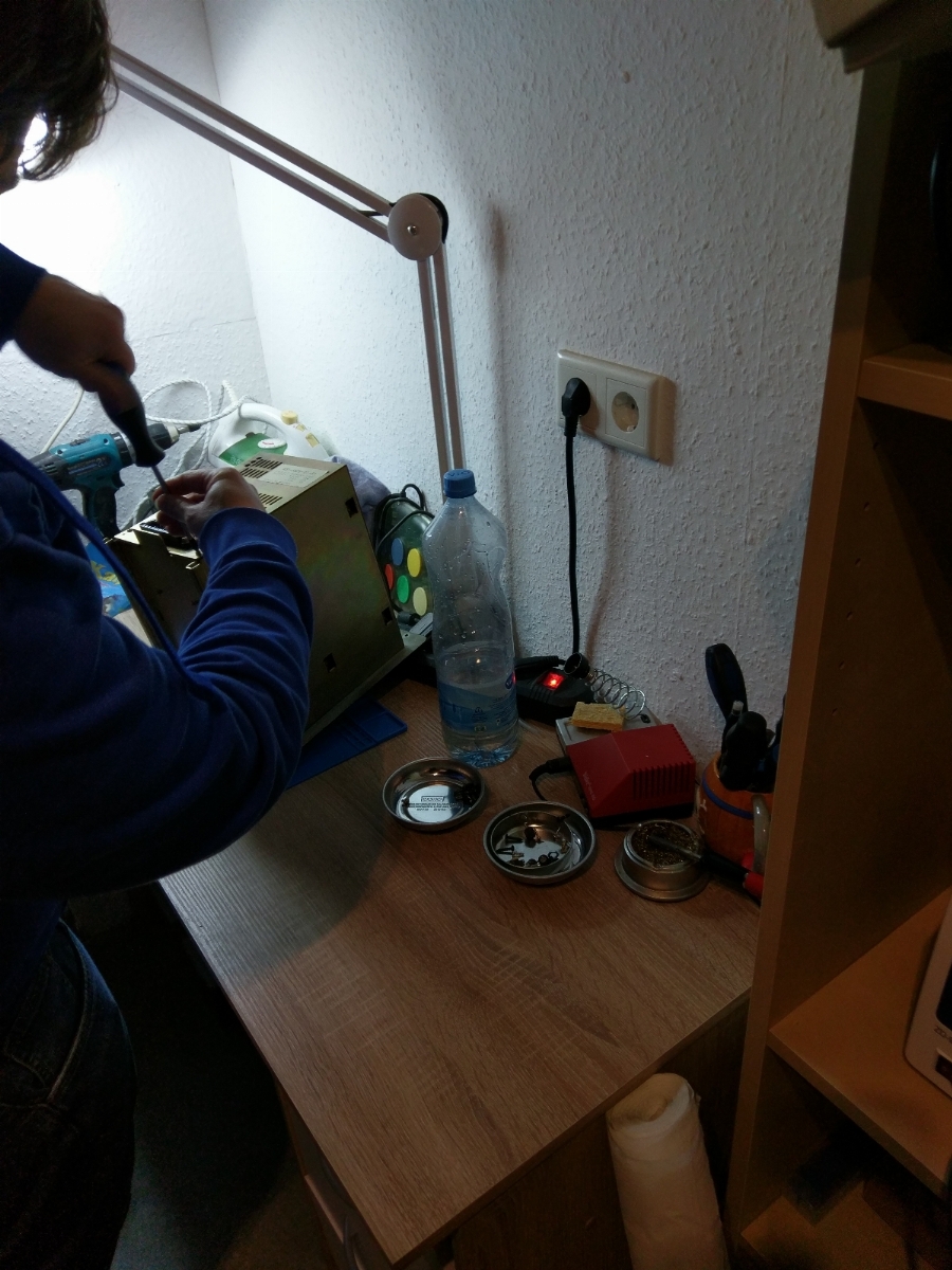

Just Did a PSU Fan "mod" on my Blast's since they were as loud as a starting Plane.
A friend of mine had 2 Noctua Fans lying around so we decided to make this quick modification.
It's very easy to do but can be a very dirty job^^
You just need a screwdriver, a soldering iron and a pair of tweezers.

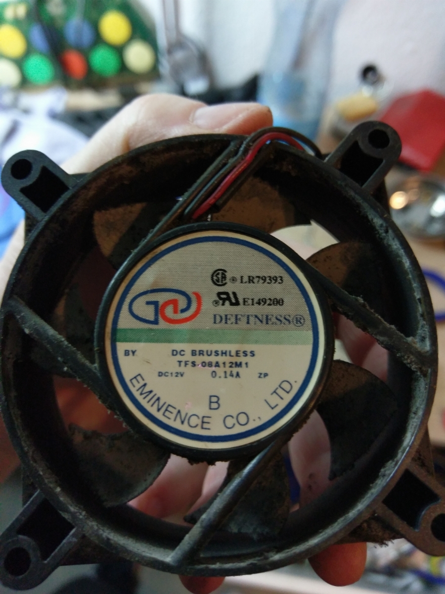

A 12V 0.12 80x80mmx20mm Fan. Get a Noctua, they are totally worth the extra money you spend on them.
I guess you can also do it without soldering if you get a new JST Plug for your new fan.
If I'm not wrong on this one it must be a JST XH 2 Pin connector.

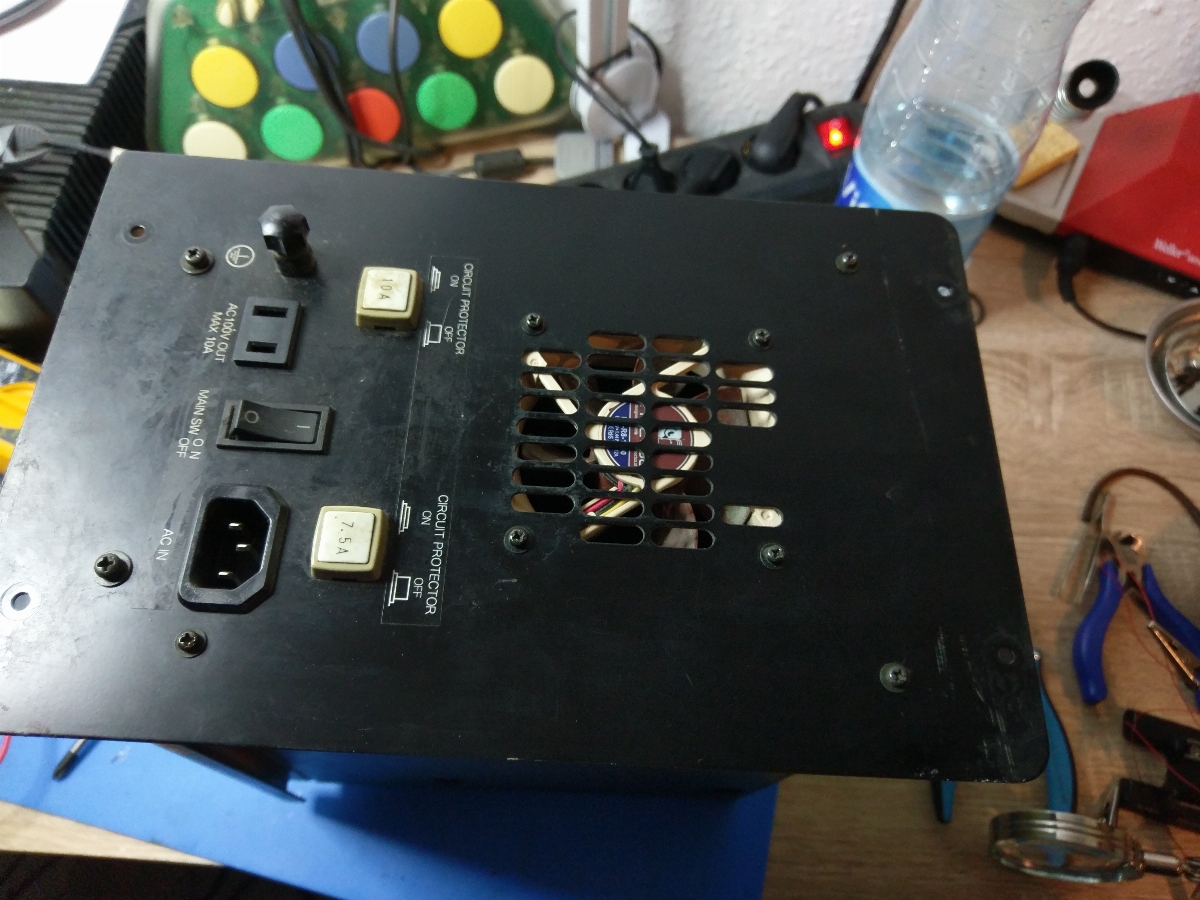

Open up the PSU and clean it first, if you didn't do it yet.
If you have some issues with power you might as well recap the whole thing.
But back to track^^

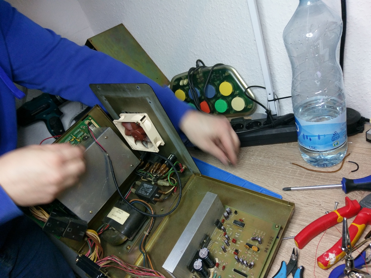

Open up the PSU
Unscrew the ol' Fan
and cut off the JST plug, re solder it to your new Fan
screw it back on and you are basicly done
Reassemble the PSU and slide it back into your Machine.

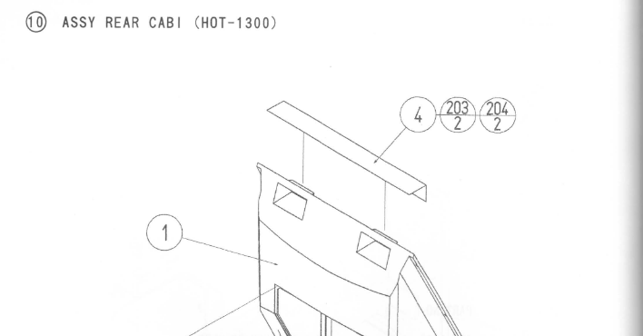

Plus, in a stock cabinet, the marquee area has a panel mounted horizontally that mostly blocks out airflow from the lower portion of the cabinet. The vents behind the marquee area are mostly for the lighting fixture, I'd think.
edit:
actually, looking at the manual, I think this panel exists on my cabinet but might not be stock?? Part (4) in this below image has a plastic sheet glued onto it in my cabinet.
