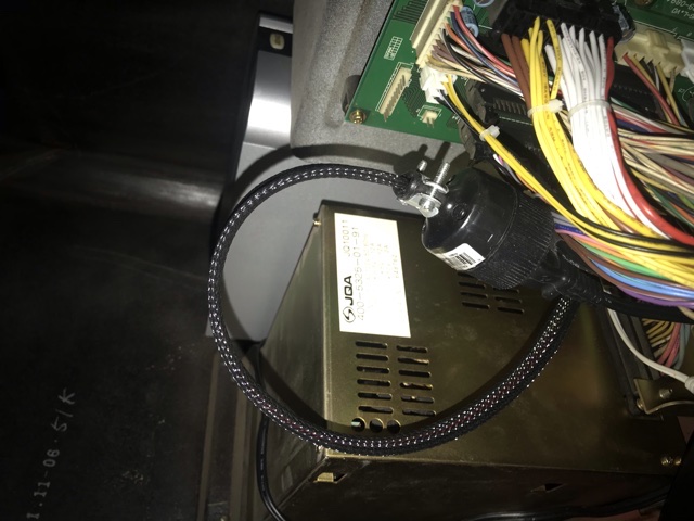

I recently installed an internally powered subwoofer inside a Blast City and will be installing another identical setup in another Blast due to the great results.
If you can find an Ativa D-1051A 5.1 stereo system yo might pick one up. You only need the subwoofer and not the speakers (I found one in a thrift store and another on eBay).
-fit perfectly inside back right of a Blast City (see photo)

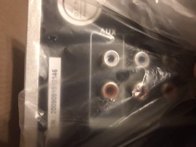

-have regular RCA sound input jacks so it is super easy to split/duplicate your stereo line and plug in
-is self powered for good bass
-has a remote with full volume control etc
I am using Lemony’s I/O to AC plugs so it is easily powered inside the cabinet (shown held up in first photo).
