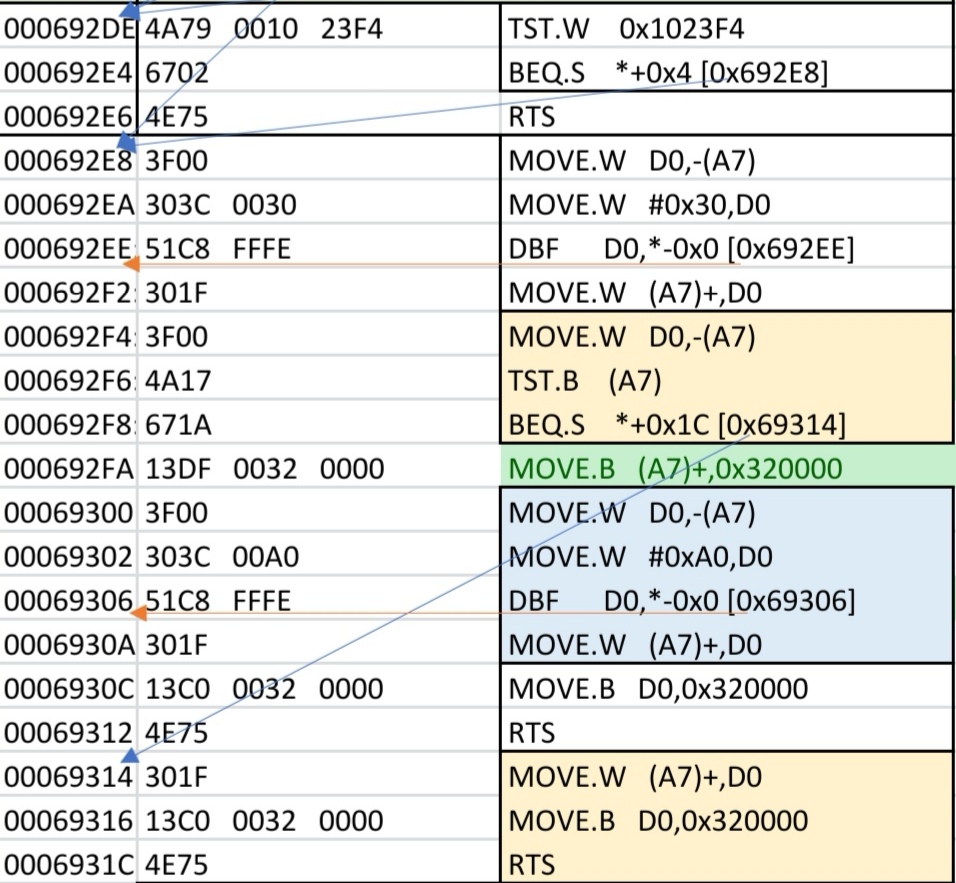

@kuze I took a look at the 68k code, particularly at 0x692F4 to 0x6931C. It is indeed a little unusual.
Were you examining this area too?
I note that the tail end of the "BONUS!" sound is still in the modified V ROM. You can check with the Universe BIOS Jukebox, ID# 7A0. This sound clip plays a string of sounds separate from the other sounds. I'm not too sure why this distinction was made, and why it's processed as a string of sounds. They might be ADPCM vs FM sounds.
I contemplated locating the Z80 code to reduce its volume but then decided to go the 68k route.
I've found the 4 separate subroutines that end up playing it.
SR1: Red pick-up (shot power-up), if Power gauge is maxed, subsequent picking up plays "BONUS!" instead of "POWER UP!"
SR2: Blue pick-up (bonus points), always plays "BONUS!"
SR3: Orange pick-up (Co-op mode only: attract enemies), always plays "BONUS!"
SR4: Green pick-up (Co-op mode only: 'stealth mode', homing enemies do not target you), always plays "BONUS!"
I'm looking to replace the Blue, Orange and Green pick-up sounds to other bleeps/tones, while leaving the Red pick-up to still play "BONUS! on subsequent pick up. That reduces it significantly while retaining some of it where it logically makes sense to play. No gameplay or scoring code is touched.
