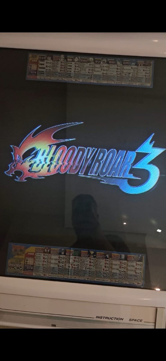

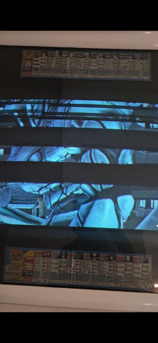

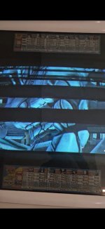

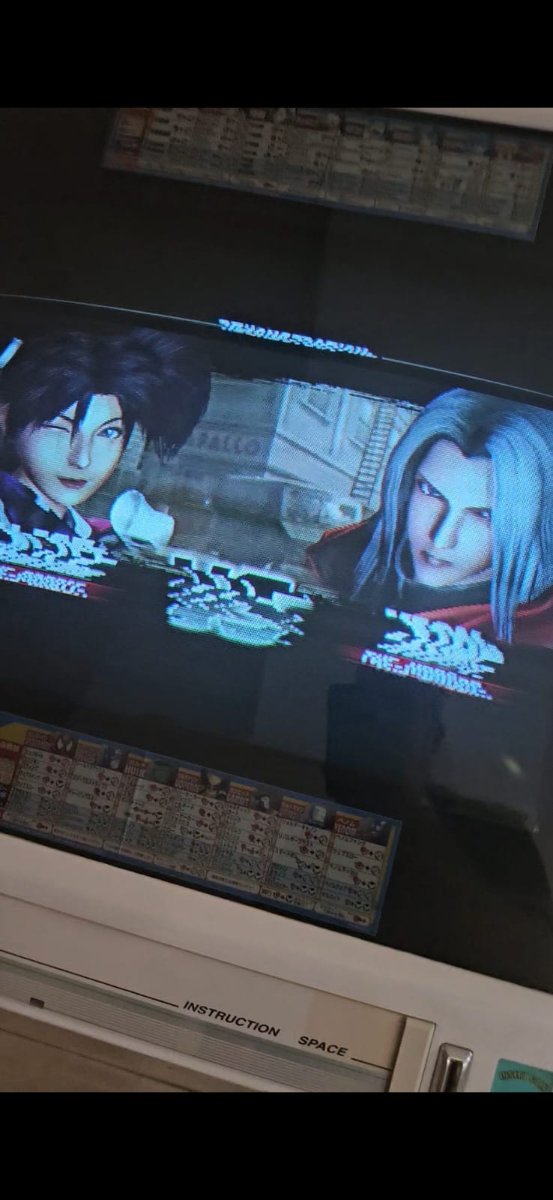

I'm using a Namco System 246 chassis B. I burned the CD at 9x. It boots without any problems, but with image issues. Does anyone know what could be causing this? T It only happened in this game.

Looks like a sync issue, the system uses C sync so check your wiring and also check that the PS AV cable is connected properly in the system
I have already changed the IO board and changed all the cables and the problem persists. :(
Bloody Roar 3 only outputs 480i unlike most or all other 2x6 games that do 480p.
