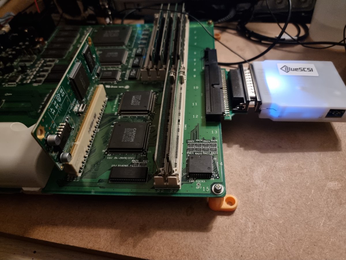

Bluescsi works fine here. Got this going myself only a few weeks ago. I tried both 50pin desktop with cable version and the smaller 25pin variant with this adapter:
https://itead.cc/product/scsi2-50pin-to-scsi1-db25-adapter/
Both worked great but the small 25pin was very neat.
Copy the iso image to the sd card, name it appropriately so bluescsi knows it's 2048 sector cd (e.g. CD10_2048-CPS3.iso)
End result:
