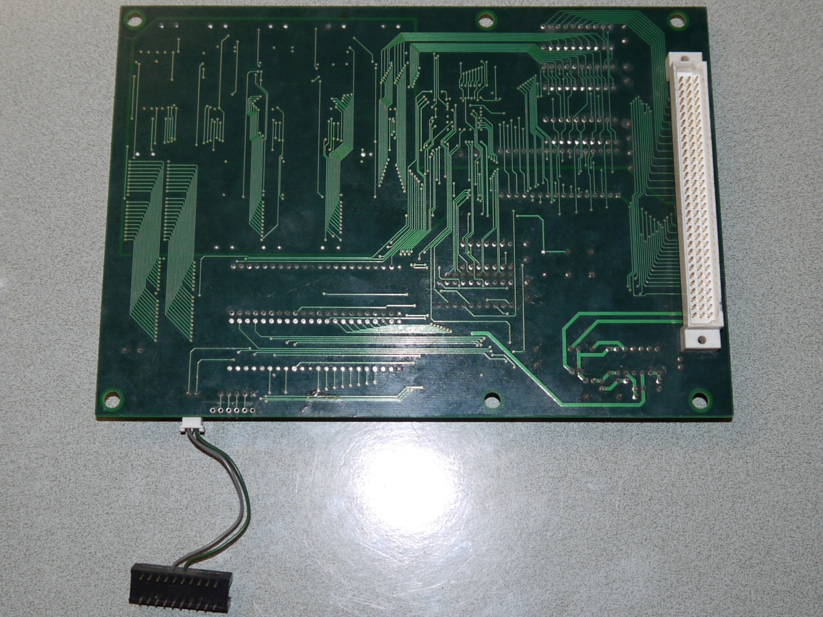

Here's pics of the board:
The AT89c4051 is socketed and I have it in my programmer's device list, however, reading it I just get 4 KB of FF.
This one is slightly different to the one i've seen, maybe yours is an older version:
http://www.happy-manor.com/itm/459260/71605/Arcade-PC-Board/KONAMI/Bloody-Roar-II-PC-K106
Bad news about the surface mounted rom, your one has some of the program in the SMT MX chip instead of 2x 160's.
The 27c160 in the socket should be dumped anyway, maybe Coolfox or someone will be up for dumping the tricky one (i have no adapters).
Looks like the atmel has a security bit, that's a bummer.
Good news is that it's spoofing the security using only 2 wires?!?
And the atmel looks like it's controlling the OKI. and not the protection?
Maybe it's simpler than copying the chip anyway.
With a hack that simple it's more than likely a code patch with the bare minimum connected in place of the chips for the board to function.
Has the mainboard surface mounted bios been changed?

The protection in the ZN platform is a serial bus so it's not surprising that only 2 pins are necessary.
Yep and it's in use directly by the atmel quad and that's a shame..
So traced out the cat 702 on a pcb.

that makes the signals b21, a21, a20 and b19
seems right as 5+7 are connected to the base board on that bootleg.
I have studied the picture a little better and it looks like the 2 feeds are going into the atmel quad.
It also looks like the edge connector signals are going directly into there too.
What is the chip code on the atmel? More than likely secured up anyway like the first one.
Hopefully the last rom contains some meat + potatoes, otherwise reversing this one is a dead end.
