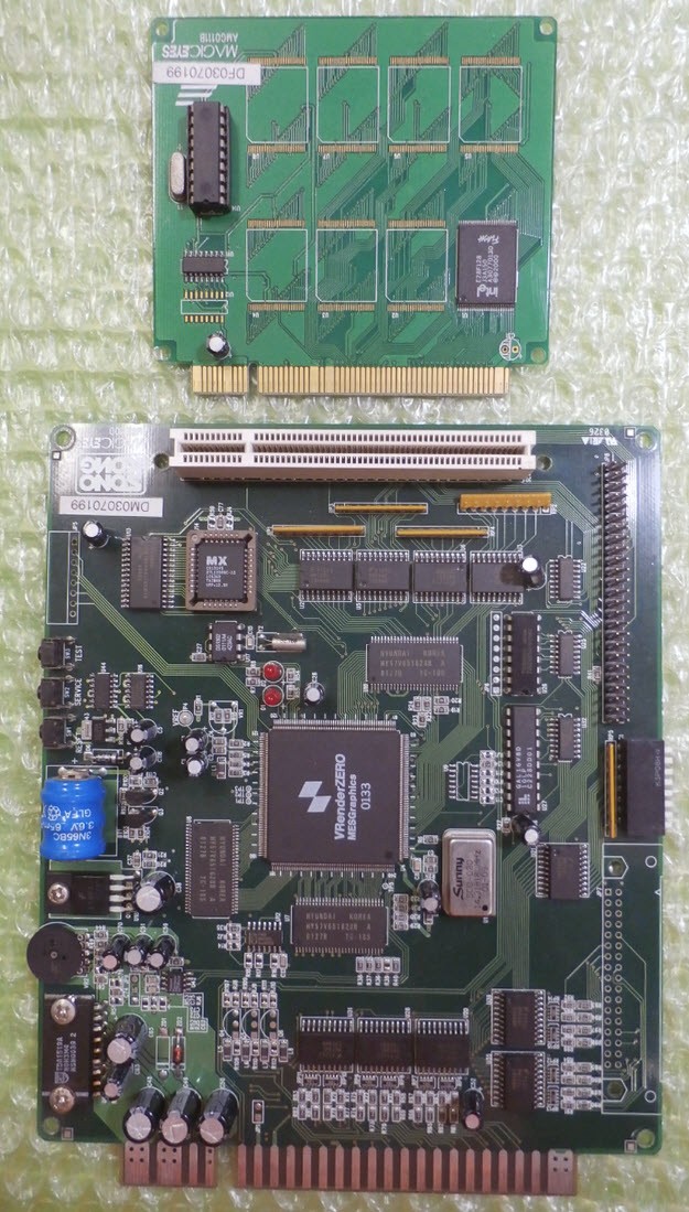

Been away for 6-7 weeks now, was only supposed to be gone 10 days... sorry guys, some very abnormal events occurred. I am okay, spent the last week reintegrating. Got on discord a couple days ago, was given the heads up about the concern from this thread. Figured the best way to get back in the saddle is to come at you with this:
BCS Multi Cartridge Features
- 11 Predefined ROM slots
- 384 MByte of Flash storage
- ROM slots: 1x64mb, 3x48mb, 4x32mbyte, 3x16mb
- Cartridge firmware can be updated (microcontroller + cpld)

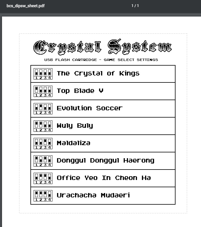

DIP Switch Printout
Go to File, Export DIPSW PDF -- This will generate a PDF for reference on which roms are programmed to each slot.

The PDF Output feature of the software is a real nice touch.

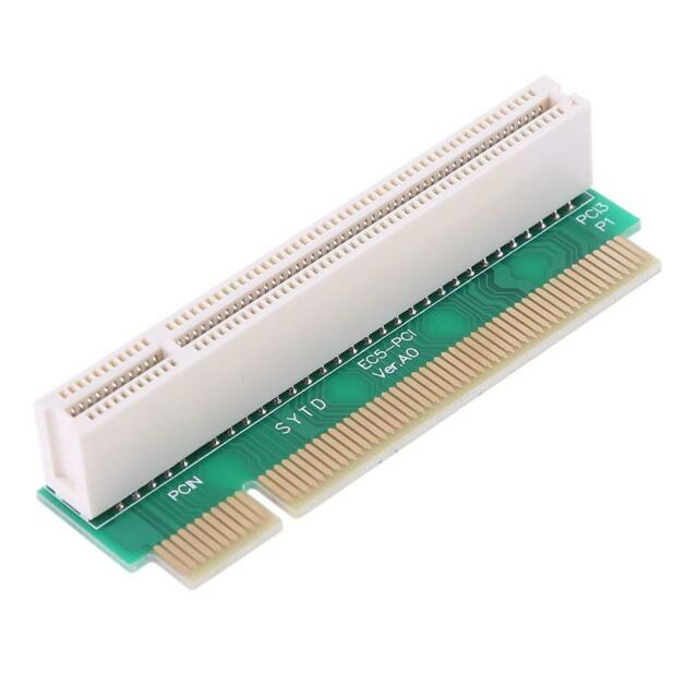

Anyone know if the card slot something off the shelf? Would be cool to make some right angle adapters like this https://www.mvs-scans.com/index.php/BCS_-_Slot_Board_AMG0107B
Nope, according to @brizzo VCC/GND lines need to or should be fattys :)
so something like this would most likely not work, plus might not have all pins connected through
Plus the cart might not clear the motherboard, we would need to have the riser fabbed.
And 3D printed supports for the multi and the riser as well.

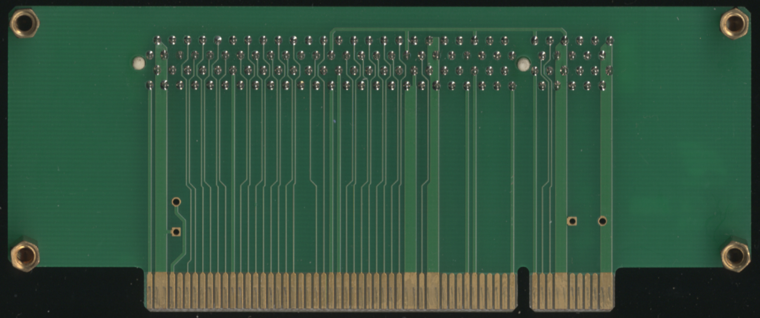

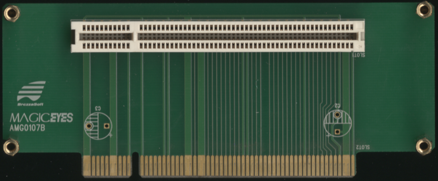

Im working on a plexi shell case as soon as I get the MB in. The shell/riser setup that comes with these are garbage.
I think it was PCI:
The cart connector is in fact PCI, but I don't think this solution would be very practical for the flash type. I'm assuming not many people have a DIP48 programmer that supports J3 algorithm, along with solving the socket/adapter pinout for each programmer to be compatible.
Post overlap:
Should be relatively cheap to design and make. PCI connectors are readily available ( https://www.digikey.co.uk/short/z8qcf9 ) and it would just be a matter of laying out the pcb.
Should be relatively cheap to design and make. PCI connectors are readily available ( digikey.co.uk/short/z8qcf9 ) and it would just be a matter of laying out the pcb.
That would be ideal, and would super easy to put together, pcb/pci connector, solder bath done :D
