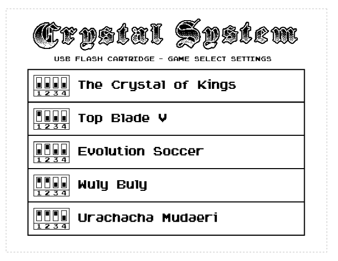

Wuly Buly. Level one (far left) is you stomping roaches, using A, B, C buttons. Seems to work normal. 3rd game, far right, is clicking the correct button based on what is in the box at the top, but mine is far too fast to play.
Does anyone have a cap map for the MB? I think Im going to replace them. Also need to clean the volume pot otr replace it, mine seems to be a bit scratchy, volume adjusts fine though.
As you guys are getting these, do you mind checking this one game so I can pin down if my mobo is bad or if the ROM of the game is acting up?
Mahalo!
Ok, so am I crazy or is that too fast for you too?
I need to double check mine now, I think it’s even faster.
Haven’t tried it in mame but that is impossibly fast imo

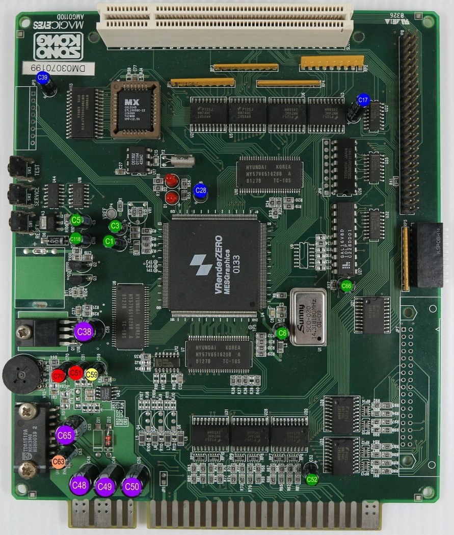

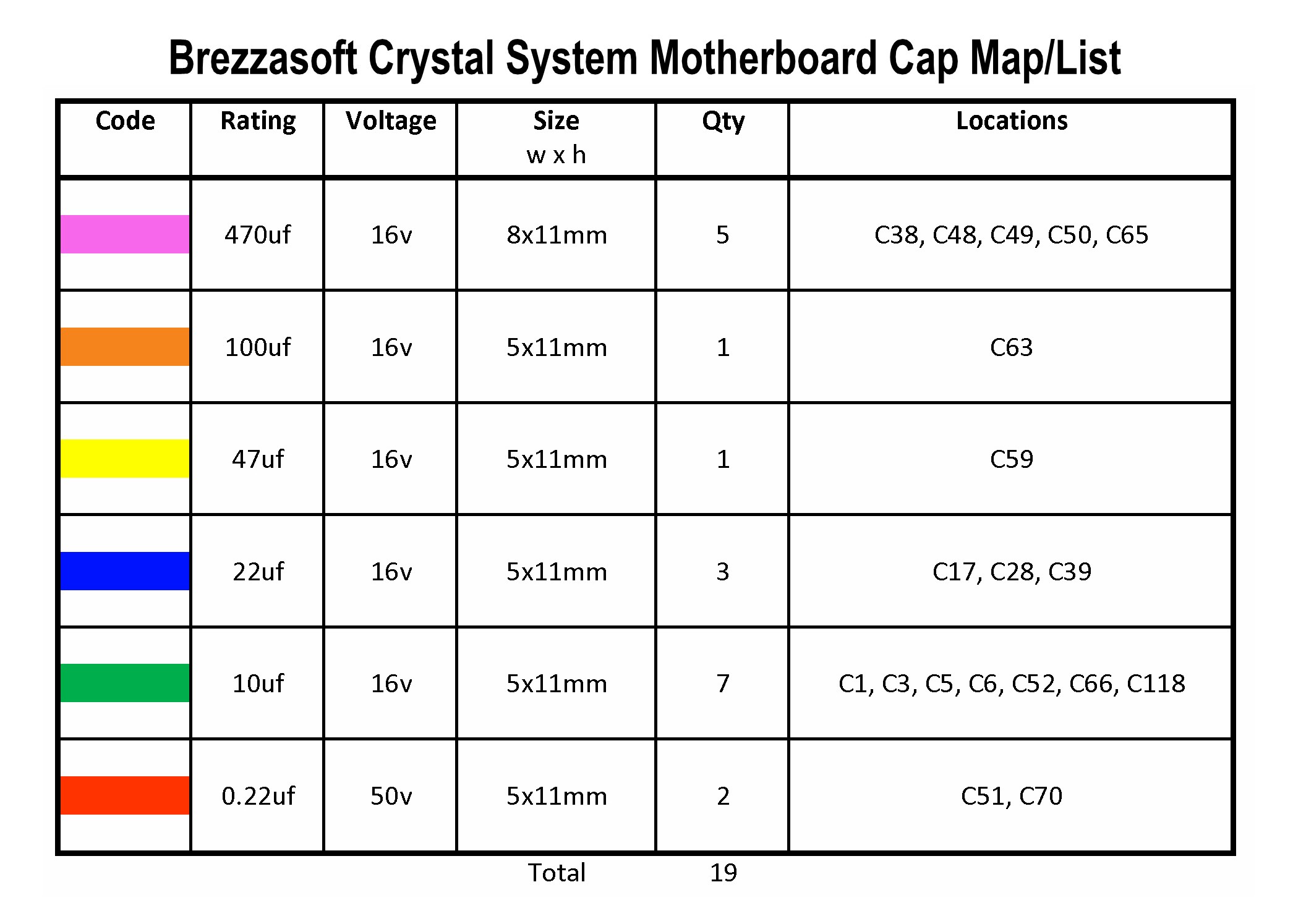

Made a quick cap map/list for the motherboard.
Anyone care to confirm and/or make a BOM for digikey/mouser?

@Derick2k I think there are 2 motherboard revisions but I’ll check out the caps on mine later tonight
