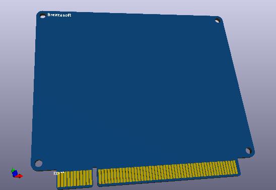

Quick and dirty outline and connector:
... based on a scanned picture, so most likely miles off. Though if someone gives me proper measurements I can plug them in.
If someone wants to compare it against a real cartridge I attached a pdf to print out. I made no effort to align the connector with the outline, or to add the double-wide pins for power.
Edit: By the way, the spacing looks a bit like PCI. Do these cartridges fit into a classic (3.3V) PCI slot? (I mean physically, not electrically! Don't switch on a system like that!)
