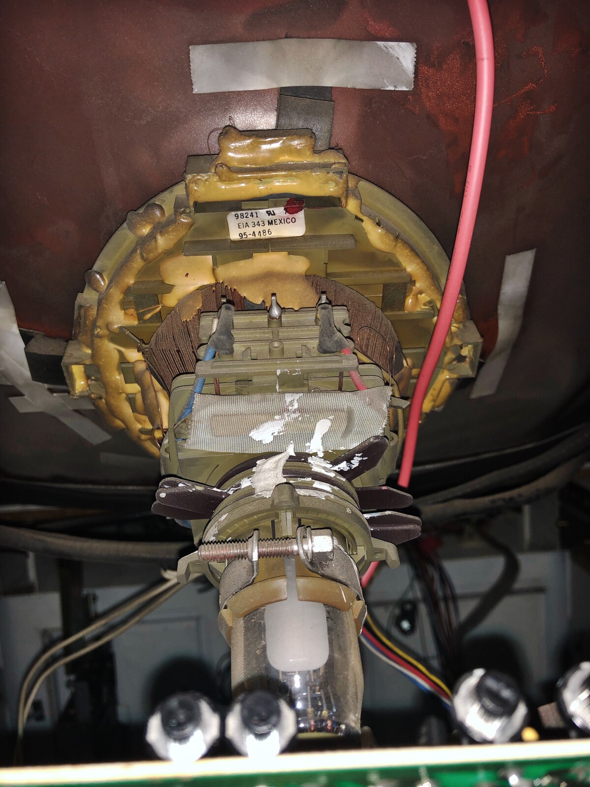

Try aligning the yoke,but only if you know what you’re doing be really careful
I’m almost sure the yoke has come a bit loose and that is why you can’ Degaussed it
Had same issue with my capcom impress,and was fixed by centering the yoke

I have absolutely no clue what I'm doing as I never did it before, but I've been reading and watching Youtube videos about yoke adjustments and related operations (purity and convergence) for the past few days :P I wish I had access to a pro to teach me and help me tinkering with it, but I will just proceed carefully.
Kinda hard to work inside the Kyotaro as there is not a lot of space though, and the monitor does not have a mechanical chassis to help handling it out of the cab, so I'm super hesitant to remove it. But Like it took me a while to discharging it, I will end up doing what is needed after continuing to research a lot and understanding how everything works :)
Looks like a mechanical issue, not magnetic. Watch and rewatch that video I posted earlier.
Hehe yeah I did a few times and a few others as well :) Also the guide from Ingvar Karlsson. Good to confirm that it might be the issue, probably going to attempt something soon, thanks!

Anyway, your pic looks like a purity issue to me. Honestly, playing around with yoke rings isn't that bad. Just mark the current positions with a white marker and then you can always revert back.
It's not a yoke alignment issue, because your convergence looks fine.
Personally I wouldn't try to do it from inside the cab. It's an accident waiting to happen. You should look for a K7400 frame to bolt that thing into.

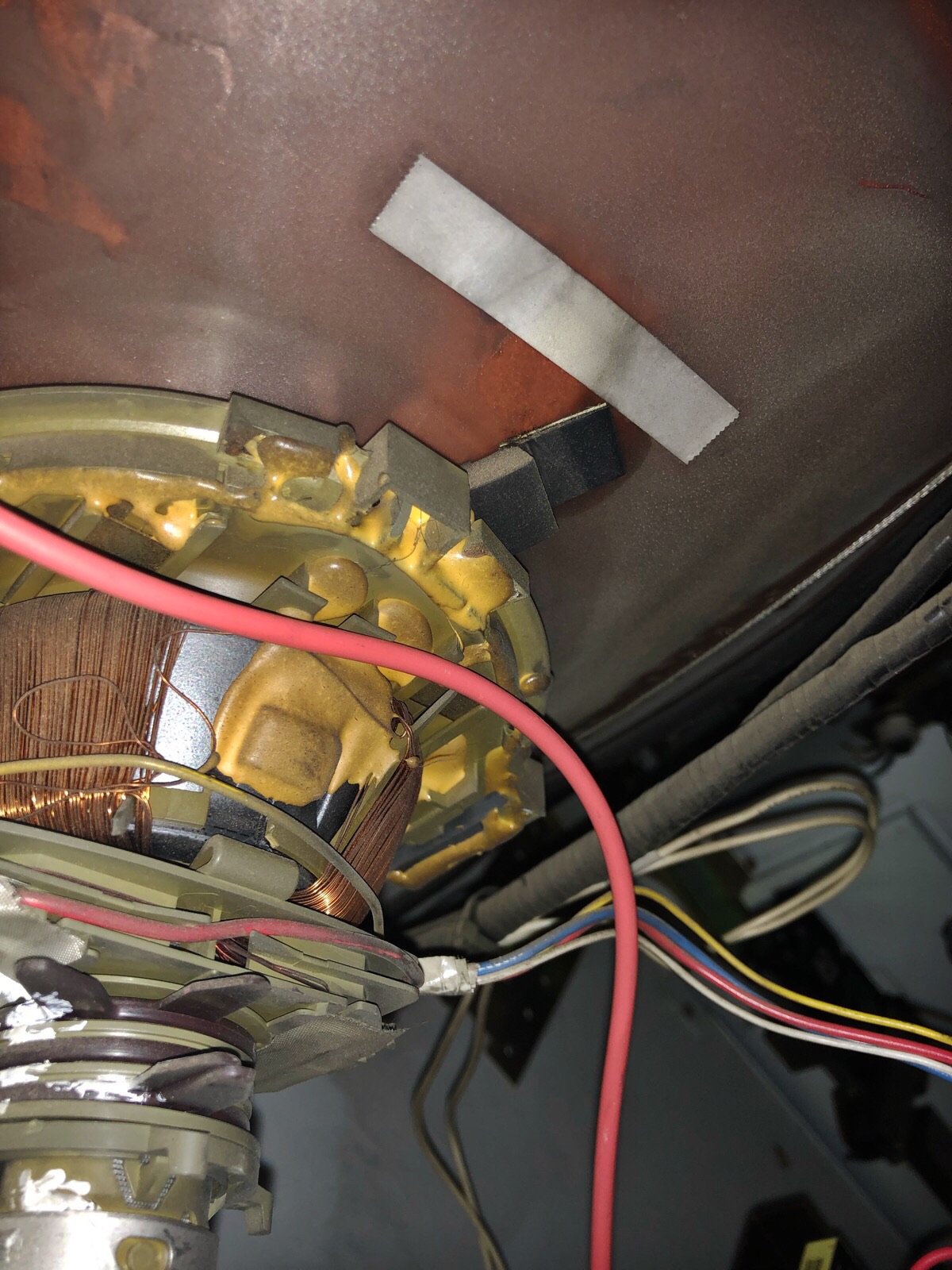

Almost seems like a single yoke wedge got knocked off and if replaced would fix his image.
Funny you’re saying this, and I did notice one of the wedges was not where it was taped when I got the cab.
Maybe I should try to wiggle it back. The tape seemed recent so I assume it was placed during a maintenance, and maybe moved at some point.
That should fix your problems. Wedge it back in there for now. Tape it down after the issue goes away. Do it while off and discharged to be extra safe.
