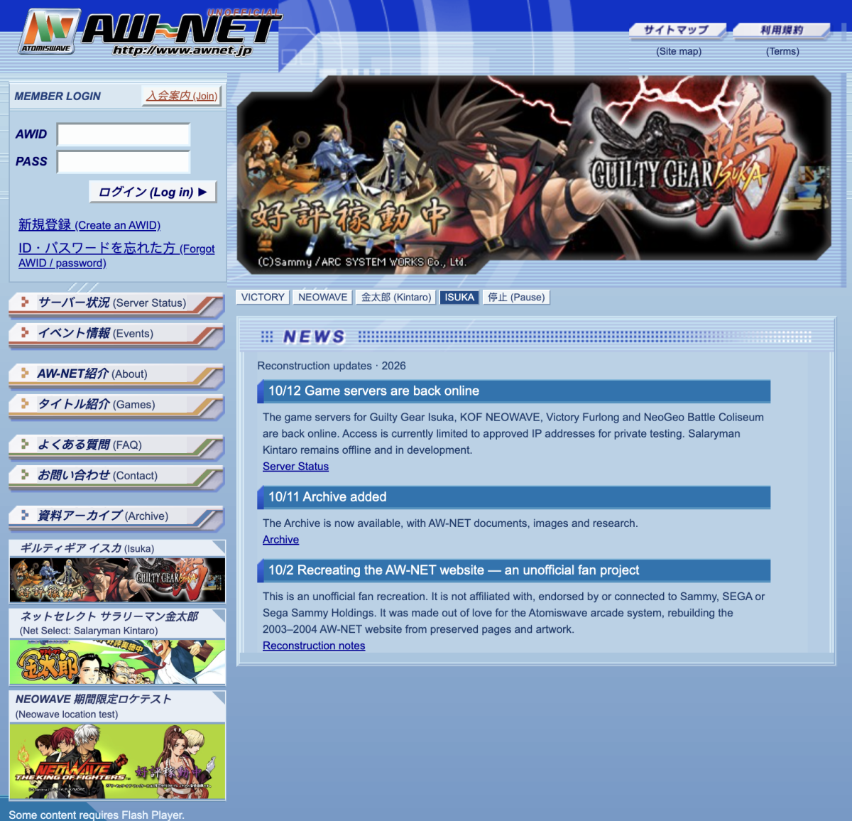

I got lucky and saw the domain was free so I registered it. https://www.awnet.jp now hosts a recreation of the original site from 2004 plus an additional archive of all the stuff I came across in my search. The website might get me a C&D but it's almost completely 1:1 from back in the day for now. Recreating the site was one of the most difficult parts of the project.

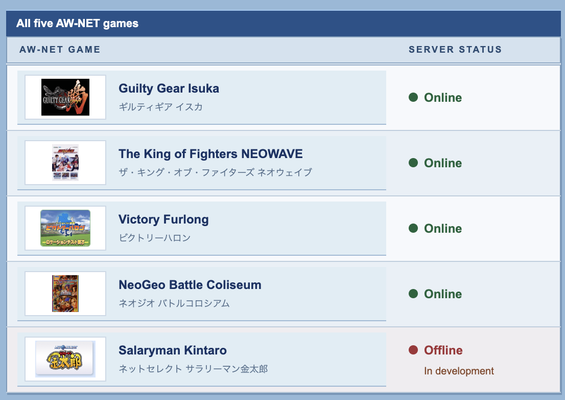

All game servers are functional (except Salaryman Kintaro). Victory Furlong has the rolling horse unlock system, admin organized tournaments, prize boxes, and nearly everything from the original servers. Those statuses are actual health checks reported by the servers.
