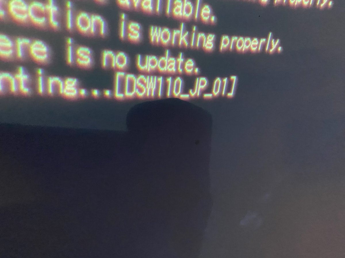

A fix option is to use a "reset" usb key that will restore the VHD. What version do you use right now ? You can see VHD name in the blackbox at boot (Loading game image [XXXXXXXXXXX]).
I emailed Namco, but the repair turn around was way too long involving sending the machine over to Japan and back. the cost of the repair crazy also. just got in contact with someone local that can sort it out for me. Thanks for your help :)
