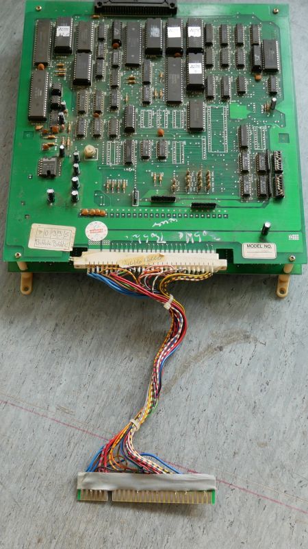

Got this BB Bootleg;
I think its not Jamma so where can i get the adapter for it?
one more thread hijack:

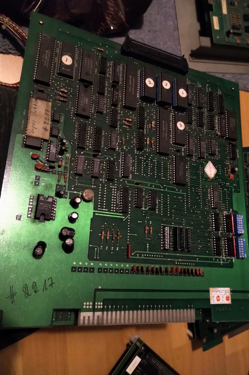

So I played the game and around level 46-50 the game resets.
Played it again and twice in a row, resets again.
"let's check the upper half of the roms?" I thought
then I see this
fine! let's remove the sockets, clean and put new sockets
start the game, hey it still works ! always a good news to not have introduced more issues!
play again ... RESET :(
I see more bad stuff

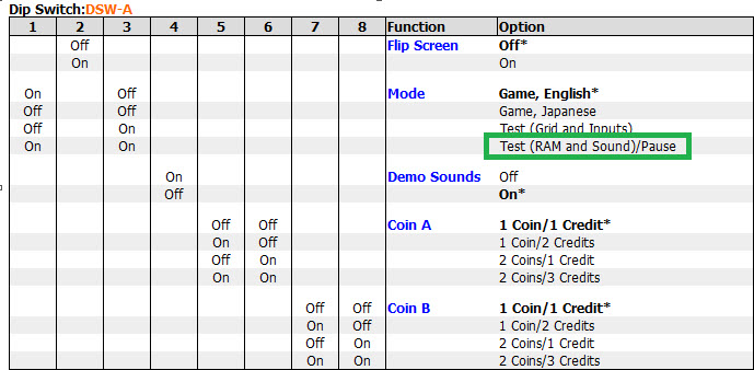

to which point I am like ... wait isn't there a ram test or something since I can play half the game right?
I look it up and yes:
it runs a white screen and plays the sounds... and that's it.

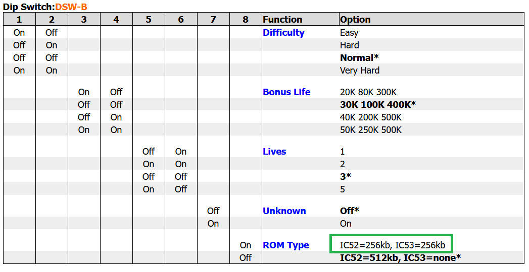

and then I see this one
yup. 256kb is indeed half of 512kb !
turned the dip to on and made it to level 60

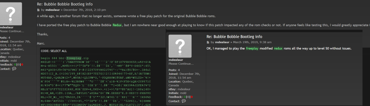

re edit: found the the free play patch .... which is a patch of a patch ... and made by a guy I know! small world! and he said he tested it to level 50 ... so yeah, they are suspect #1 !
