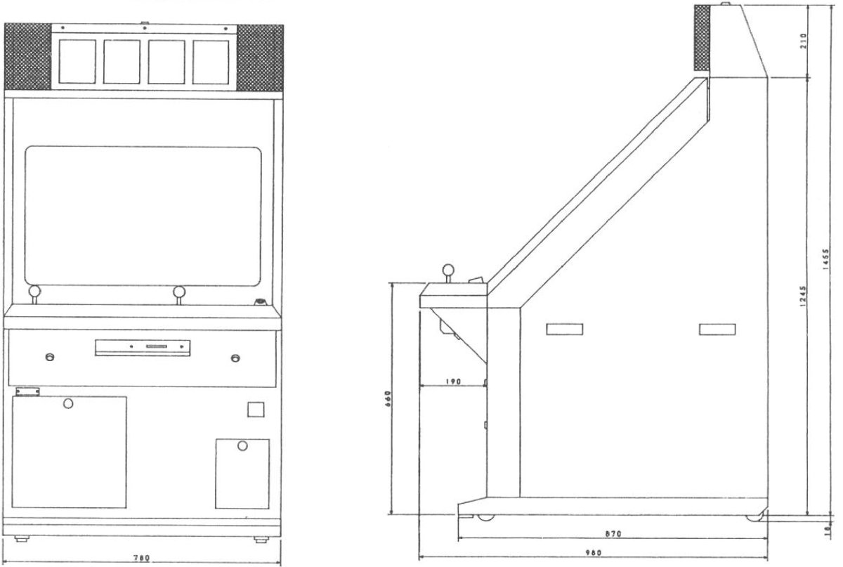

the MVS-Ux/33 series are what I want. The manual also has all the measurements:

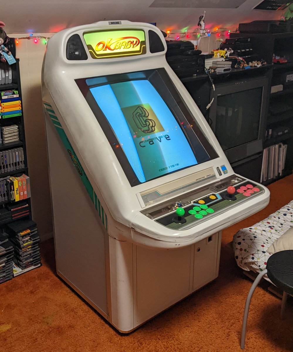

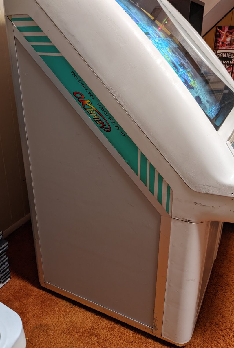

I have what I assume is an original OK Baby cabinet where the bottom half is made out of wood and vinyl wrapped with a metal frame holding it together. Maybe you could take this approach?
I think this particular cab had some major body repair done to it. An OK Baby didn't mix wood and plastic construction afaik, although it's been several years since I last saw one in person.
Oddly enough, the OK Baby is most likely a clone of the Tecmo Kyotaro Excellent, but the regular Kyotaro (non deluxe non Excellent) did feature wood in the construction of the body.
I've thought the same as I've never seen another one like it but there's no way someone made this by hand, it has too many details in the construction.

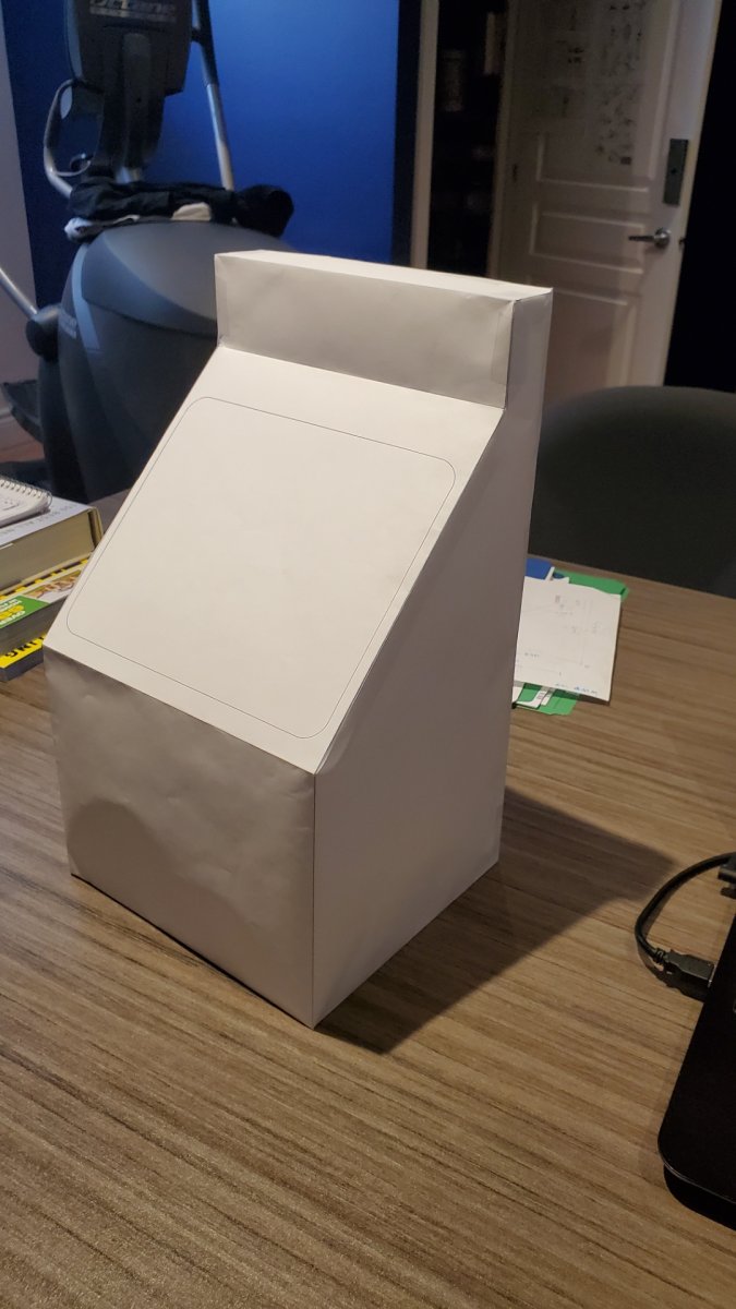

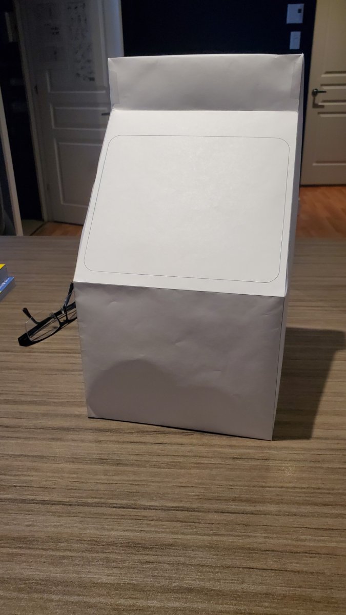

So more talk and financial details about this tonight:
With just the cost of Metal, metal folding and powdercoat, we are at close to 3000$ canadian.
Lets say that’s double my initial estimates.
And we have done nothing yet.
Going to sleep on it 😑
