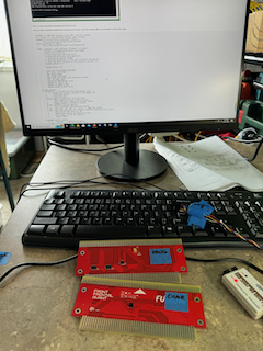

I have assembled the boards, need to upload the .jed file to the CPLD. The CPLD is a Lattice LC4064ZE and I have... absolutely no idea how to do this.
Its not often that I'd so stumped that I dont know where to start, but for this one - I got nothing.
Is there a kind internet friend who can point me in the right direction please?

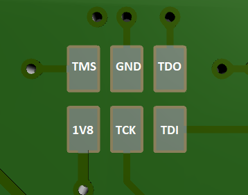

https://github.com/neogeodev/FusionConverter/blob/master/fusion_vsense.svf
Borrow the pin assignments from here to attach it
https://www.arcade-projects.com/thr...lled-11-13-waitlist.27699/page-39#post-446363
AD0 = TCK
AD1 = TDI
AD2 = TDO
AD3 = TMS
GND = GND
VCORE(which I assume is 1.8v) = 1V8
