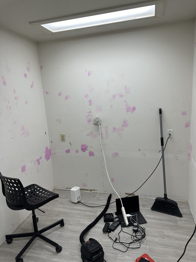

It's time gut the place. You can see the previous damage from the built ins. the Ikea desk has got to go too.
I dragged my linoleum outside and traced it with a baseboard

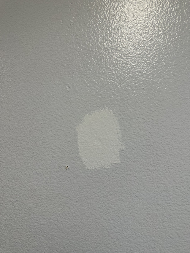

LOTS of spackle was used in creating this room..

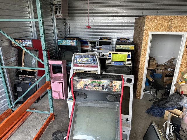

Well Its been a fun last couple days. I got to meet Retro Perception in Seattle. One of the best CRT technicians I've witnessed, and it was bittersweet as I let go of my first two candy cab projects to make room for the arcade. We made a partial cash and service trade for a recap, convergence, clean and balance and repair on my x2 37" Pro CRT (Mitsubishi XC3725C and NEC XM37+). Goodbye Astro and even more so Sammy Tosh. I know you're in good hands now
I also sold a Fake Ninja Turtles woody with a Pandora 6 to a Laundromat and was happy to see that one go. I still have a 4P Simpsons, Mario Bros VS, and Raiden 2 woody that should be all that's needed to sell for a functional, playable arcade layout in the back
Those 3 cabs made all the difference. I was able to construct the racking and get all my possessions off the floor. I sorted my tools, Arcade parts, and video games into x6 small clear containers. The arcade panels and PCB went onto the racking. It will be temporary until I buy my rolling tool chest and shelf organizers.
I now have 14' in between my two racks for construction and eventually cab repair.

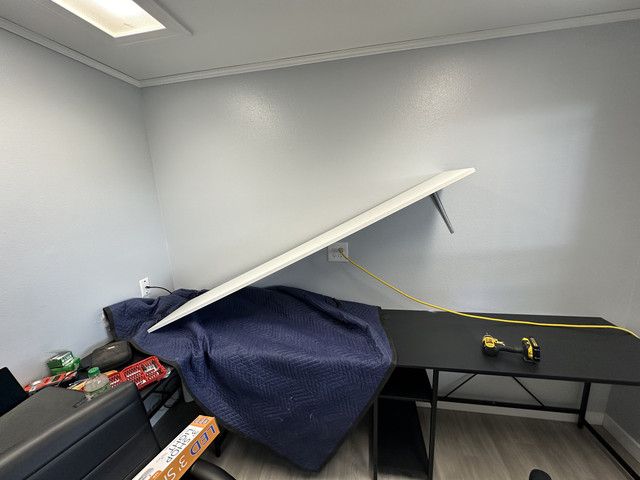

The first cut went smooth. I have to rotate the board to make make a full cut as they are 16" deep shelves with a 10" blade, and I want to keep the finish edge on the top of the shelf. I chose 16" Deep because I ordered a Bench Power Supply and have a 8" PVM for my arcade test monitor and need the depth. My shelf depth went past the window in the office so I'm going to be building a 2 part corner shelf to free up a good 4-1/2 feet of space to enjoy my only window.
This is where it got unwieldy. I ran a stud finder and found plenty of beams behind the drywall (Phew) and marked center before measuring from the wall and transferring to the first bracket on the shelf. I normally tack the shelf up with the first screw as a pivot while I place the level to find the next screw location. When I pivoted, It chewed right through my paint job.. $*%*
Thank god I didn't throw away the rest of the paint. No has to know..
I took a new approach, and built "hydraulic shelf robot buddy" out of a Taito bench and a bin and successfully installed my first bracket. Then my drill died.

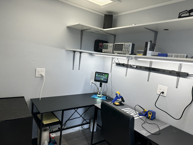

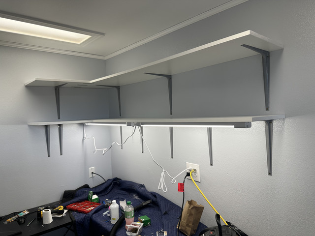

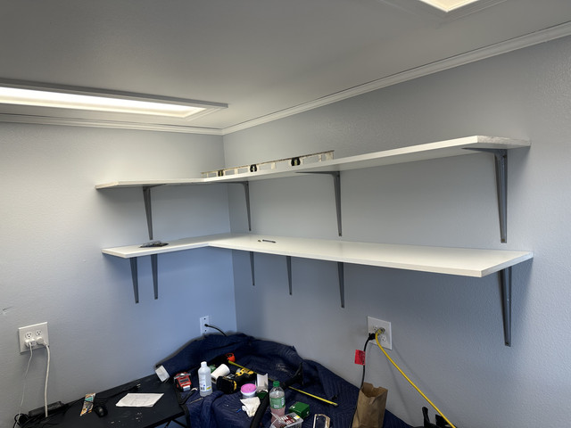

I'd like to share the final touches of construction in the rework office before we head into the weekend.

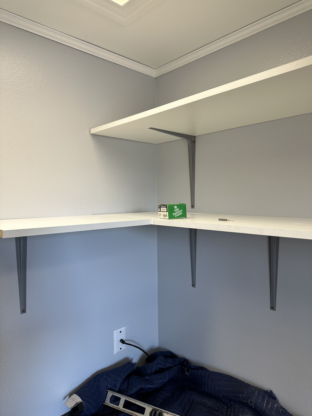

After leveling the first shelf. The next shelf went up easy. The bottom shelf has more brackets and has taller storage for heavier equipment.
I wanted to continue the shelf around the corner and I ended up keeping a good 4-1/2 ft away from my office window. I'm digging the flow and the access to the window.
I used 3 and 4" Steel Mending plates to secure the corner shelves to the rest of them. They are perfectly level and have no gap in them. Very clean lines to me. I'm a mending plate fan now.
The 16" deep shelving really took out some of my overhead lighting. A pair of 3' LED shop fixtures nearly covered the entire length of the shelves. A few tedious measurements to mount them later and we have a crazy bright work area. Each speck of dust glows likes it under a blacklight.
We also have a ton of cords to manage. More on that later

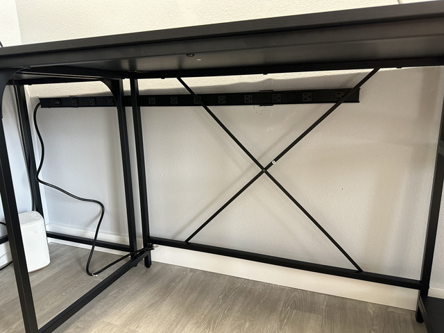

Next up I wanted access to outlets for my hot power station. I don't trust myself with soldering equipment, heat guns, hot tweezers Etc. to check the device is turned off before I leave and don't want to be the "office burnt down" guy so my plan is to install a 12 outlet anchored bar and make sure everything is unplugged before I leave. But I ran into a problem.
I plan on mounting my monitor to free up my deskspace and didn't want to impede the power strip. But the power strip was in front of the shelf brackets which I decided to solve by cutting Mounting spacers behind the install brackets.
I bought another one for my under desk power needs and mounted it as well
Let's tidy up some wires. I got conduit staples and zip ties to remove the slack from the LED lights and hopefully route the strip power cleanly to the outlet.
The LED wire cleanup went well and I was able to tuck anything visible behind the fixture and then daisy chain the lights together. Now all I see is one 3" cord going to the strip. the staples weren't big enough to handle the power strip though. Ill fix that later.
The construction part of the rework office is all done! Enjoy your weekend folks.

Here's an update folks.
It started with a porch gift of Siglent.
I've always wanted both of these so I decided to invest in my room.
Brand new Siglent SPD3303-E 3 channel Bench PSU & Matching SDS1202X-E 200 MHZ Phosphor Oscilloscope
I am a sucker for Hakko aesthetics. This purchase was a long time coming. The C1100 Stand for my FR-301 Desoldering gun. If you haven't hydrated the sponge in one of these for the time. It gives you ASMR goosebumps..

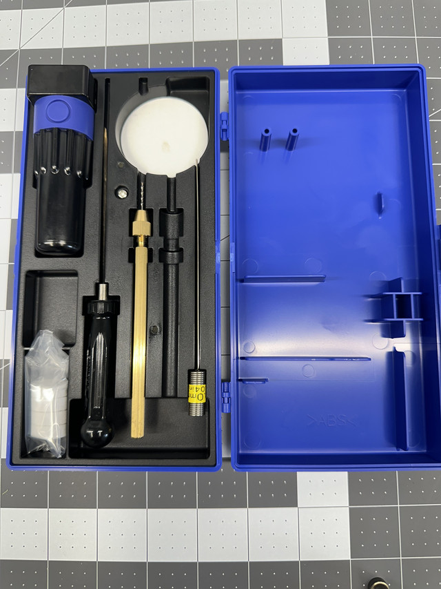

I bought the matching FR-301 care kit mostly for the hand drill bit to clean the nozzle but also to not store that giant Grey handled case for the gun as I no longer need it with the stand.

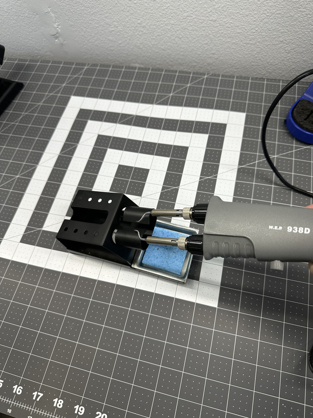

This one was bit on the inexpensive side and I can't believe I haven't heard of these before. The WEP 938D Soldering tweezers. These have two soldering irons in one and lift off SMD caps almost instantly. No wobbling and doing both sides while you worry you're tugging on the pad too hard. Just pinch and lift
This is going to help me identify screw size and use them on my Candy cab repairs when needed. An M thread screw and nut kit

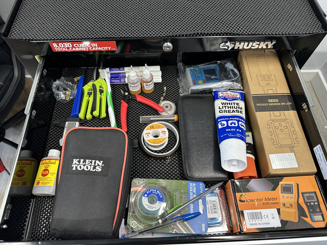

I knew I would need a rolling tool chest for my monitor and stuffed it full of additional soldering and wire equipment along with standard tools and bits. This 650lb rolling tool chest only costed $150 at Home Depot. My local hardware stores were asking $600 for their brand. I have to build a top plank for it to handle my 33" arcade monitors for my Domy Theatre restore.
This small cart is the perfect size for moving CRT in and out of the office

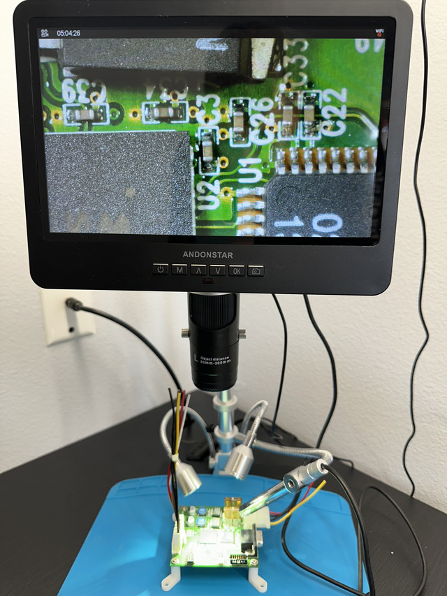

Last but not least is this beautiful Andonstar AD249S-M Soldering Microscope. I bought it like new barely used from Australia for $110 on a New Listing! Comps were $250-300 and did not include the clamp on LED halo arm for extra light angles like mine did. I have a Wii ElectronAVE HDMI kit and GDemu Waiting to test its abilities.
A few honorable mentions not pictured: Hot Air rework station, ESR reader, M-700 multimeter, Tackleboxes of heat shrink and wire connectors, Tap and Die set, Dremel kit ETC.
I'm excited to be able to solder with the right equipment in a well lit environment. The anxiety of taking on these arcade and retro projects immediately lifted off of my conscious.

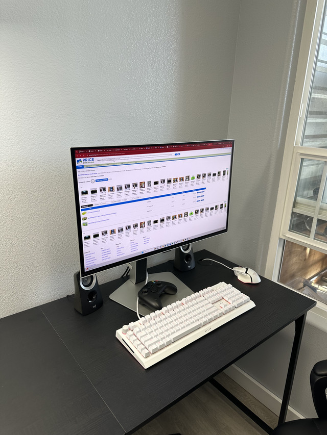

Next up: I have to get rid of this desktop setup and turn it into a mounted monitor and slide out keyboard to free up the work surface. I plan on getting another Fiskars cut pad and making a disassembly area. The key features of this desktop PC setup are an RTX 4070 and a 27" G6 OLED VRR monitor.

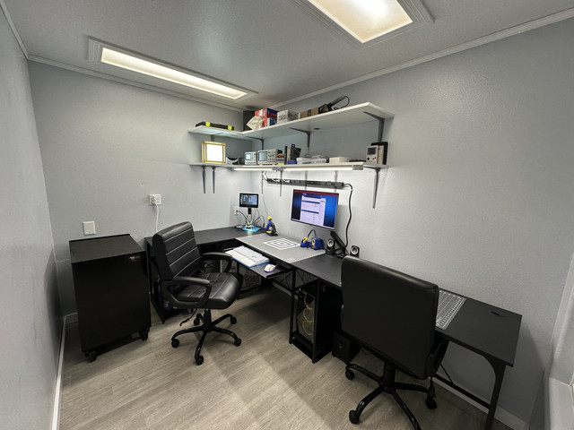

I'm getting close here. This should be the last upgrades to my rework office and relax loft.

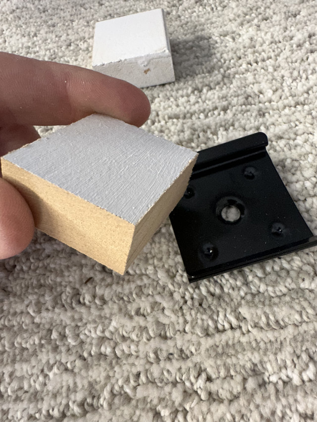

In the office. It was time to make a custom keyboard slide out to free up more desk space for my disassembly area.
I used the left over desk panel that went unused from my custom desk set and cut with a Skilsawl to my preferred width (28" x 10.5") to fit my the keyboard and mouse. I left room for a drink and extra wrist angles if needed.
The keyboard rail kit worked like it should and came with lots of hardware. It feels very sturdy and allows me to use the same materials as the desktop. Bonus!

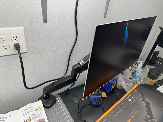

I went with a J5 Articulating arm for the Samsung G6 OLED. I installed it so I could switch the monitor back and forth between by disassembly and rework station so I could follow online guides and videos without having slide around my chair every step. It's supposed to support full TATE mode but I must have overtightened something because I couldn't figure it out.
Overall I'm very pleased with the extra room and ergonomics of both of these. I saved the other portion of desk so I can make a matching slide out for the disassembly area.

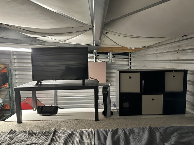

Now a couple finishing touches on the loft tiny living room. I needed power so I could get rid of that awful extension cord plugged into my office. I tapped into the junction and ran 25' of 12-2 wire under the carpet perimeter and installed a quad outlet where the remaining melamine shelf was to be installed.
There are no pics of the shelf install but it went smoothly and very similar to the ones installed in the office.
We have dedicated power now

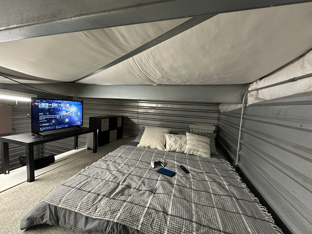

I bought a cheap table and cube organizer and installed an TV stand and place to set down controllers and games in the loft. These were bolted down to the shelf with L brackets in case a drunk guy leaned too far forward.
The queen size convertible futon was treated with a bed set, extra pillows, and throw just for my fancy cat naps. I got this big basket for storing the sheets for when I went back to couch mode.
I hope you enjoyed my office and tiny living room addition. I won't be posting in this thread much more as I am back to working on my candy in a productive environment! Cheers!
