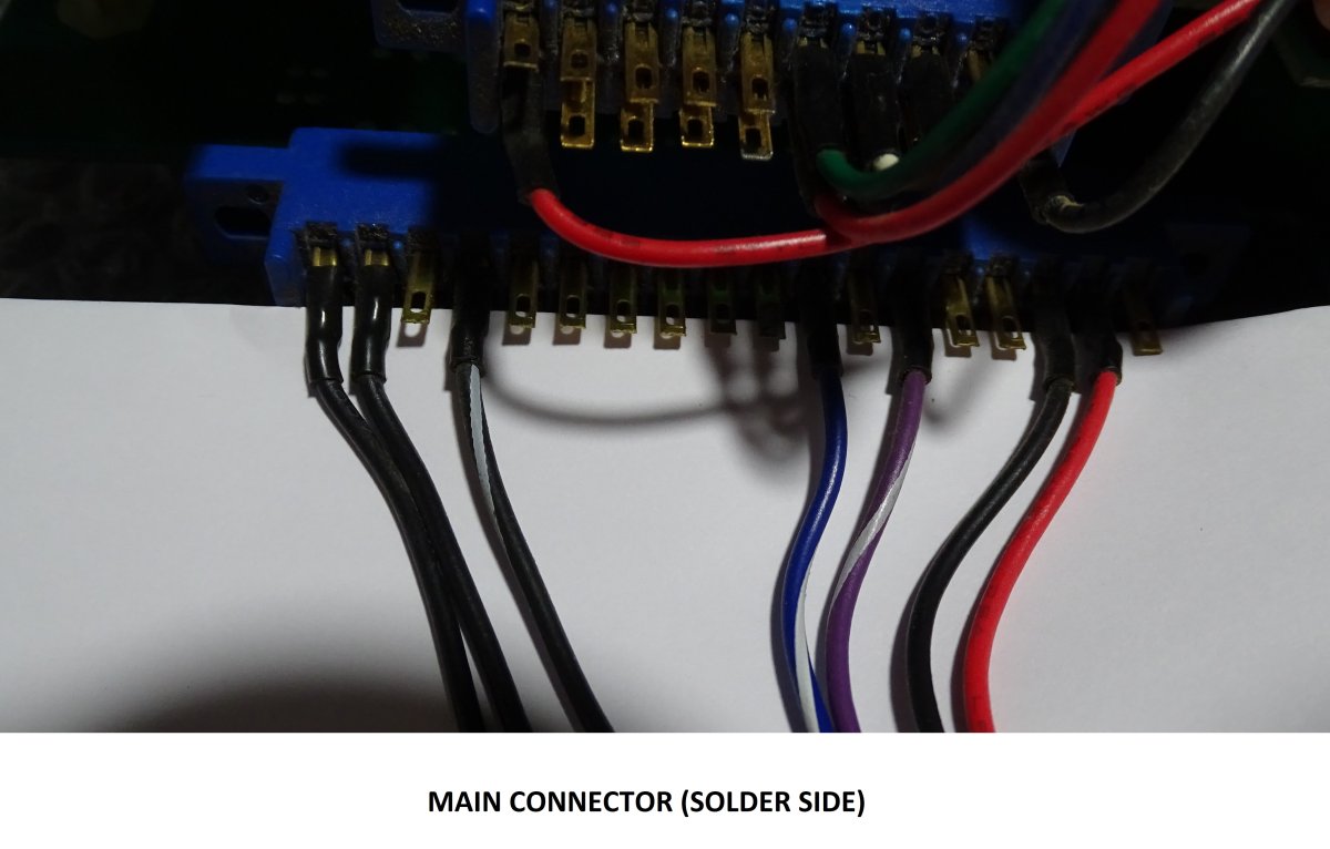

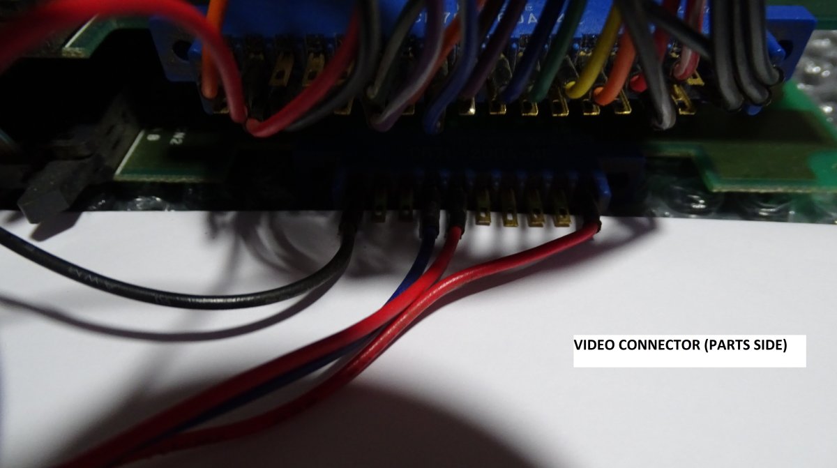

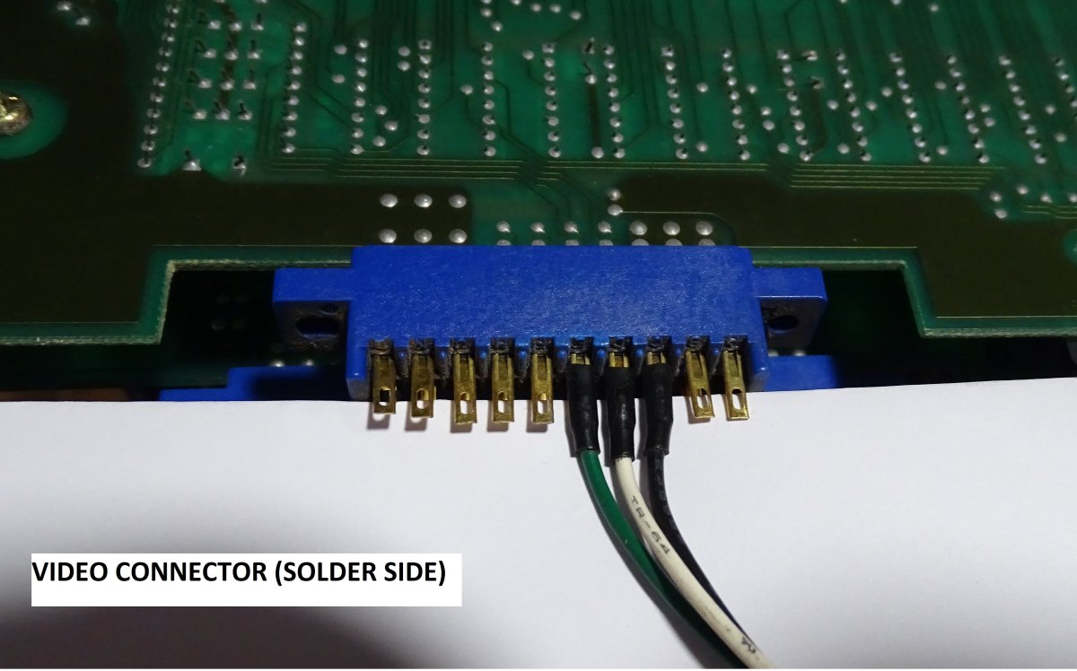

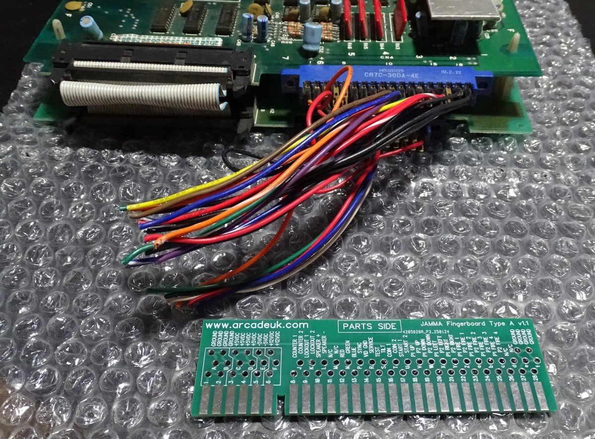

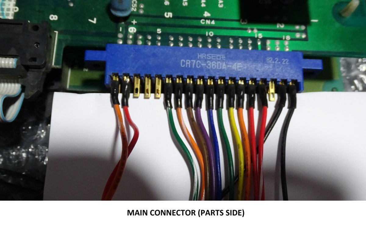

I got a Bump'n Jump arcade PCB with the wiring:
I would like to make myself the JAMMA adapter but I don't see clearly how to do it...
Here you have the wiring pictures:

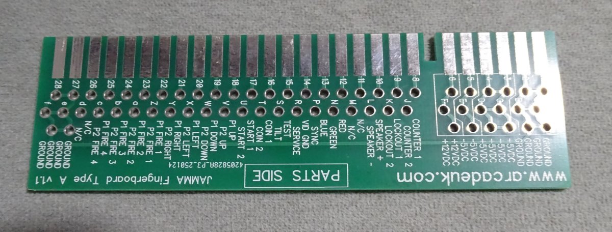

the JAMMA finger board:

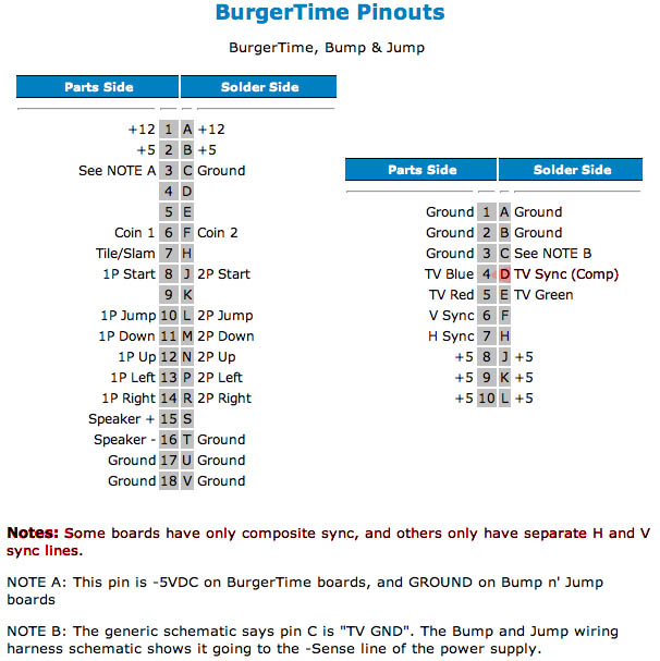

and the pinout shown:
There is some missing wires so I don't understand how to do it by mysself.
Could someone help me, please?
